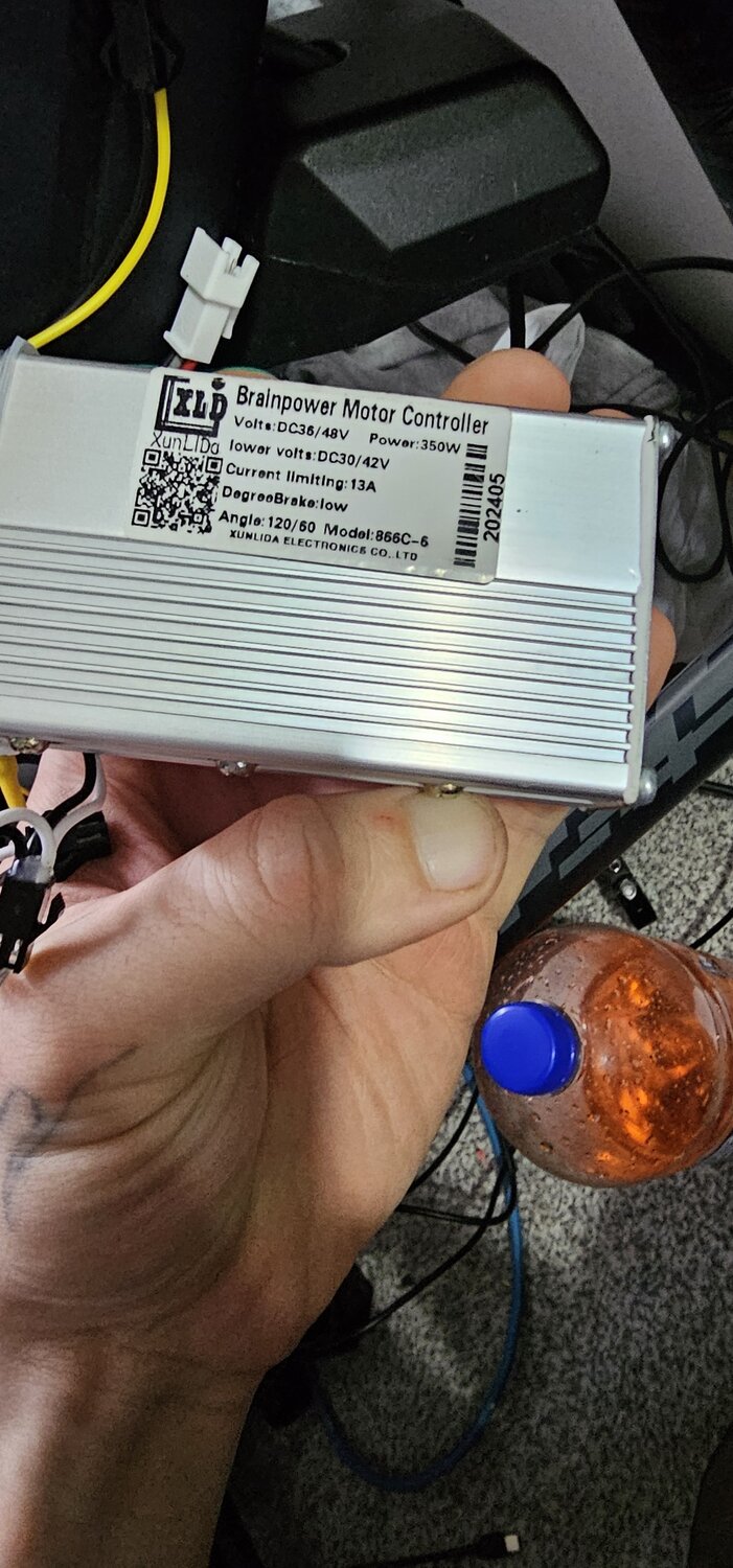

I have installed a new brainpower motor and throttle to my e mountain bike. Everything is working as it should with one problem. The battery is cutting out. No matter if I use full throttle or in bursts or even slightly pressed the battery will cut off and been running for around 5 seconds. I have messed around with the settings based of other forms but still no joy.

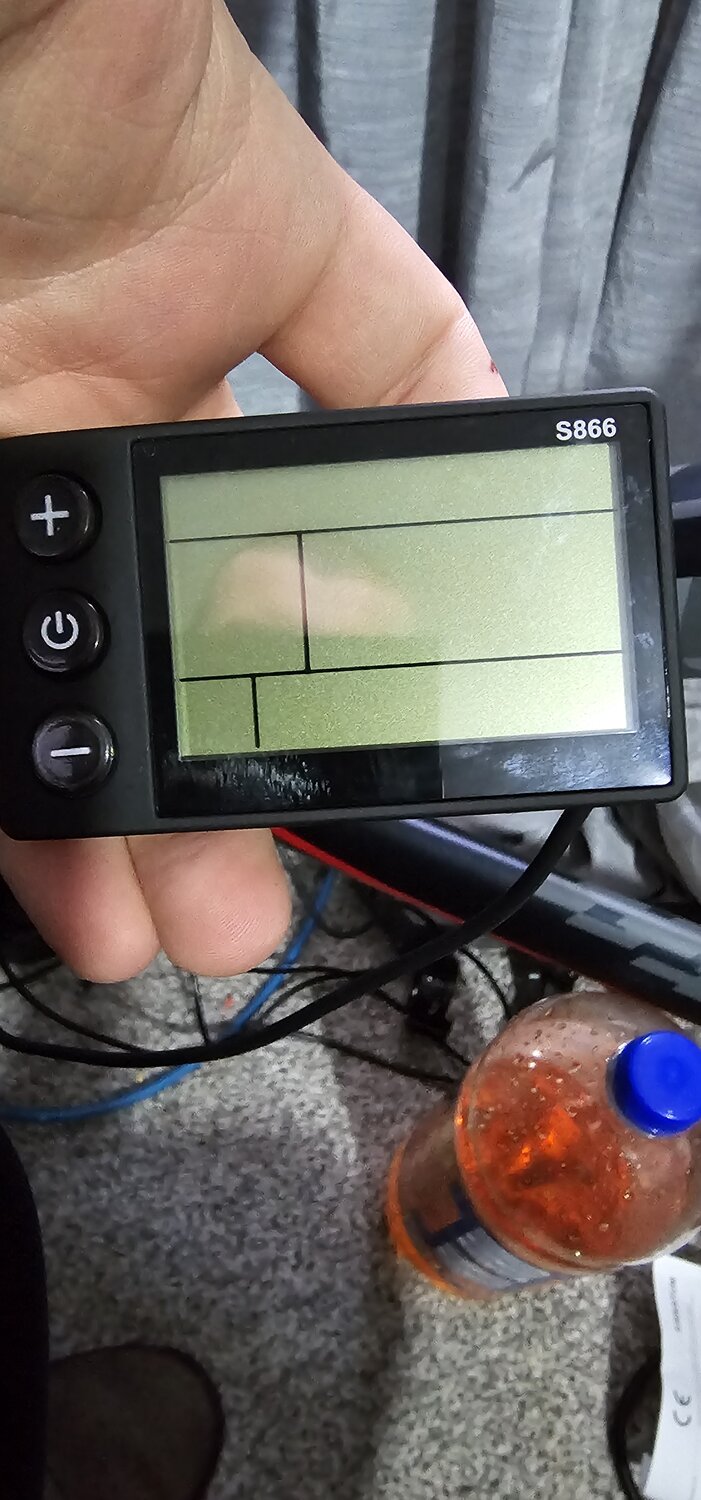

Does the S866 display have a voltage setting? I think it it does., and is it set for 36 volts? It may be powering up expecting a 48V battery, and your fully charged 36V battery is around 41-42 volts, which would cause a shut-off.

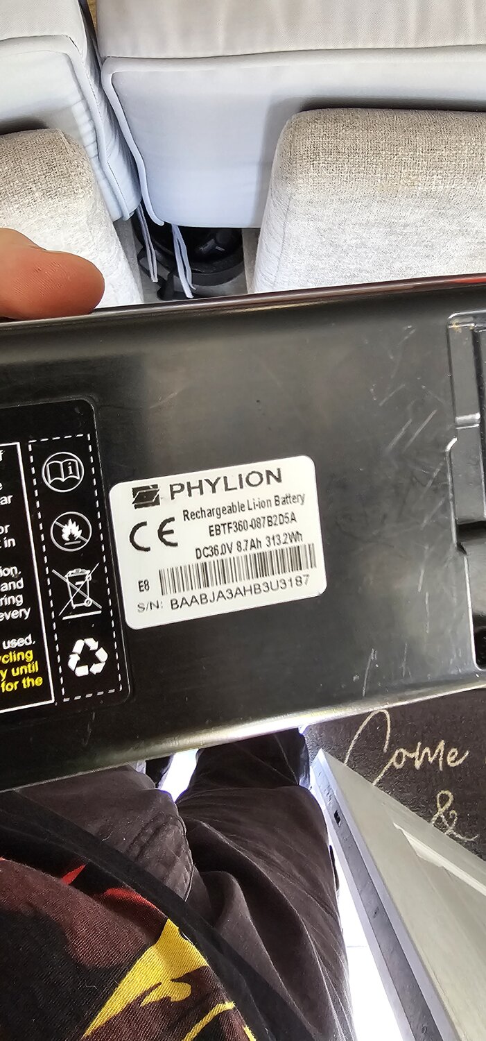

Yes it does have this setting, I have set it to 36v. After running more tests I believe the problem is the battery itself, it could be the battery just isn't strong enough and the controller is pulling to much power from the battery, triggering the bms. I though changing the voltage, gear and speed settings in the parameters would have solved this. However it was just doing the same thing, it would run for around 15 secs then cut off.
The controller is on the modest size. I have a Brainpower unit, but set it aside because it was pretty mild mannered, Probably 13A like yours. The battery is 8.7AH, so it's also small. Should still be capable of 10A though. Maybe you can borrow another battery to do a comparison test.
I assume you can lift the wheel, hit throttle, and it spins on w/o cutting out? Did you do the self learning thing on the Brainpower? If it didn't learn the motor connections exactly right, it might be spinning on a false positive phase setting. That's when the motor spins with no load and at low speed, but will run really rough and draw excessive current,

I think a good way to test if the bms is being triggered would be to change the current limit in the display. I’d set it to 8 amps. Then ride the bike. If the bike rides fine, then it could very well be the bms tripping.

You shouldn’t be lowering all settings. You probably may have lowered the voltage setting. Only p14 should be adjusted. Please restore your other settings and try changing the current limit to 8 amps. Then check the function again.

The battery will sag when initial load is applied, but that’s too much sag. As I’ve read, 4 volts sag is acceptable and it the case with my 48v battery. As the battery ages, sag will worsen.
I would agree with slaphappy abut this being a bad battery. Some cells lose ability to pass high currents, and when they try, the cell voltages sag and trip the low voltage alarm circuits.
It might only be one cell group out of the ten cell groups in a 36V battery, but it still shuts off the battery.
I believe this is the case. I bought another controller with a lower voltage rating to see if this was the problem. How ever the results were the same. I then did a multimeter reading direct into the battery it's self. One pin was reading 35v and the other 41v so my only option left is change the battery.
