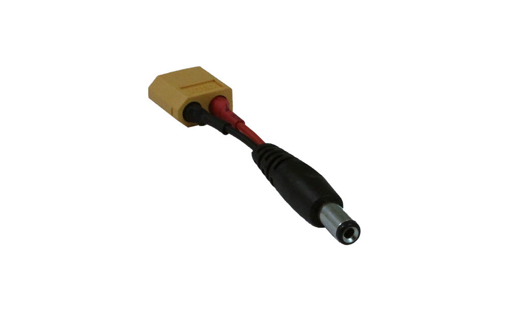

What he said :D Forget about 4a charging. Go three. Do that 185w unit described in the article above, put an xt60 plug on it and then on top of that one of these (I bought a couple myself and paid the 4.99 they ask for them):
If you change your battery down the road or get a different bike, you just change adapter plugs.
