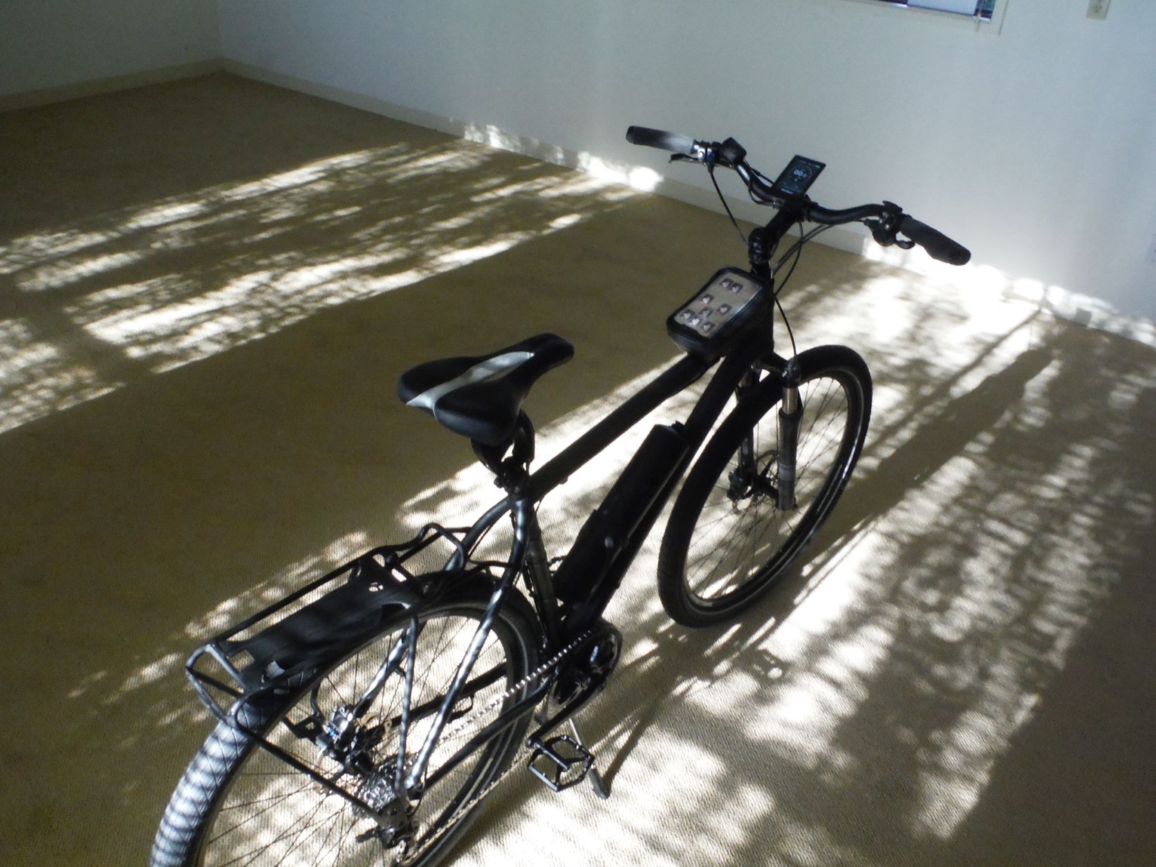

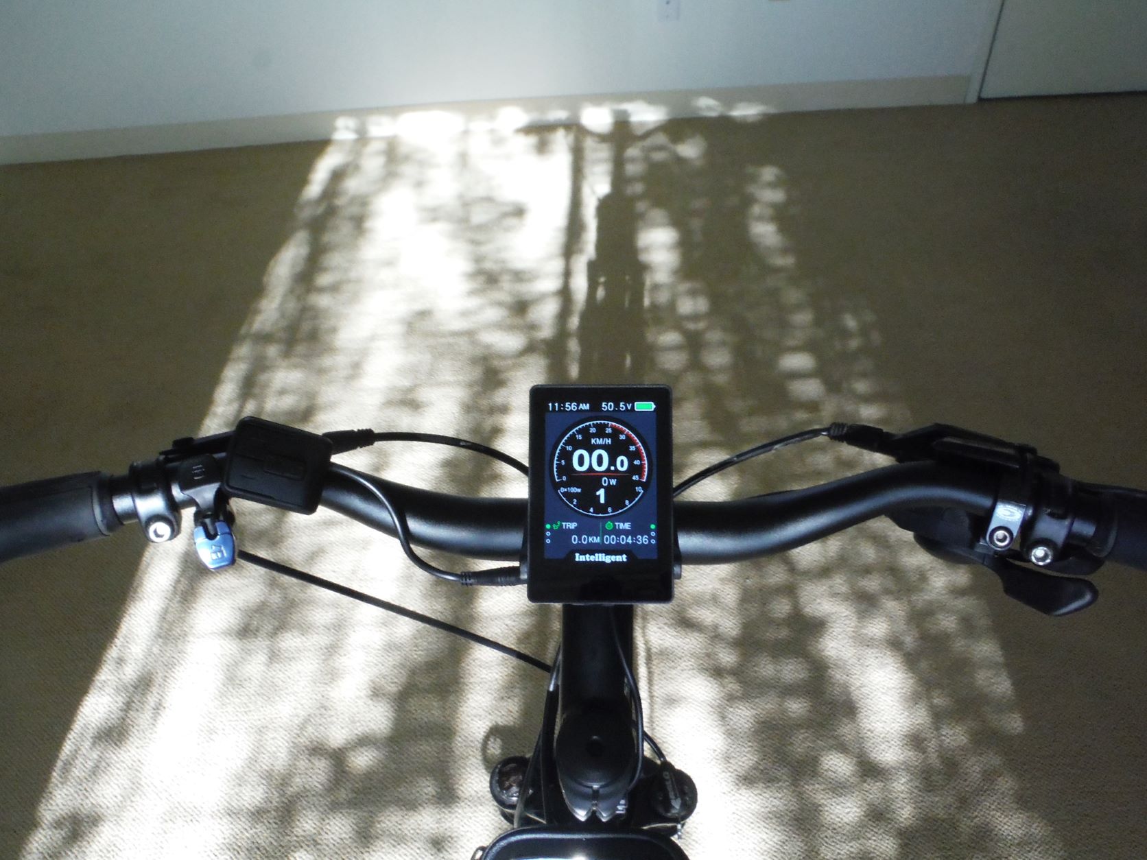

I am in California. I work on eBikes every day and do conversions. If you have questions, ask away. Here is a photo of one of my Bafang builds.
