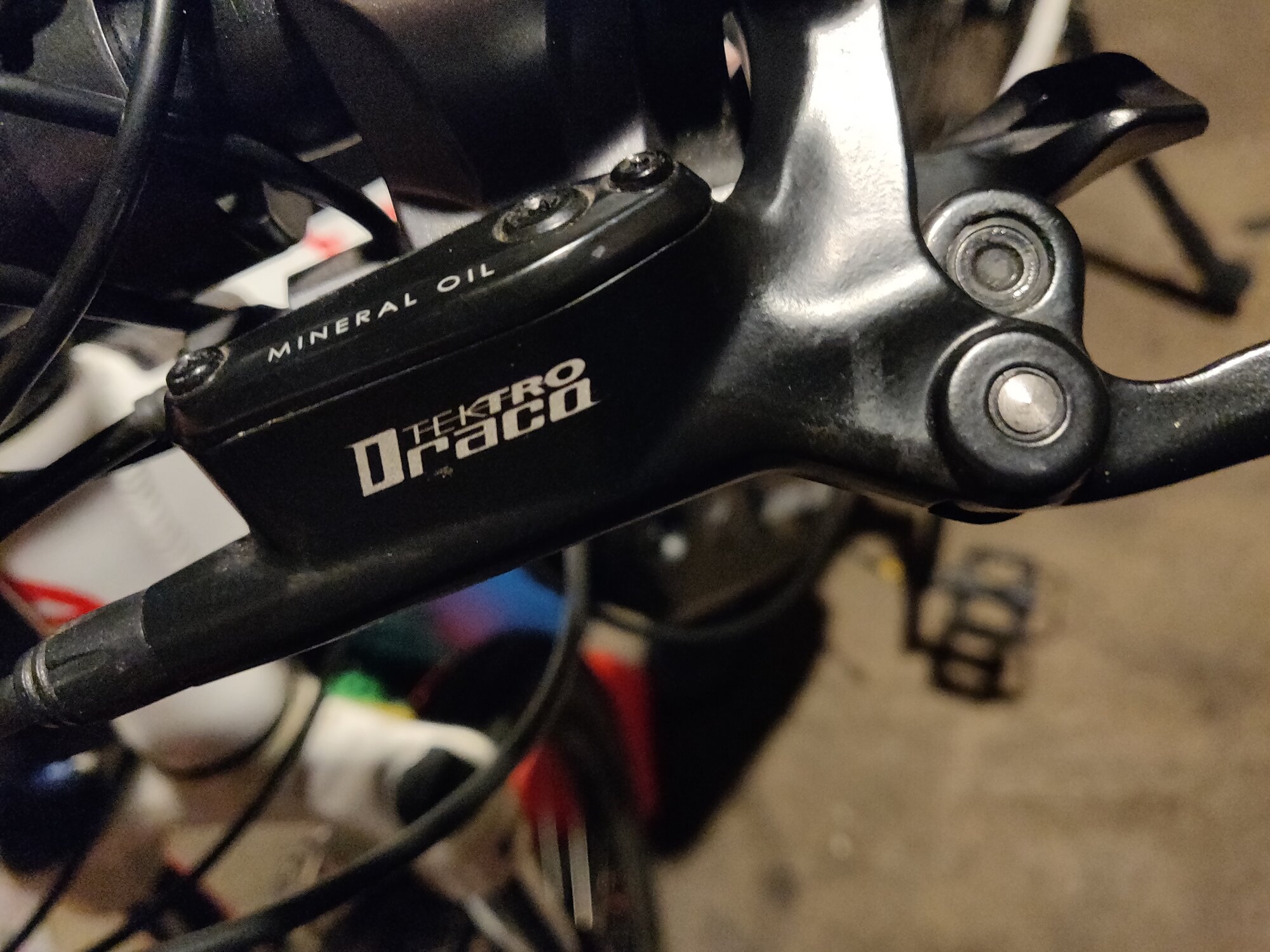

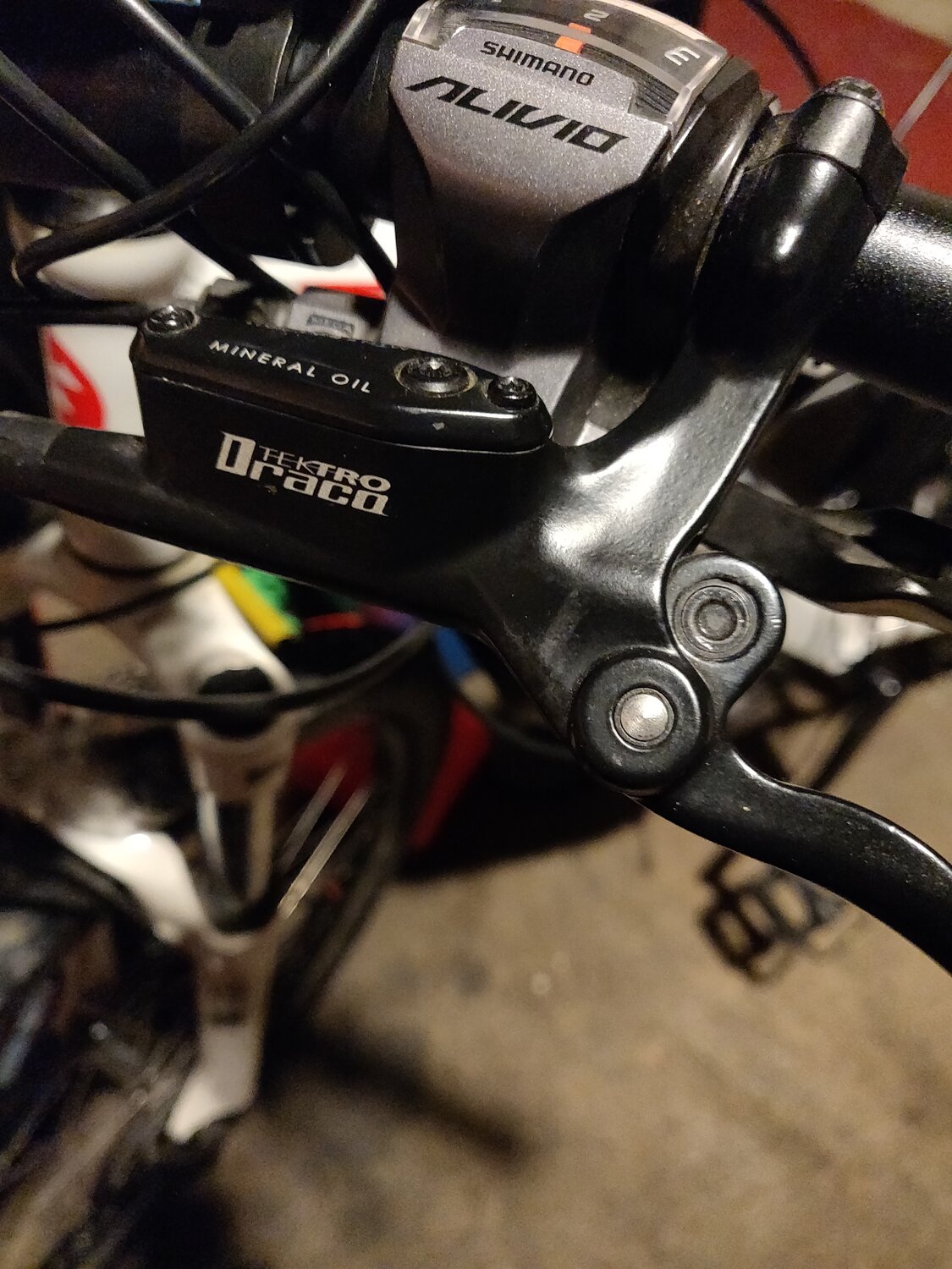

Wow, what a good recommendation. I was not even using the brake handles that came in the kit, because I have a nice set of hydraulic disc brakes that were already on the bike. The two 3 pin red Julet were connected to my front and rear lights. When I hooked them up to the two brake handles from the kit, it came alive. Walk mode and throttle now working(too late to try out pedal assist). So, I guess this means I will have to use the new brake handles and give up the hydraulic oil filled handles? In first picture, kit handle is in my hand.

You can buy cables with magnetic sensors. You glue (epoxy) the cable to your handle and glue the magnet somewhere. I've done that. It's not as bad as it sounds because I have them underneath the lever where no one can see them. Or maybe you can pull the switch out of the kit levers, but they probably won't be magnetic and use contact switches. Personally, I rely on the brake cutoffs on my ebikes for engine control.
I used a "green button" and it's in a position where I just rotate my thumb to stop motor power.
