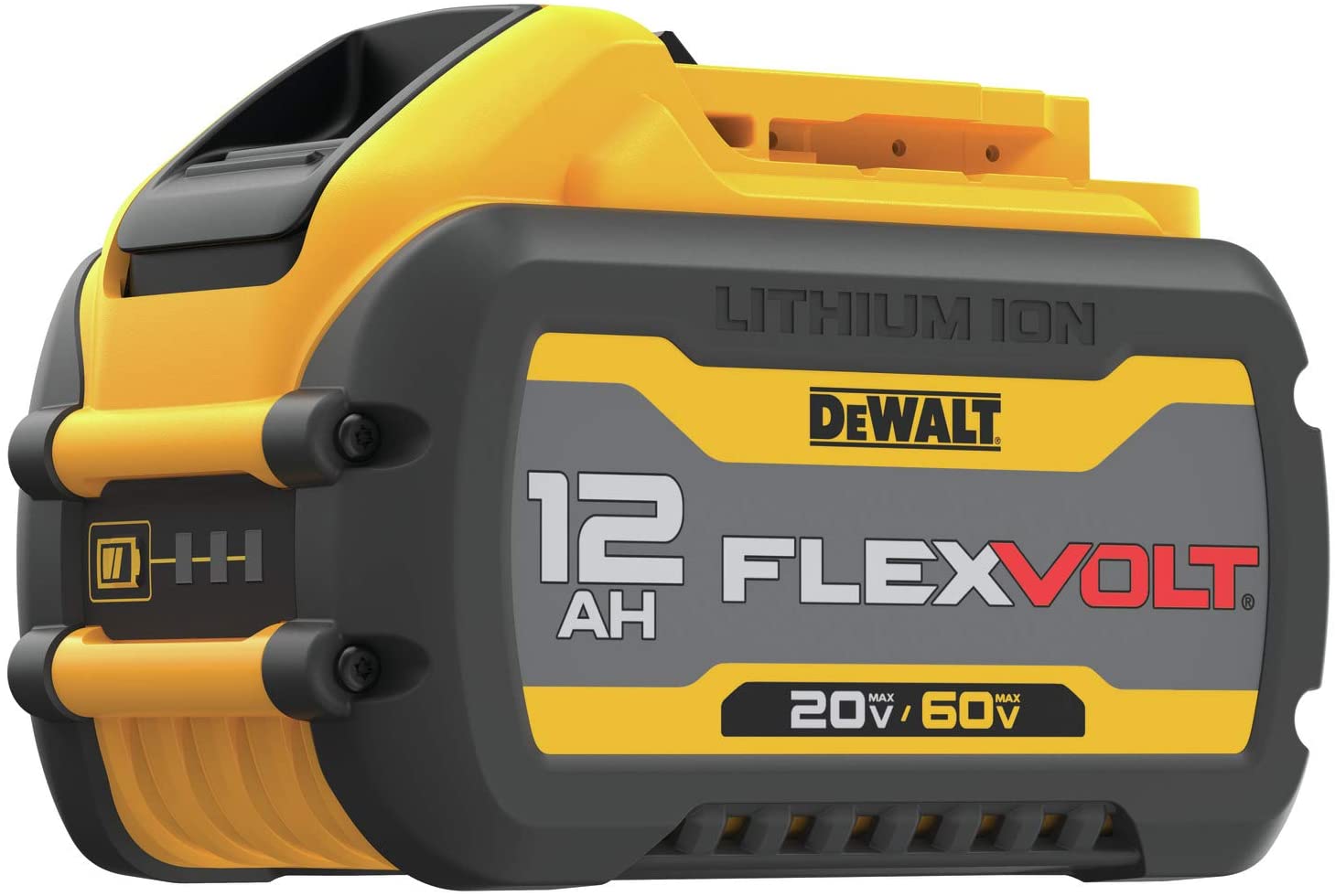

I've been toying around with one of these DeWalt 60V batteries to use as an emergency ebike power source.
It's rated at 60V but I believe the cell configuration is the same as a 52V battery. It has a 12 AH rating (for 20V tools) which in theory would give me around 10 - 12 extra miles on my 52 V bike. At 3 pounds, it can easily be carried in a trunk bag or pannier. It's a bit pricey at $200 but still much cheaper than an OEM battery. In my case, I already have several laying around which I use for power tools.
The trick is constructing a connector / adapter cable to mate up with the connector on the bike. So far, I haven't had the time to work on it.

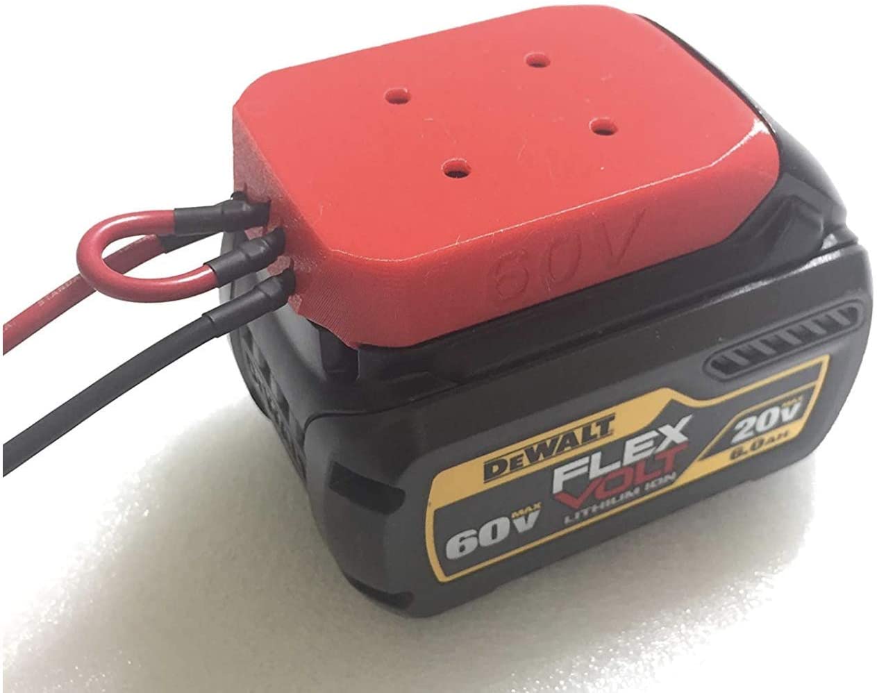

This post go me thinking again about my backup battery idea. It turns out someone is marketing an adapter for the above DeWalt 20/60 Flexvolt battery:
Since I already have the battery, I ordered the adapter and wired it to my 52V Pedego Interceptor. It works well, giving me about a third the capacity of the OEM Pedego battery. On an average ride, this equates to around 18 extra miles. I tapped into the main battery connector inside the controller housing and ran the leads back to my rear rack bag.

No, I'm using the DeWalt battery to power the bike with the OEM battery removed.
