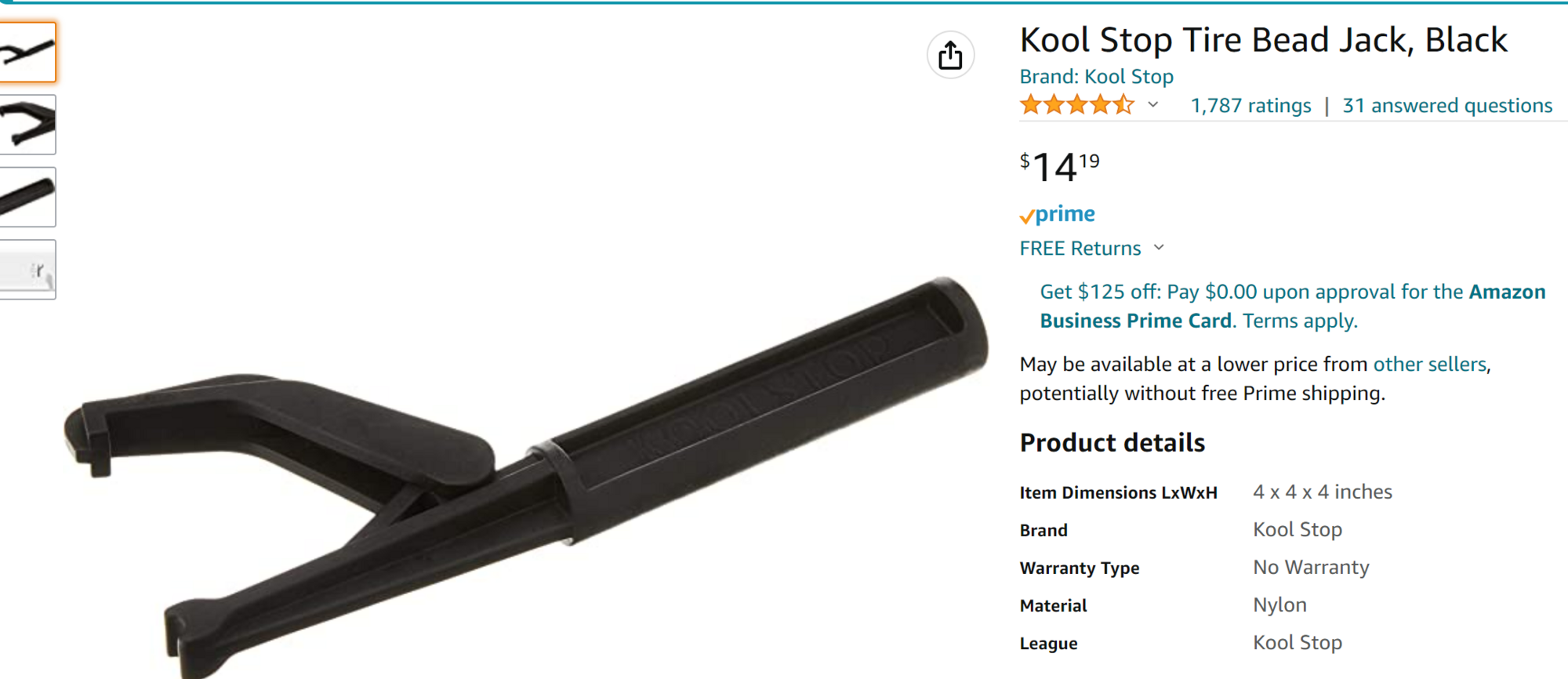

I have them on my regular road bike. Great tubeless, can be very hard to mount. I have been running tubeless for 14 years and these were by far the hardest to get on the rims. I found this tool, and it made the mounting fairly routine. Great for any tire mounting as there is no part of the tool that actually goes inside the bead, so you won't pinch your tube on regular (non-tubeless) tires.

That tool looks like it would save the thumbs. Do you have the gp5000 TR on your wheels now? Continental claims the newer TR is much easier to instal than the 5000 TL. I’m looking for reviews of the TR specifically.

Mine are tl's.

I have this tool and used it to mount my Conti's (tubeless).

Ordered one. Thank you!

Thanks for the post. Ordered this and found it makes short work of Conti Gatorskins and Spec Armadillo tire that were somewhat difficult to mount on the rims I have. Works much easier than the plier type levers I've used before. I've also tried the Tire Glyder. It's nice and compact but does not fit thicker rims. The Crank Brothers Speedier lever is what I use to remove tires and it has worked well. I'll keep the Tire Jack and a Speedier lever in my bag to deal with flats-hopefully less often as I convert to tubeless.

The tire rim jack is always on my bike bag. Glad you found it as useful as I did.
