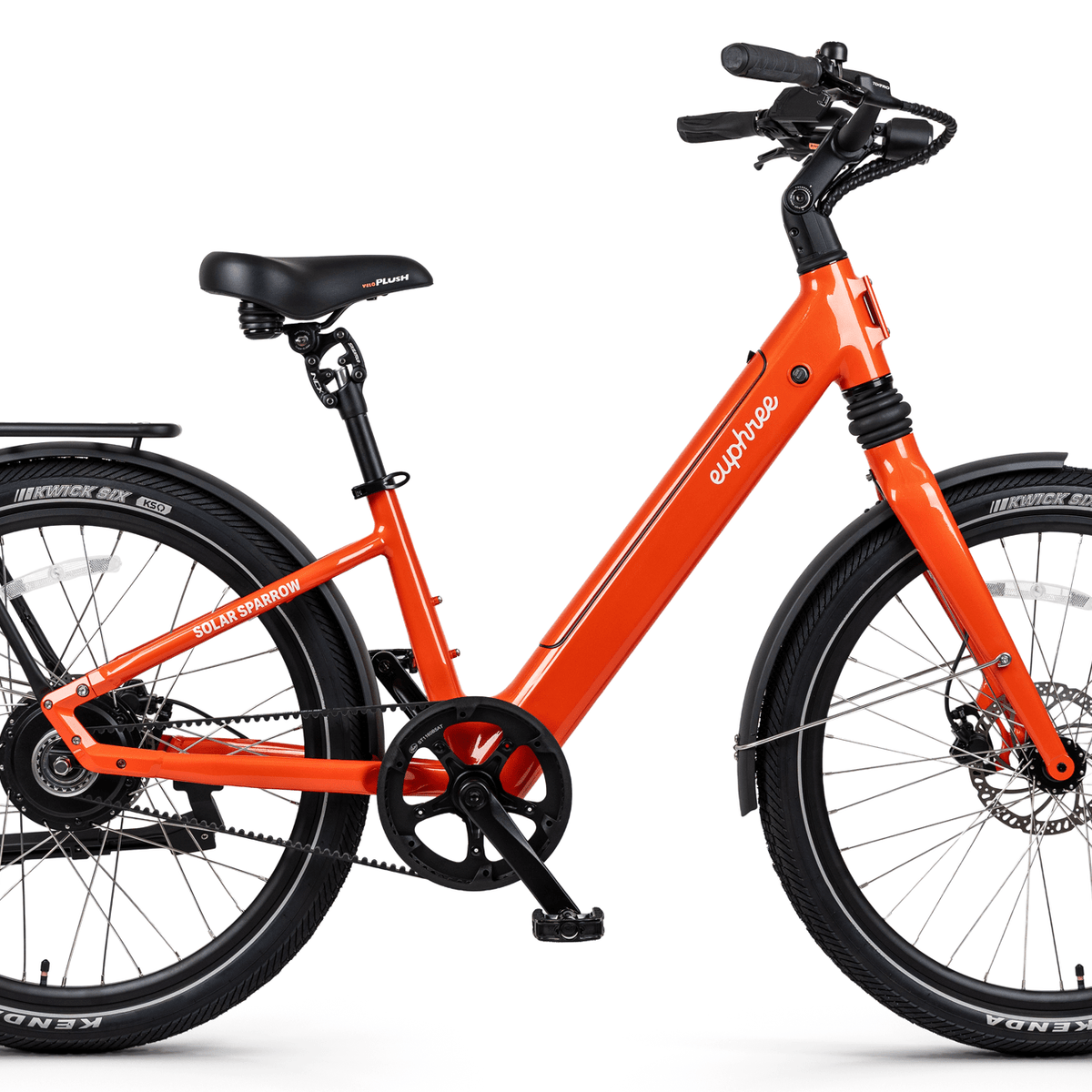

I have an interest in a Euphree Solar Sparrow as my next ride, it's a simple but elegant and thoughtfully put together ebike. Single speed, Gates belt drive, 500 watt hub drive, class 3, 26" Kenda tires that are 2.5" wide. I have several ebikes now, all 750 watt, and all 8 speeds, with 20" and 27.5" tires. I surely don't need another bike, but the simplicity of this bike has me questioning everything I ride now, and If I really need all this power and gears to just go out and get my daily fitness and enjoyment rides. I'm not a lazy rider who needs a throttle to get places, I pedal 99% of the time wherever I go and enjoy doing it.
Anyone out there living by choice with a single speed ebike? I'd like to hear your opinion on this and if it's something you would enjoy riding.
Here is a link to the bike I have expressed interest in.

On the Euphree's 26" wheels, the 60/20 gearing comes out to a pretty high 78 gear-inches. If a big hill bogs you down to the point that you need to help the hub motor finish the climb, you may well find yourself wishing for a gear well under 40 gear-inches.
My commuter's 500W hub motor gets bogged down like that sometimes. Had to lower its bottom gear to 24 gear-inches to get it over my toughest hills (16-20%) without having to walk.
But you enjoy pedaling. And you're not going to enjoy a gear that low on the flats.
So I'd test both ways: With your usual motor utilization, find the highest gear you can tolerate on your worst hills and the lowest on your flats. Calculate the gear-inches in both tests and compare the results with the Euphree's 78 gear-inches.
If you can count on similar assistance from the Euphree, that should tell you a lot.
