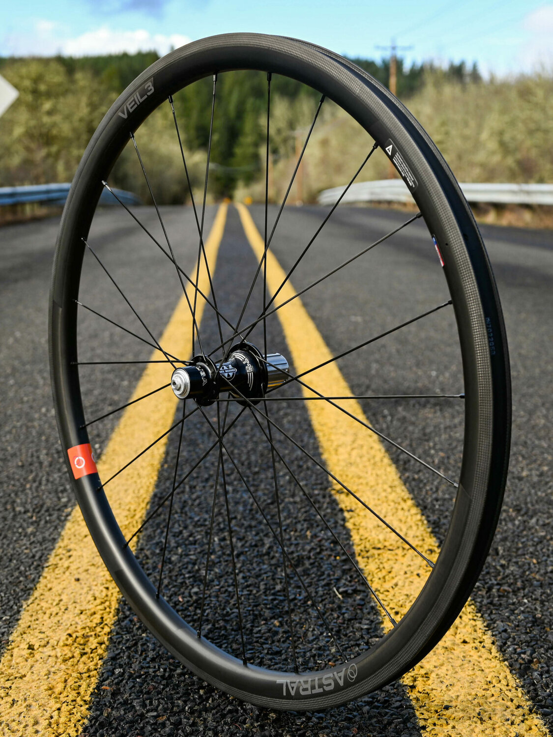

Hey, Anybody going crotchless out there. How do you like it?

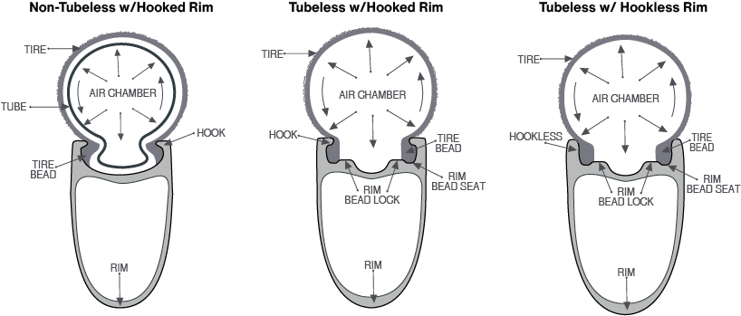

What am I looking at here? Is that what rides on the surface, or is there a tire that fits into it, or.......??
Tubeless only rims do not have a crotch/hook around the rim for a tire bead to seat into. They do not need it. Rim tape is not required and a wheel can be stronger and lighter and cost less than with a crotched rim.
You still can ride with leather if it has a throttle.
Check that video out... it says that not having a hook for tubeless is a misconception. I had never heard that but apparently early tubeless tech did have such a limitation but doesn't any longer. I have rims that are tubeless-compatible that are also hook-beaded. My alloy DT Swiss FR560's come to mind immediately. I am running them tubeless on my Apostate, and tubed on one of my Bullitts. Also my fat Surly MYOBD rims are hooked, alloy and tubeless compatible.
My understanding of the reason hookless rims existed was because carbon fiber rims can't be made with that little edged nub on the inside of the rim wall. But apparently thats outdated thinking. That video above shows hook-bead c/f rims.

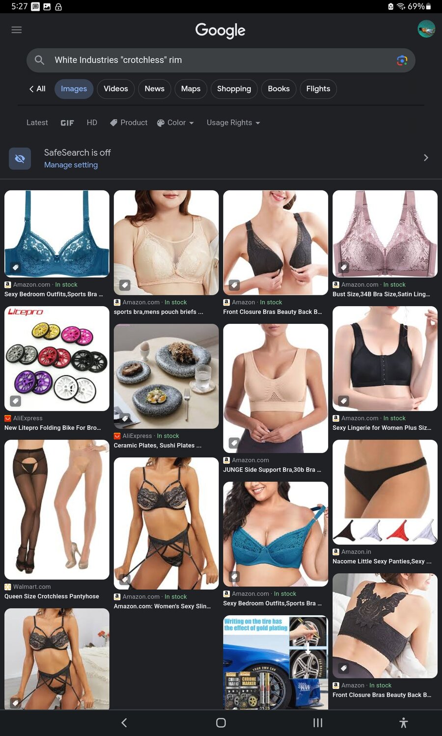

When I Google 'White Industries crotchless rim, images,' this is what I end up with. And yes, they are asymmetric. That is to fit the boost hub and cassette. I read that some are more deviant in their asymmetry than others that are totally straight. A rocky trail can be a rocky horror at the same time.

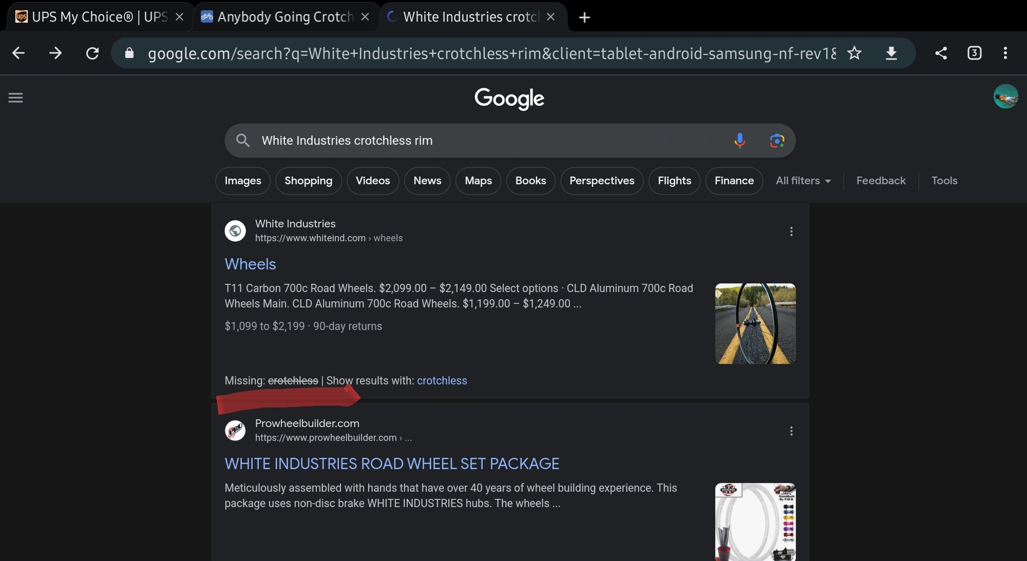

Yes.... But "crotchless" is deleted from the search criteria
When you then click show results with "crotchless"... You're redirected to a Saturday night open_A fest.
