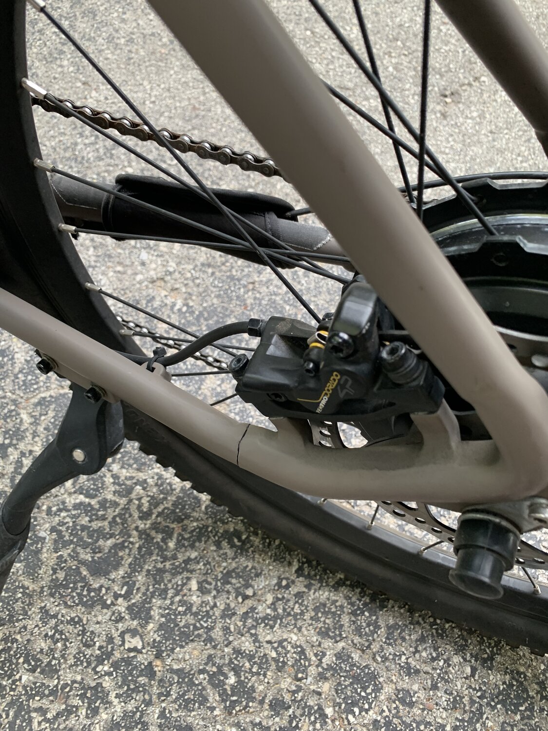

Here is the broken frame. It is on the brake side of the chainstay, broken all through and all round the chainstay tube.
That is a big stress point. Many bikes have a brace there for this reason. The brake will push that part up and the heavy rear motor will push the chainstay down. Fatigue.

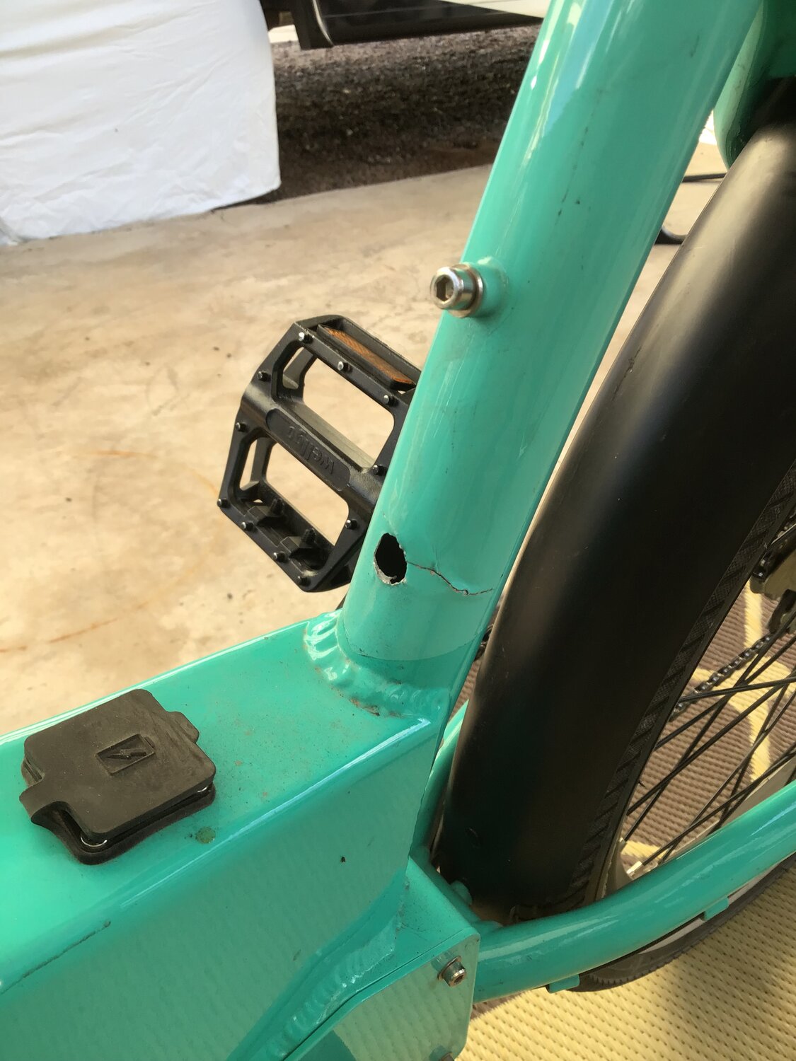

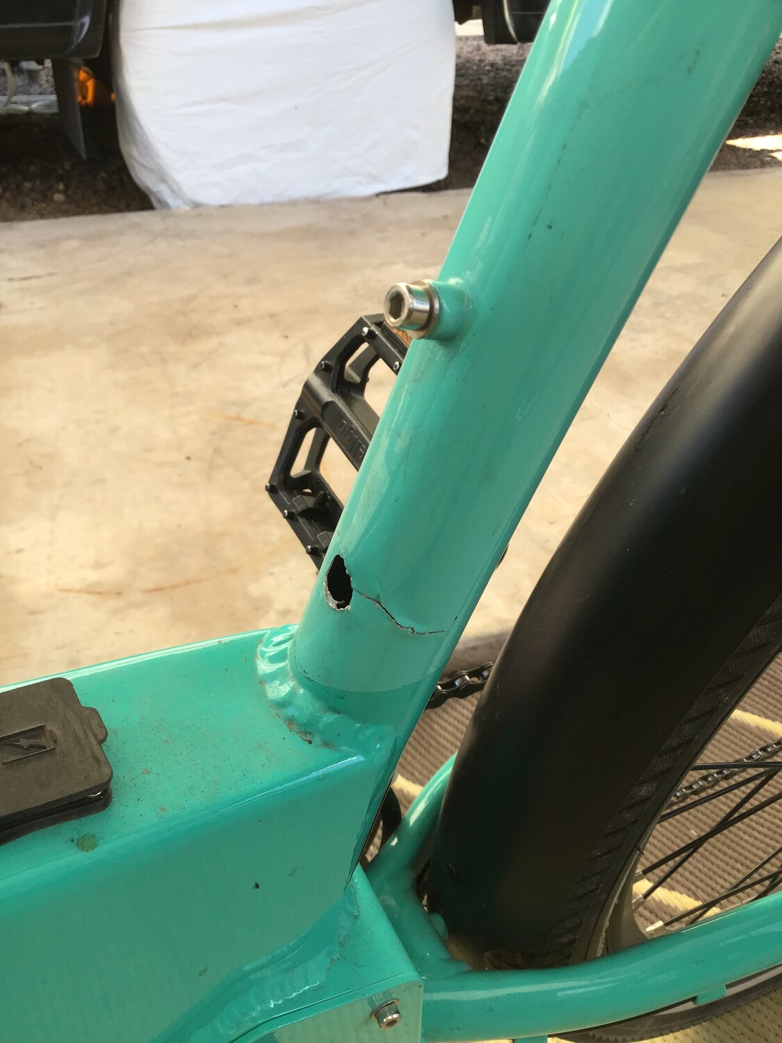

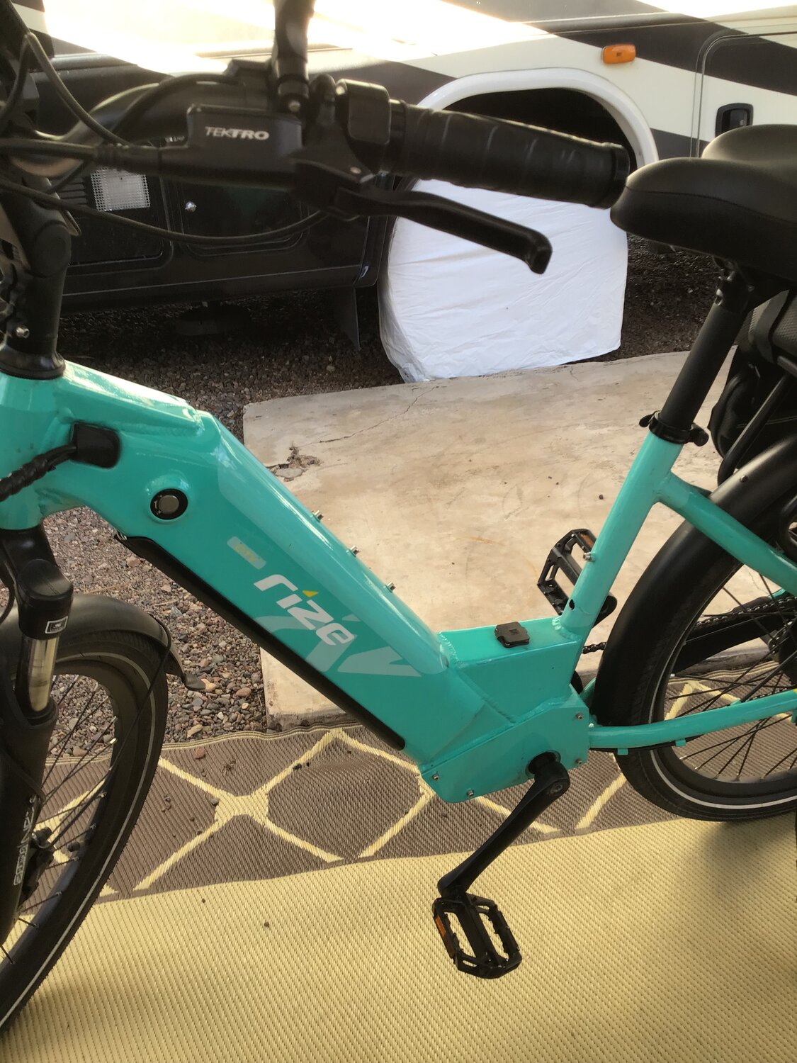

Yep we have 2 Rize City bikes
Rize Canda says no fix need new frame
2 yrs old and we have $2500 worth of nothing
The bike has 800 km
NEVER BUY THIS BRAND
