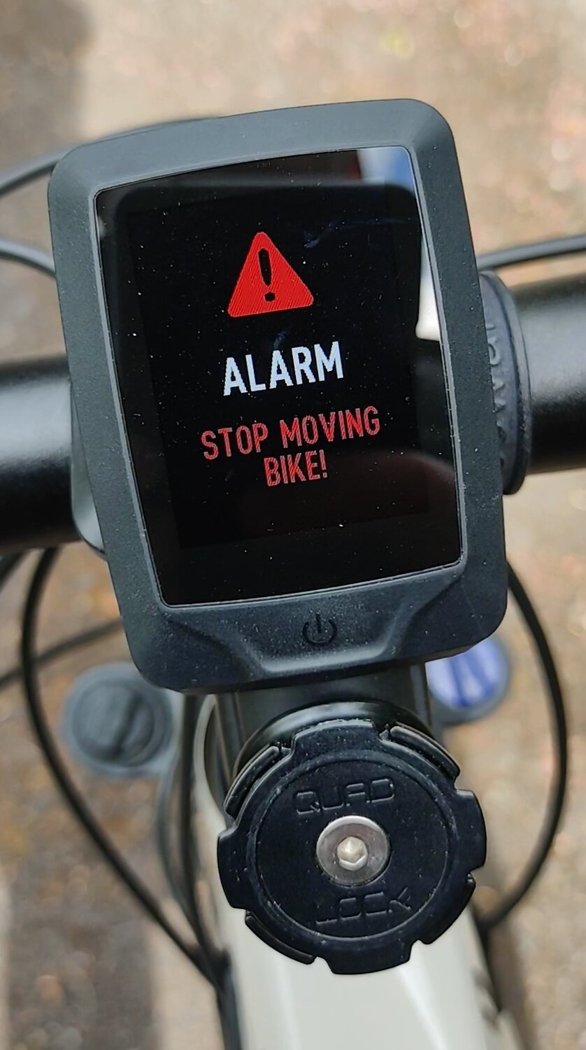

Update: on the back of projectman's update... I've been able to trigger the alarm on my TURBO VADO 4.0 (2022)!!!
As before, I activated the lock and deactivated Bluetooth on my phone so the bike wouldn't know I was nearby (I don't know if this is matters or not)
As before, shaking the bike, or pushing it a metre or so didn't trigger the alarm.
HOWEVER...
I rode the bike (under my own unassisted pedal power) and the alarm sounded after about 100metres / 30 seconds.
I repeated the test, this time just walking the bike and it sounded after 30 seconds of walking.
So it seems linked to movement (poss of wheels) rather than pedalling per se
The alarm sound is a repeated beep, which lasted for 30 seconds and then stopped.
I didnt test extensively after that, but it seems that the alarm will sound again if the bike is moved again (after 10-30 seconds of movement).
So.. alarm does sound... But downside is that thief will already be 30 seconds/100m away before it does... (Would be better if it was triggered by initial movement)

After reading all the comment I did some brief tests.
- The alarm works but only if the bike is moved forward. In my case roughly 50 ft/15 meters. Makes no difference if my phone is close or not. I did not disconnect from Blue Tooth.
- The alarm times out after about 30 seconds. However, if the bike is still moving forward it will trigger again in roughly the same distance, 50 ft.
- It is not possible to shut off the alarm by trying to shut off the bike using the TCD display. As DarrenM showed above, the display shows alarm mode and to stop moving the bike.
- The alarm sound is pretty whimpy. Don't expect any ear-shattering blaring noise.
- The motor stayed off in the lock mode, as expected. However, this bike, even though it is not a lightweight ebike, is fairly easy to pedal unassisted. I was pleasantly surprised. Of course nothing like a carbon fiber road bike but definitely ridable.
The bottom line regarding the audible alarm: Get a butt-kicking lock!!
