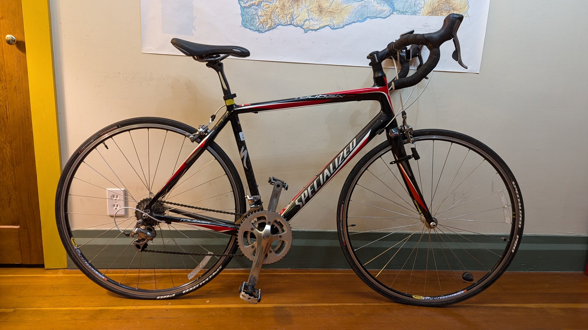

I think if I want to pedal fast that I'll stick with my $100 Roubaix.
Fastest pedal bike I ever rode, though it's geared too high for my right knee. Decent pedals would cost more than the bike, and, as such, she sits an object d'art.
