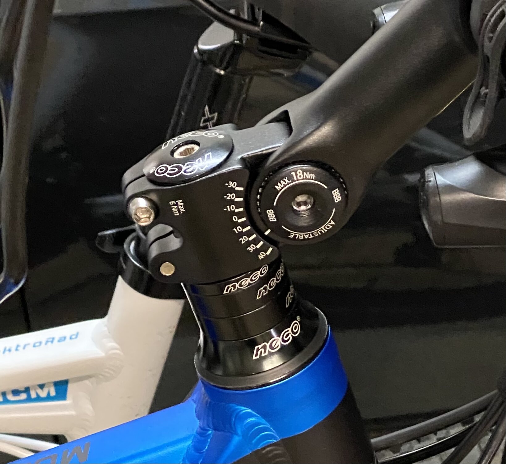

I bought a BBB (BHS-29-BK-130). Fits ok but cables are too tight/short to fully extend it. Still gave me a little more height though....
I bought a BBB (BHS-29-BK-130). Fits ok but cables are too tight/short to fully extend it. Still gave me a little more height though....View attachment 63550
I am also in OZ, I have an Aspen+ and we have the brakes on reverse sides to USA, Front on right, Back on left. I changed the hoses over and you get an extra 50mm of lift. as the brake disc is also on the left.
