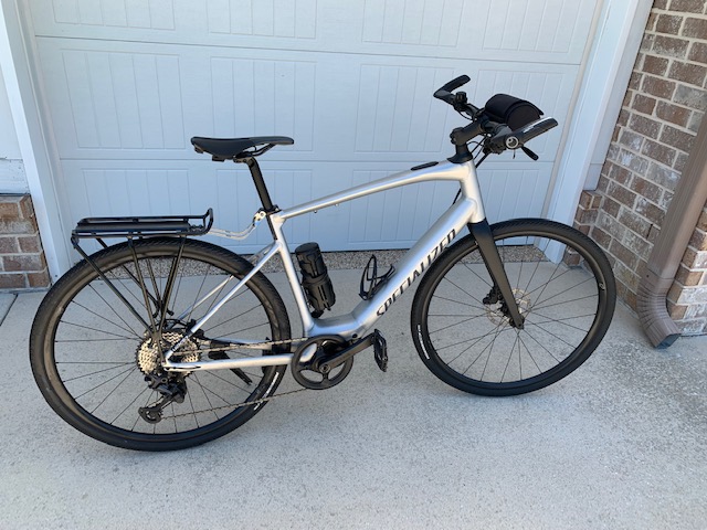

Yesterday I had my LBS add a rear rack for my Vado SL5.0.
Unfortunately this addition is giving me grief because I now find it very difficult to get on/off the bike because I have trouble lifting my leg over the rack (adding a trunk bag at this point would make getting on/off impossible). I had to tilt the bike a good bit to get on/off before adding the rack.
Any suggestions on how to get limber enough to solve my problem?
I am in my early eighties, weight 215 pounds and typically ride 20 miles with about 650 feet of climbing every other day.. I have been riding regularly for about 11 years.
Thanks for any insights....
Unfortunately this addition is giving me grief because I now find it very difficult to get on/off the bike because I have trouble lifting my leg over the rack (adding a trunk bag at this point would make getting on/off impossible). I had to tilt the bike a good bit to get on/off before adding the rack.View attachment 88142
