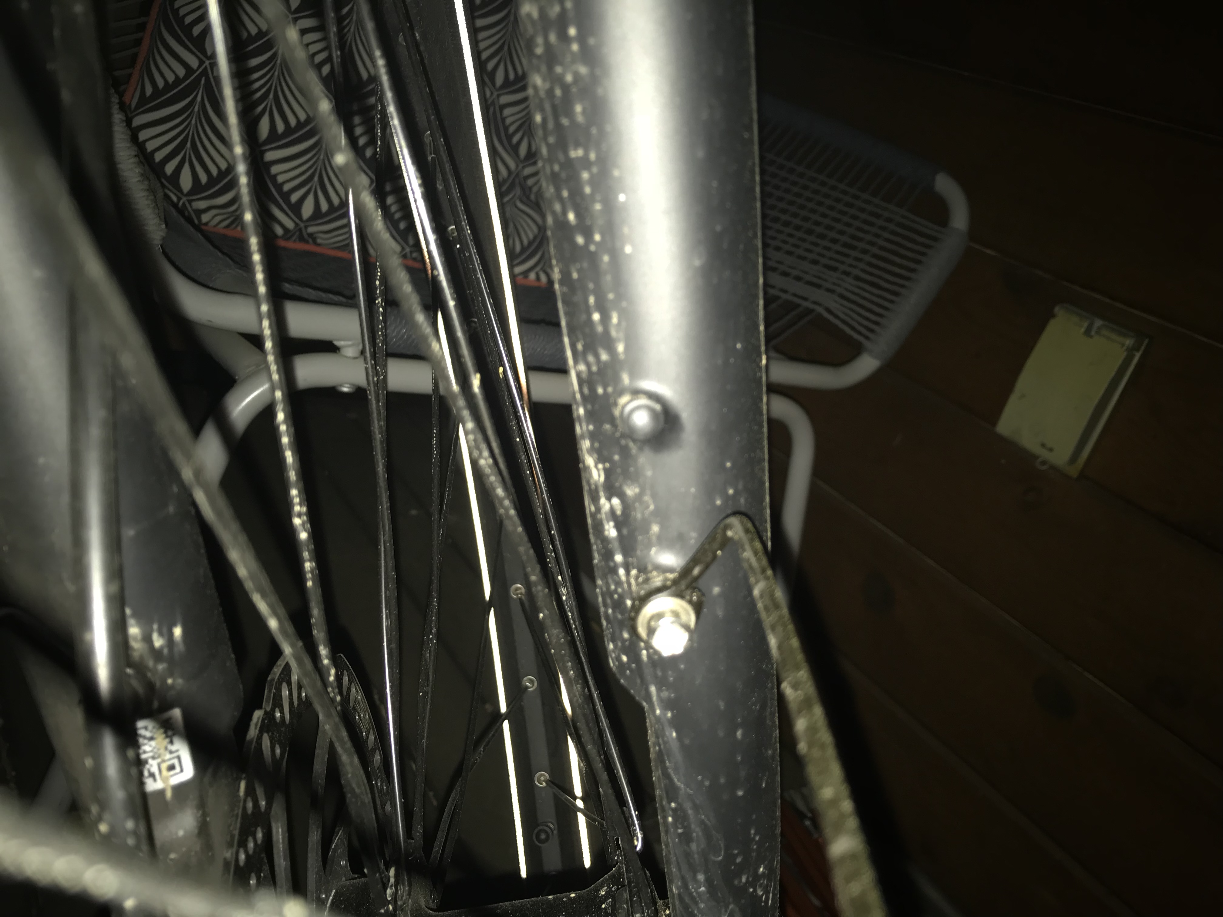

The rattling of the front fenders drove me crazy as well. I picked up a tip from a guy somewhere on YouTube that fixed the problem for me: rotate the fender stays inwards or outwards as much as possible. The “twist” makes them much “stiffer” lengthwise and you have noticeably less side-to-side movement. Here is a picture how it looks on my bike.
I wonder if adding additional fender braces would help. Tora, can you add these to your available parts? I can't find similar fender braces elsewhere.
Great idea! Will give that a try this weekend. Thanks!
