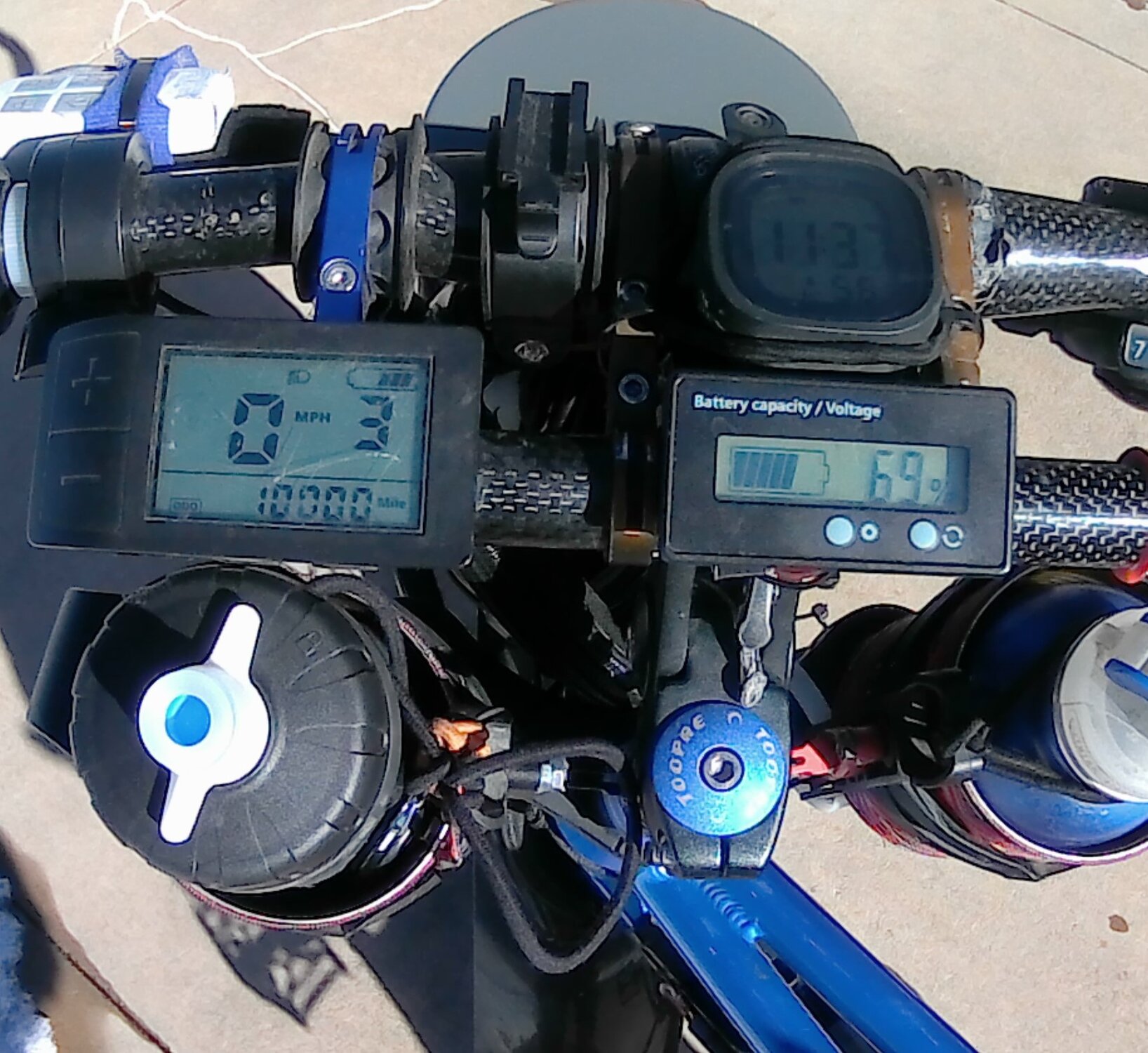

After assembling this ebike and then going for a ride, I quickly learned that its original factory computer setting of “24” for “wheel size” was incorrect. It should be set at “22” to provide an accurate MPH data read-out. So, you owners who decide to remain with the original “24” setting just have to accept the fact that your “mph”, “trip miles”, and “odometer” readings are off by 10% to the high side. 30mph indicated is actually only 27mph.. 1,000 miles on the odometer is actually only 900 miles.. 10,000 miles ridden is actually only 9,000 miles. etc, etc, etc. So, when you see “36mph” being displayed, you are really only going 32mph. I wanted to verify to you, the reader, that all readings for my X52 are 100% accurate.. Just sayin'..

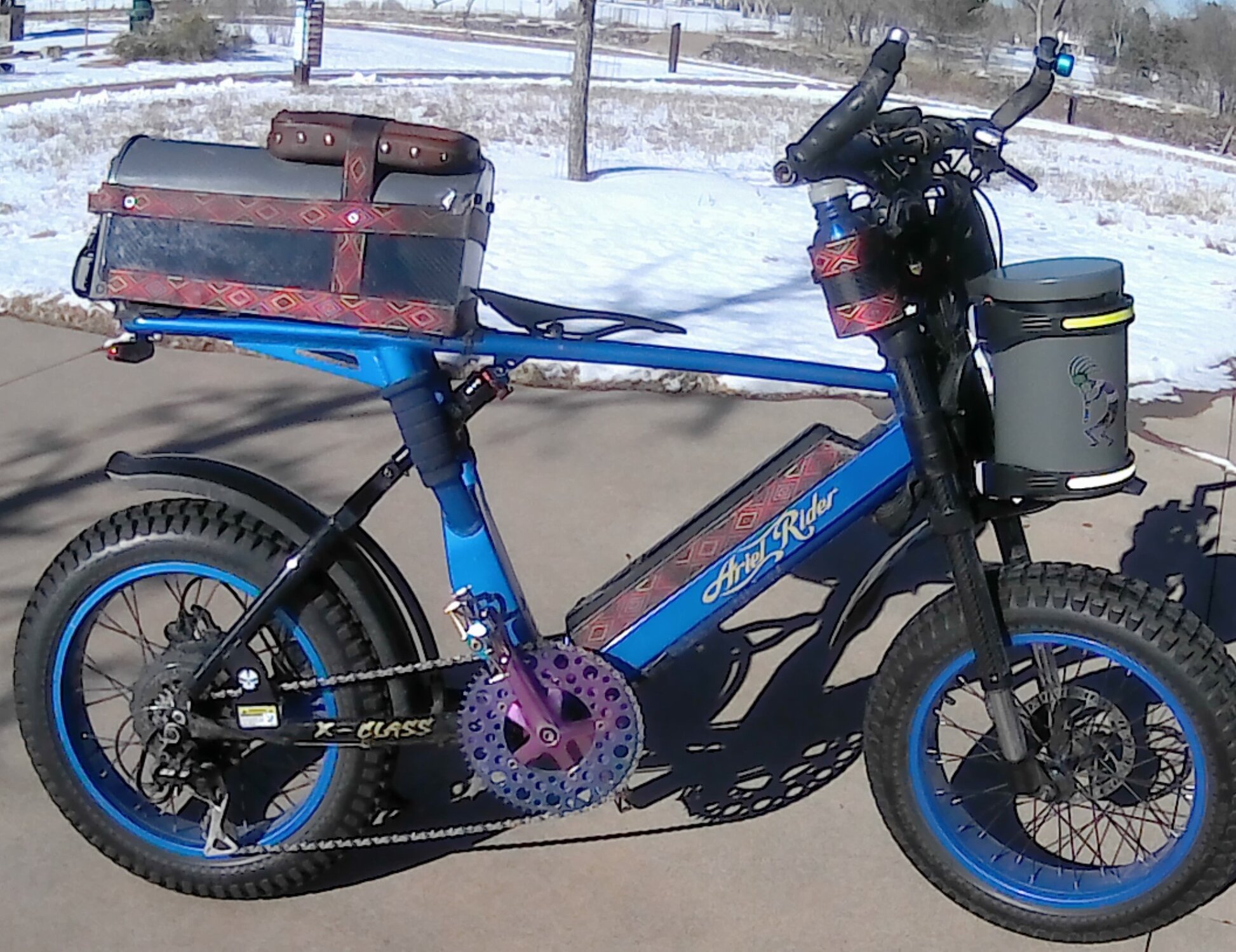

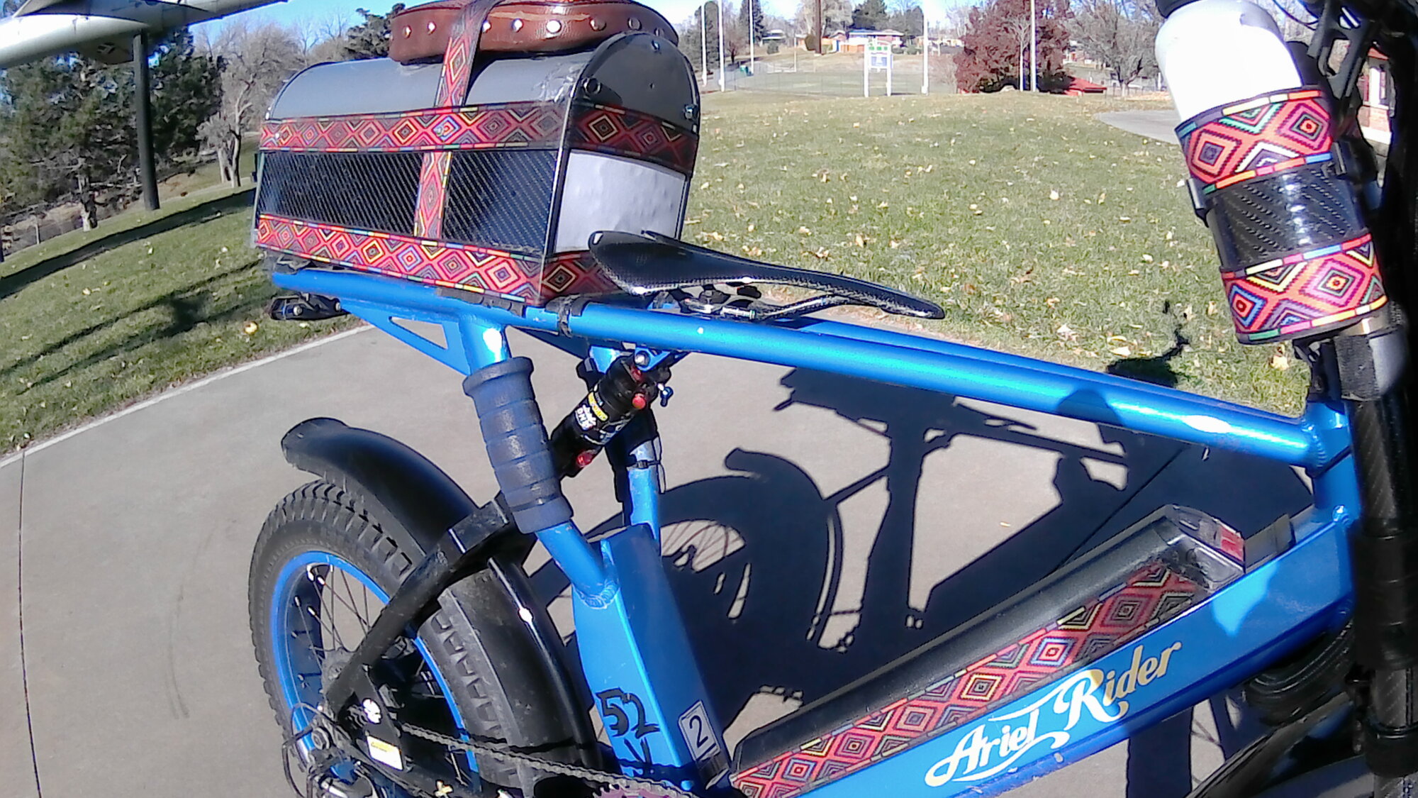

Item #4: I have never been a fan of the rear coil-over rear shock absorber mechanism. So, at mile 9,525, I finally got around to swapping out the original equipment coil-over rear shock (165mm) for this DNM 36rc air shock in size 190mm: https://www.amazon.com/DNM-Damping-Mountain-Pressure-Adjustable/dp/B00R5OA7HA/ref=pd_ybh_a_sccl_123/133-8977163-9247836?
You will also need this pump: https://www.amazon.com/DNM-Bicycle-Shock-Portable-300PSI/dp/B01MUJ0PYL/ref=pd_ybh_a_sccl_120/133-8977163-9247836?
I should have purchased the 200mm long shock because the X52 will easily accommodate it. The 200mm unit has almost an additional inch of piston travel over the 165mm (55mm versus 35mm).
As far as the bushings are concerned: the top bushings can be used as is. The wider bottom bushings must be removed from the original coil-over shock and then installed on the new shock. EazyBreezy. When you receive the new DNM air shock, just remove the bottom rubber bushing on one side and then tap out the metal insert. Now proceed over to the installed coil-over shock.
As for the original coil-over shock, remove the male/female bolt combo from the BOTTOM connector FIRST. Then remove the top bolt combo. Shock is now removed. After that, remove one bottom rubber bushing, tap out the metal insert, and tap it into the DNM shock. Install the rubber bushing.. Install the new DNM shock via BOTTOM connector first. The entire swap-out shouldn't take longer than 30 minutes.
I used 180psi on the top valve. I used 80psi on the bottom valve. The “rebound” dial has 28 “clicks” total, so I just set it at 15. I figured that I'd need to ride a couple hundred miles on the X52 in order to get everything “tuned in”. Nope. It only took about 200 feet for me to deem everything O-T-A-Y. And dang, the difference in ride quality is absolutely amazing. Do it. You won't regret it. I can't believe that I waited so dang long to do the simple swap-out.

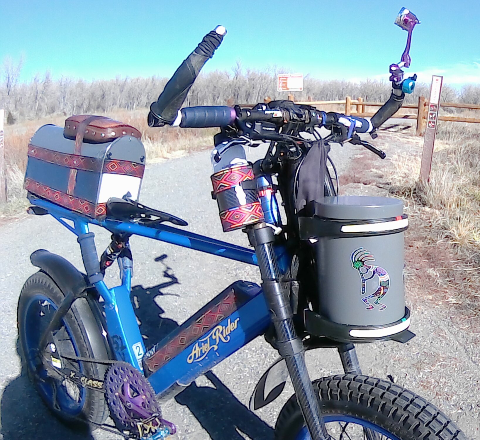

a). When I figured out how to easily raise the seat height 5 inches (the gray mailbox). The height increase allowed me to actually pedal this bike like a bicycle is supposed to be pedaled. This gray item worked out mucho grande because it also allowed me an awesome storage location for 2 batteries. Too friggin' cool.
b). When I installed the pair of SHINKO 241 tires AND their motorcycle inner tubes.
c). When I installed the DNM 36rc rear air shock.
d). When I added the 56-tooth front chain ring next to the original 48 tooth unit, thus eliminating “the chain fell off” illusion when pedaling.
