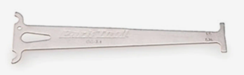

6,300 km on an e-bike is a lot, your chain is probably stretched past 1%, and your cassette needs to be replaced together with the chain.
However, the wear is high on mid-drive motors and a way less prominent on hub drives. I suggest you get yourself a chain checker, for instance Park Tool CC-3.2 and check the chain. 0.5% stretch? The cassette is fine. 1%? The cassette is surely damaged.
When the chain was replaced it was near the outer limit of "stretch" as measured with a chain checker. Thus, based on your feedback (thanks!) I am going to get the gears replaced. The off the shelf cost of the gear cassette is around 45 euros, and the labor cost is only around 20 or 30 euros.
