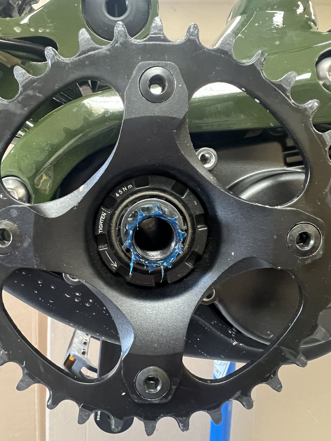

Anyone know what tool I need to remove the chainring so that I can install my MRP bashgaurd?
Its some type of special tool that I assume looks like a castle nut (but not really) because it needs to fit into the notches on the nut holding the front chainring on.
Sorry for the lack of verbiage I come from an automotive/motorcycle background….
This is what I’m looking at
It’s for the MRP AMG guard so I need to get that crank piece out of the way because it won’t go into place with it there.

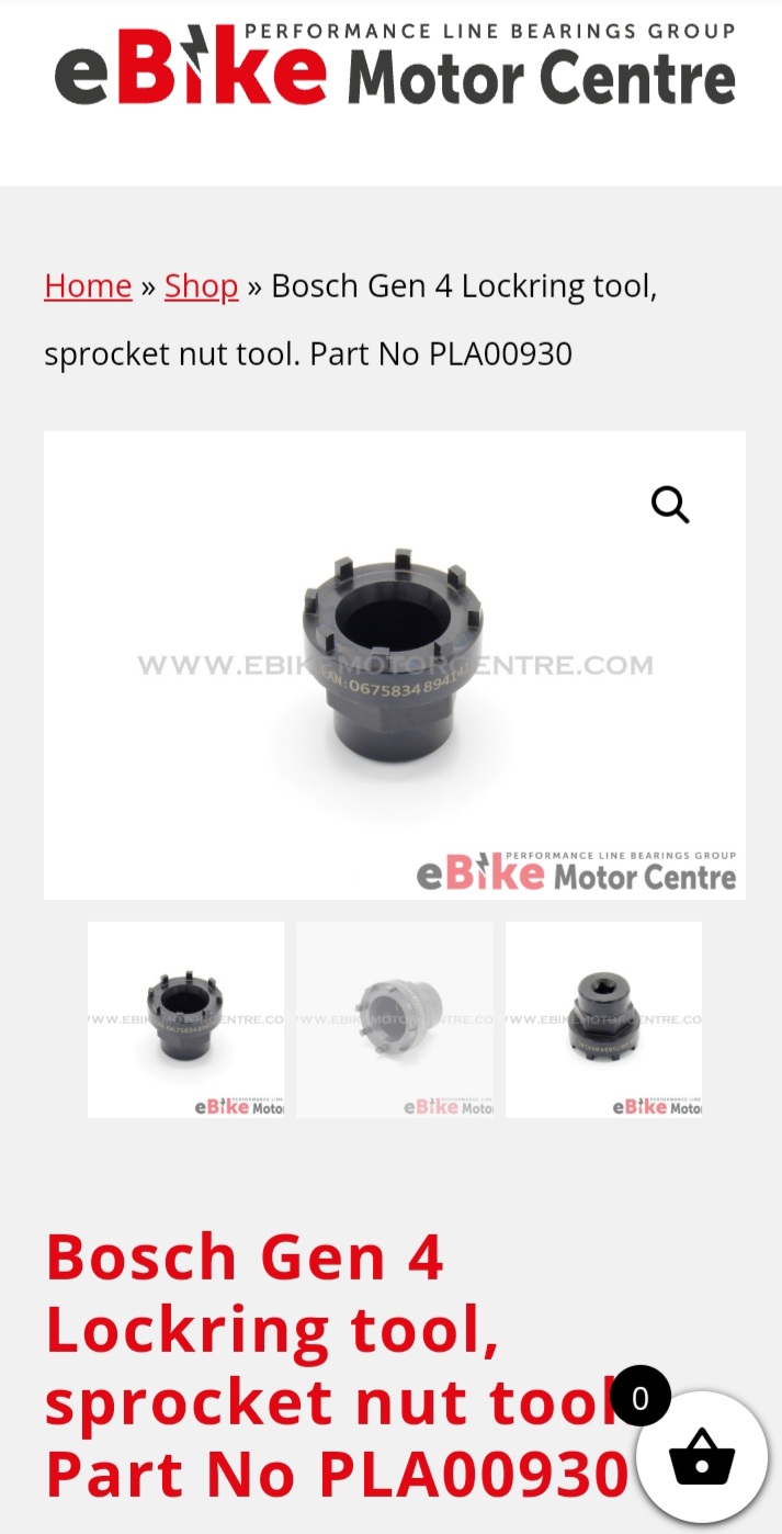

I Googled Yamaha ebike chain ring tool and got this,..
It looks right?
Maybe you can Google the part number to get the dimensions?
