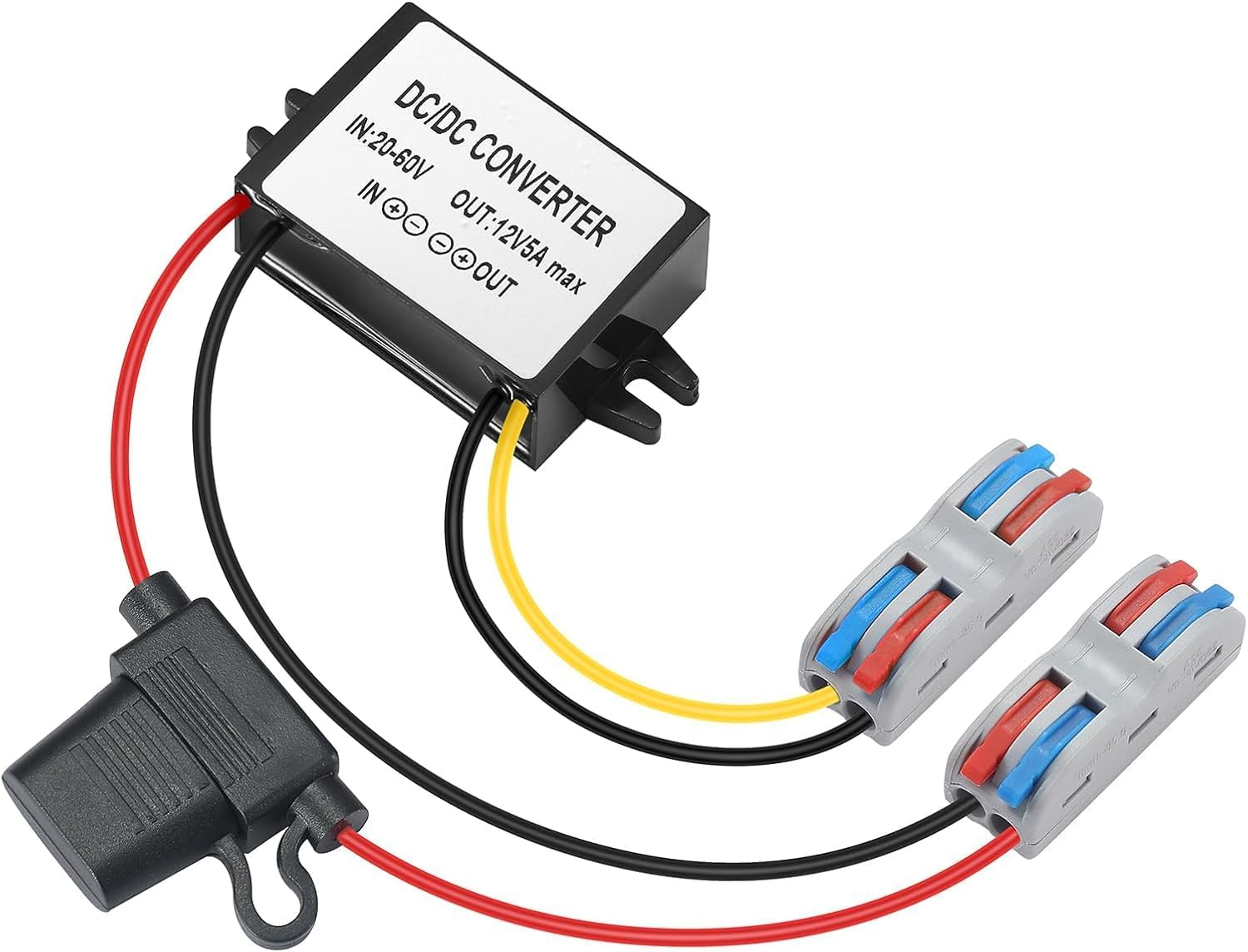

Use one of these to convert your e-bike battery voltage to 12V.

How would you attach this neat item to a bike's battery, when you have no access to any battery wiring etc? I am not opening/messing with the battery.
My mistake. From some of your other posts, I just assumed you were a bit of a DIY'er.
Both the warmers you linked above have USB plugs which means they operate on 5V. If your bikes have USB ports that will handle 7.5W, you should be good to go. If not, your power bank idea would definitely be an option
A power bank like this should handle the USB version you linked to from eBay.
