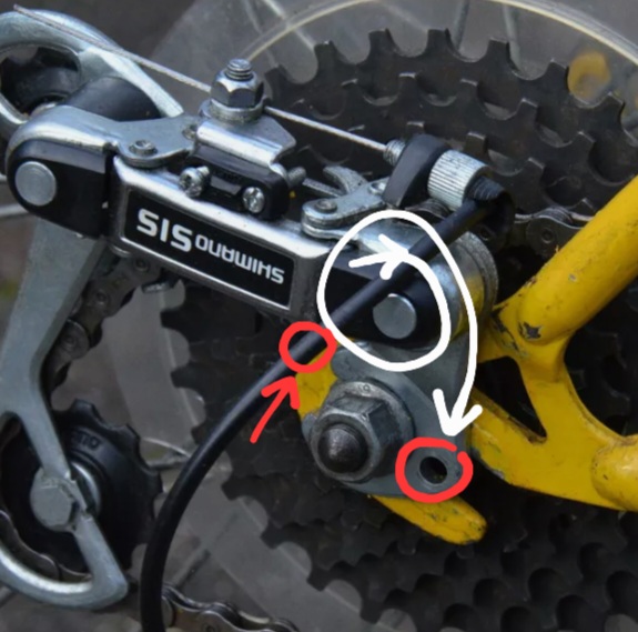

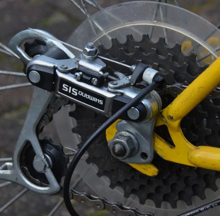

Never see a derailleur mounted like this before: Look at the 4 th photo, Shimano Brand name.
Anyone have more info on this derailleur?
Tia,
They didn't mount the derailleur properly, as illustrated in the instructions,..
The derailleur hanger is spring loaded and wants to orient itself in the position that they mounted it.
You have to rotate the hanger 180° counter clockwise to add spring tension to hanger and chain, and wrap the chain around the sprocket.
There's only a few sprocket teeth in the chain.

Those derailleurs had a hole in the hanger and a lot of frames at the time had a threaded hole near the axle mount to thread in a screw or small bolt to hold the hanger.
There's a Huge spring on the derailleur rotating the hanger clockwise.
I struggled with that damn type or derailleur many times.
There were no slotted axles to keep the hanger from rotating.
Yes it was a dropout shaped threaded insert, I've actually got that very derallieur on bbshd build because its built like a brick pighouse.

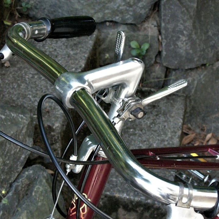

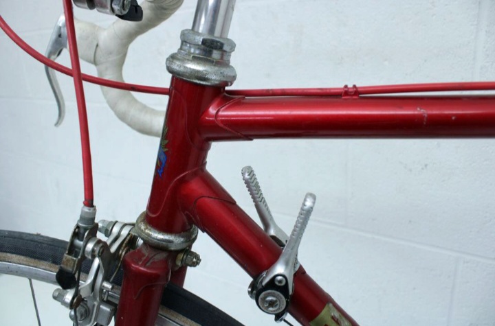

I remember them from the days before twist and thumb shifters, and before indexed shifting as well.
We just had 10-speeds (so 5-speed cluster) and used the derailleur stoppers to keep the chain on the sprockets.
You had to fiddle with the shifter levers to get the chain to stop clattering when it got hung up between gears.
Those derailleurs might work with indexed shifters if the amount of cable movement per gear is correct for the derailleur?
I'm not sure if the derailleur can take up enough slack if there is some Huge sprockets on the cluster, or if it would get hung up on something on an 8 or 9 speed cluster?
