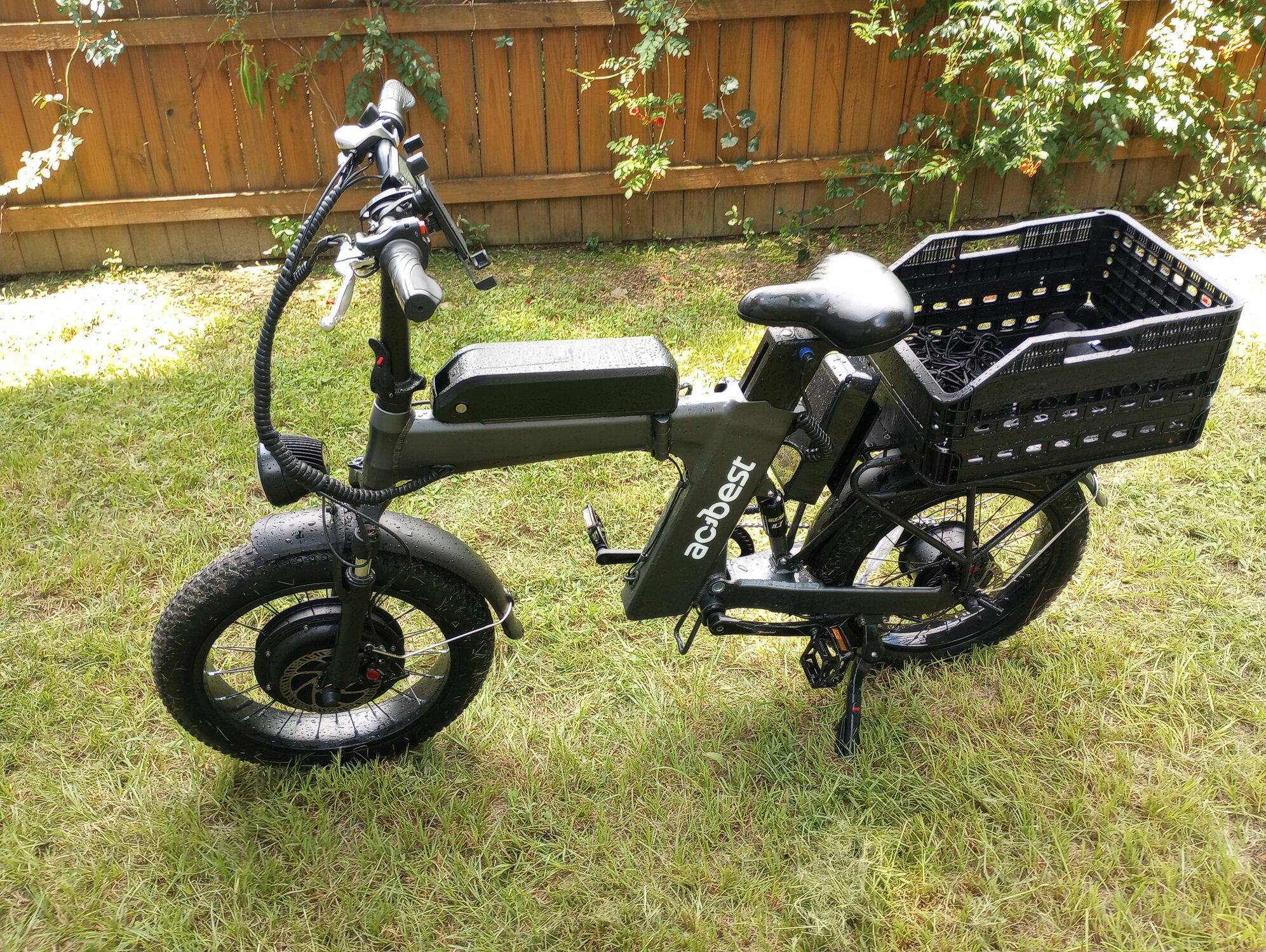

Hello to all , My friends call me "T" and this i my intro here.
Now I will never claim to be an expert in ebikes by any stretch of the imagination but I would like to share my first ride. My rear motor is the factory geared unit 750 watts with a half twist ,
and the front is a 1000 watt inexpensive direct drive in which I wired in a thumb throttle which resides on the left.
I have to say that having two separate systems is really easy to control off road. Now my factory battery is actually the seat post and the front battery is a 52 volt 10 amp unit . I'm considering adding another battery in parallel for the rear motor.
Any suggestions ?
