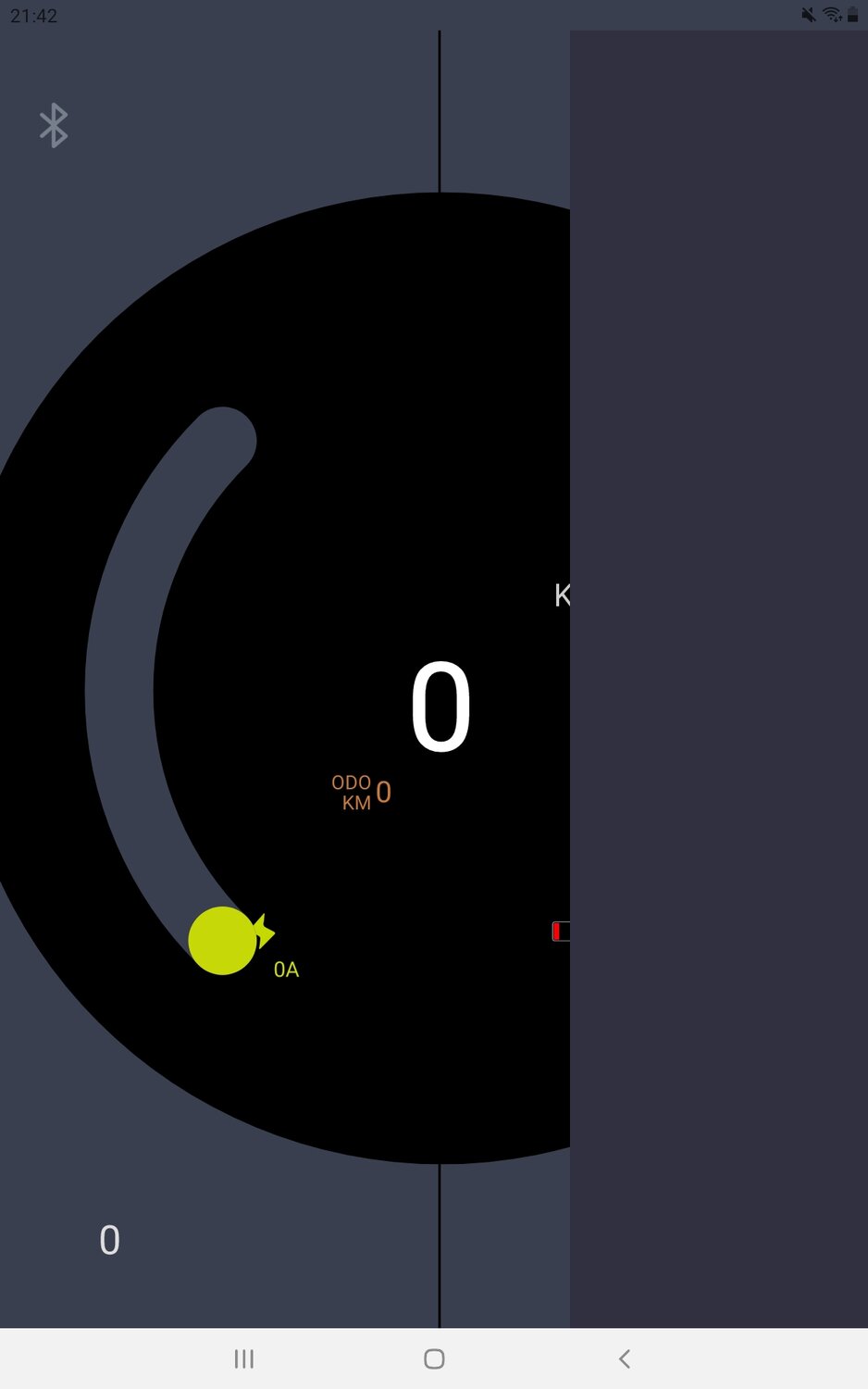

Thanks for that, sadly it didn't work as it didn't seam to open fully , I also tried the + app.
This is what screen I got when opened

From what I understand it's not ready for prime time.
I would put it on hold and see if 2025 brings any improvement
I thought the bafang kits and this display had been out for a while now.
They have been but the Bluetooth feature never caught on and has been a terd from day one.
There's a rider on here who has the latest model of their top of the line mid drive/display and he's never been able to make any use of it. So I'd forget about it working with a BBS* add on kit model for now.

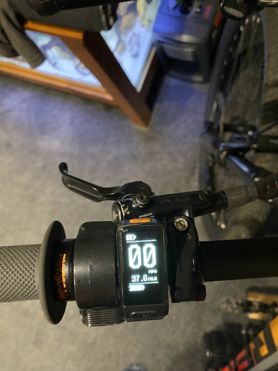

Likewise the display is a bit small and fiddly but I do like it’s size as I’ve managed to tuck in a gap on shimano m7100 slx brake lever which gives it quite clean look on the handle bars.the bafang sw102 display does seam a bit useless with its Bluetooth.

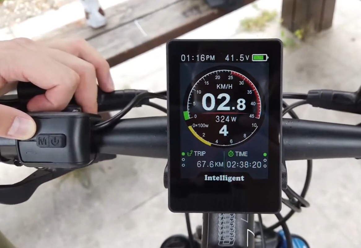

I prefer a giant mid mount display with separate buttons easily manipulated blindly mounted near the grip... But hey, there is no wrong when it comes to personal preference.

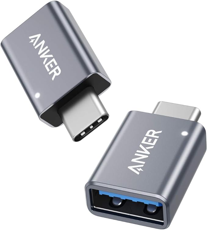

Just make sure you have a USB to what ever port you have on your phone adapter as well to work with the programing cable. Typically type C these days.

I’m going to use Samsung tablet with speeed and I have same connector to turn type C into USB

I'm using something similar to this... Much more refined.
