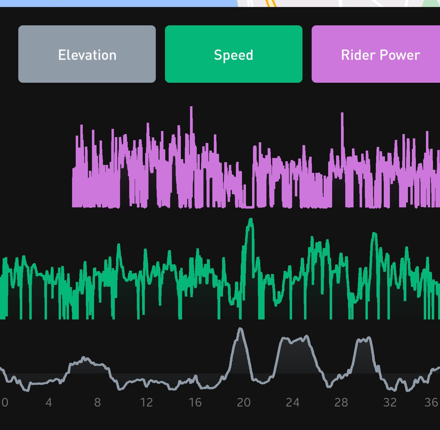

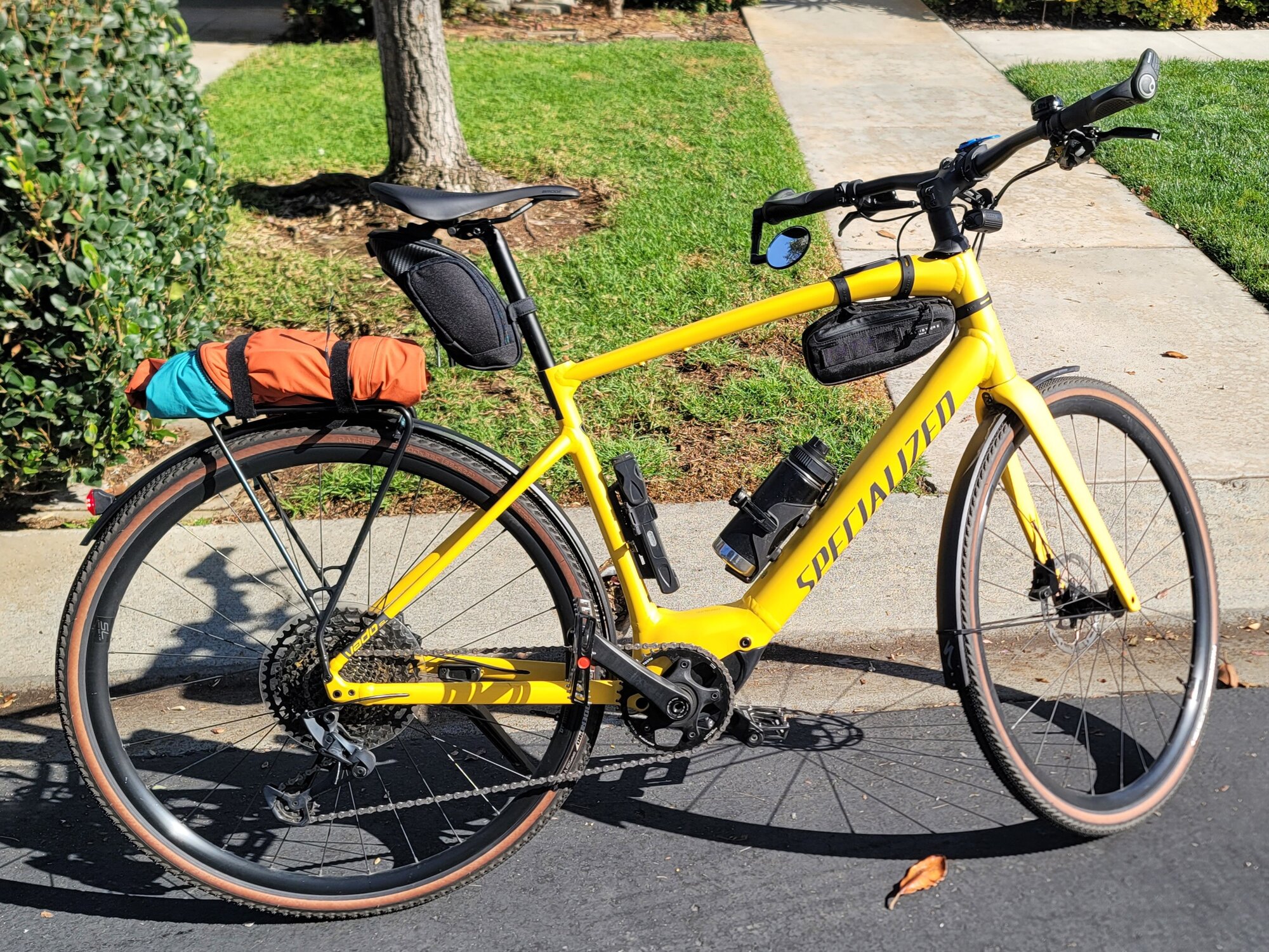

My beautiful Vado SL 5.0 has generally worked quite well with the current (black icon) Specialized app (v. 1.34.0) since purchase 3 months ago.
But 5 times now — and for no apparent reason — the app has failed to record rider power (Pr).
Toggling the bike off and back on doesn't help. Plausible real-time Pr values show on the Mastermind TCU the whole ride, but the Pr field on my app screen shows only "- -" when this happens. I conclude that the fault lies with the app, not the underlying sensors.
The Pr recording failures affect all Pr-related data including calories burned. But all other app-reported data records and displays properly. Ring any bells?
Last time this happened, I tried something new: I stopped and then resumed the recording 6 mi into the ride without finishing the ride in the app. As you can see from the app's ride analysis, Pr recorded normally thereafter.

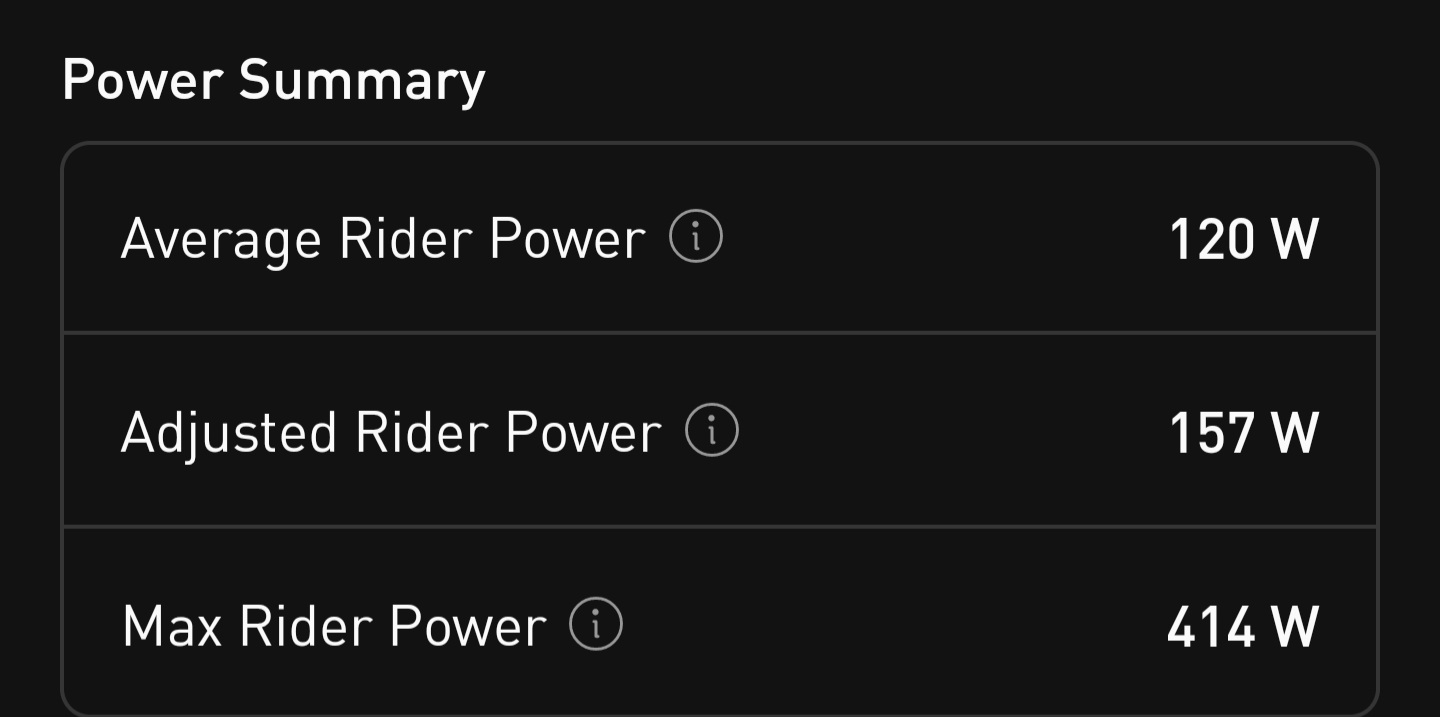

After finishing the ride in the app, I got the usual Pr summary — presumably with the first 6 miles excluded.

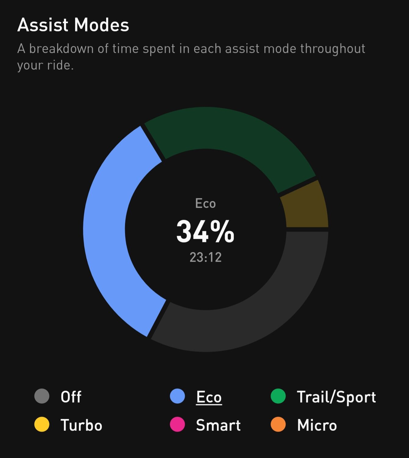

But unlike previous occurrences, the app wouldn't display the usual assist mode pie chart this time. (Example from an unaffected ride.)
