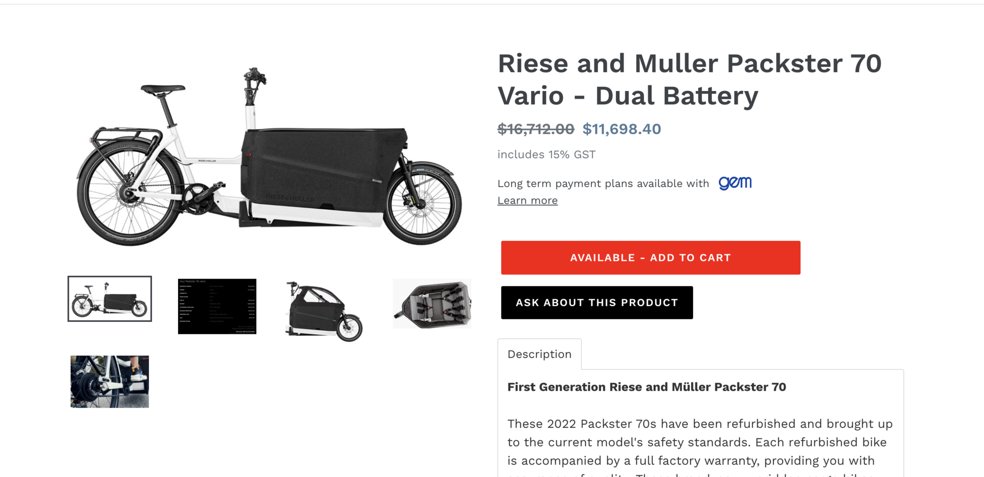

Interesting - LBS R&M Dealer just listed a Packster with significant discount:
Riese and Muller Packster 70 Vario - Dual Battery – Christchurch Electric Bicycles
Interestingly, appears to be a refurbished model:

Packsters were recalled 20-21; assume this is a refurbished recalled model. Problem was with the steering, IIRC. Regardless, I would not purchase a Vario -- too many have failed multiple times on cargo bikes during the warranty period for comfort.
