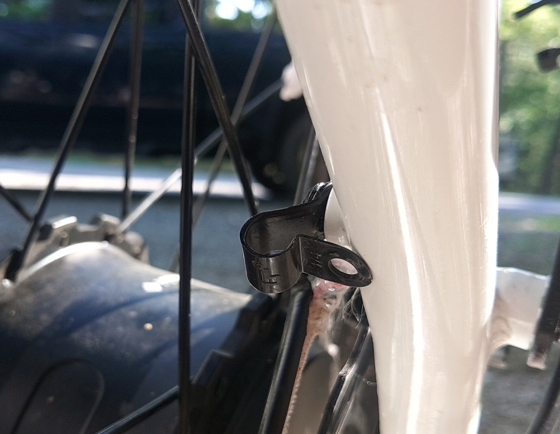

While maneuvering thru trails, something hung my rear brake line and pulled it into my rotor. On the frame there is a two hole keeper the brake line is to be retained in. Only one hole was captured by the screw.
Question: Is your Xpeak step thru rear brake line captured in this keeper thru two holes or one?
The brake line abraded enough to leak and lose the fluid. Photo attached.

I am not familiar with that bike. I am familiar with that type of “keeper”. Both holes are supposed to be secured by the single screw. I can tell from the 90 degree angle of the floating hole. It will fit perfectly, against the frame, with the screw penetrating both holes.
I’m not in a place to check right now, but I would check some reviews. Even better an assembly video. To see how they do it.
