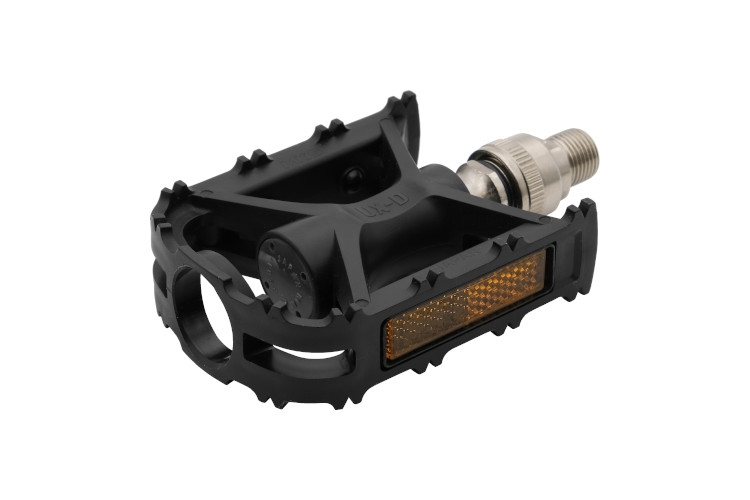

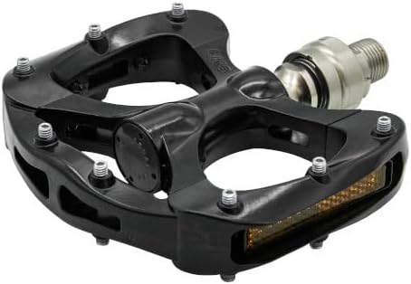

For a completely different option, consider removable pedals. We frequently carry our two Gazelles on the rear of our travel trailer/caravan. with removable pedals, there is no interference between the two bikes, or any chance of a pedal from one bike rubbing on the frame of the other over rough roads. It takes less than a minute to remove or replace the pedals once the adaptor is installed. I have the MKS UX-D Ezy nylon pedals on my wife's Arroyo C5, as she is a casual rider. I have the MKS Pretzel Ezy Superior on my Ultimate C380 for better grip. If you choose MKS removable pedals, be sure to also get the thin spanner specifically for the narrow wrench flats. A typical Park pedal wrench is too thick. I originally considered folding pedals, but most are only reduced in length by about half when folded.
MKS are high quality, reasonably priced pedals made in Japan. Only the Ezy and Ezy Superior are removable. A friend has the Ezy SPD-compatible pedals for use with SPD shoes, and then quickly swaps over to an Ezy platform pedal for casual riding. Note that Ezy and Ezy Superior pedals are not interchangeable. Ezy pedals have a locking ring that is installed after snapping the pedal in place. Ezy Superior pedals just twist and push to lock and unlock.
