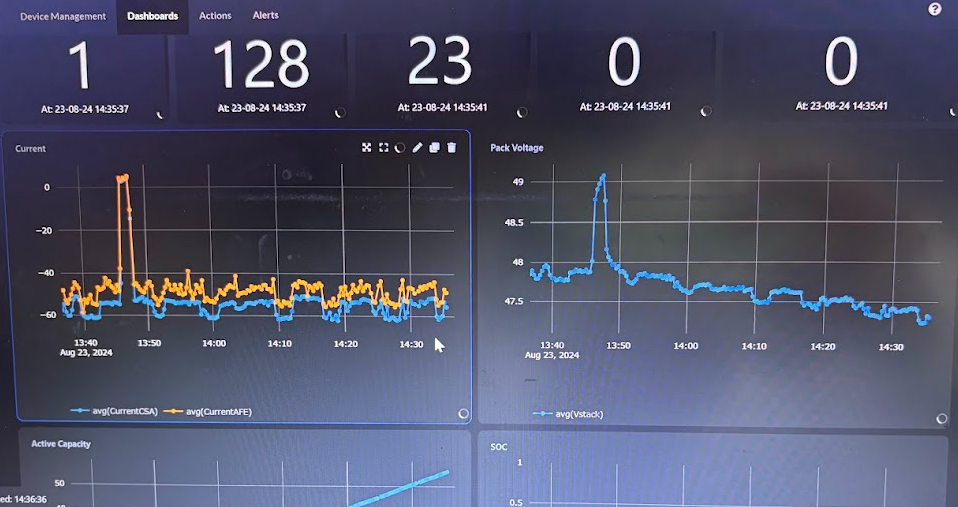

A gps 4G battery, do you have to log in to turn it on?
Nope.
You would be able to track the battery, and this feature makes it difficult to steal the bike.
Moreover, the amount of insight you can get from telematics is fantastic. We could handle about 1 million data points per device per hour.
So, this provides accurate control over the state of charge and state of health of batteries and being connected to cloud, we alert the owner if there are any abnormalities. Our BMS picks up any sign of thermal runaway within 150 milliseconds, further improving safety.
Can it alert for thermal runaway, I guess it would have to be quick.
Thermal runaway has several signatures that can be picked up 30 minutes before. Typically, the cell starts overheating before crossing a certain threshold. Whenever we notice abnormal voltage and current fluctuations, the algorithms immediately shut down the pack, isolating cells. If, for some reason, one cell catches fire, the whole pack has fire retardant material inside that will ensure the propagation will not happen.
When you see the video, you will get a better picture of this.

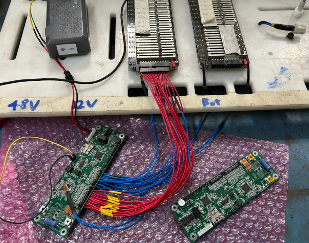

It has a 4G SIM card (in the future, we are planning to use e-SIM). You could use any network, such as AT&T, T-Mobile, or Verizon.
If there is no network, BMS has a 32GB micro-sd card that can store the data up to 5 years without any loss and whenever it connects to the system via USB cable or 4G network resumes, it will upload the data to the cloud.
BMS functionality test for the alpha-prototype is happening and everything is working well. It exceeds the UL-2271 requirements by a mile.
