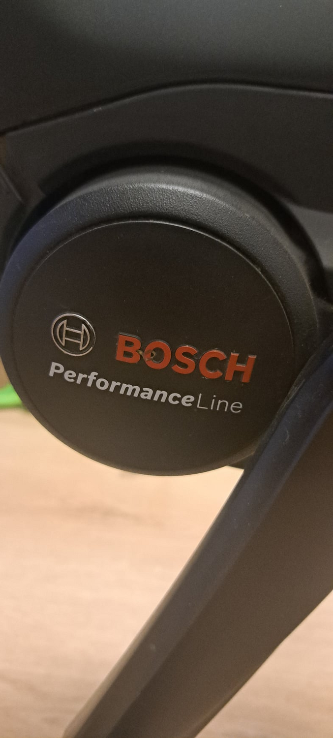

@BlackHand could you tell me the specs like the peak power and the Boost Factor for the Bosch Performance Line 2021?
600w peak, 75Nm, 340% max assistance.
