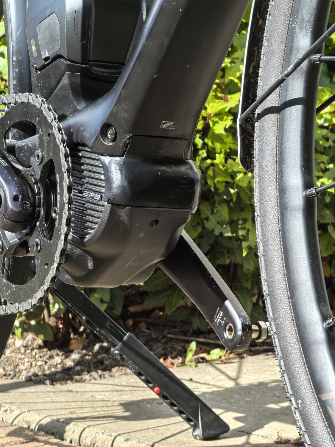

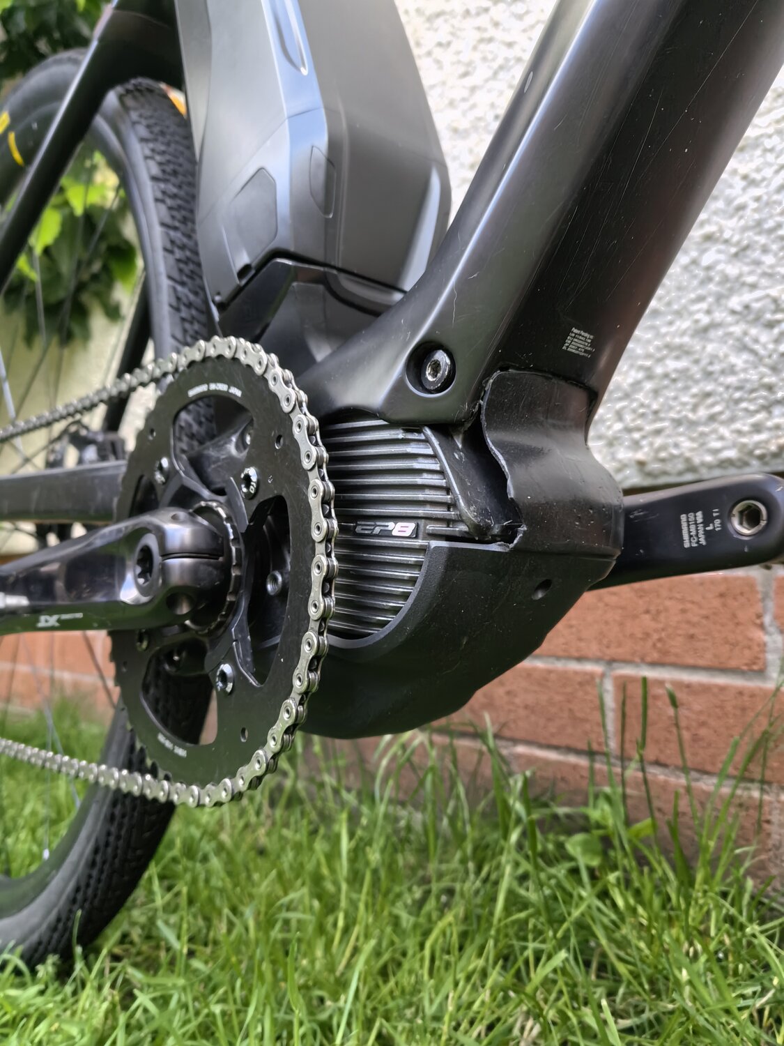

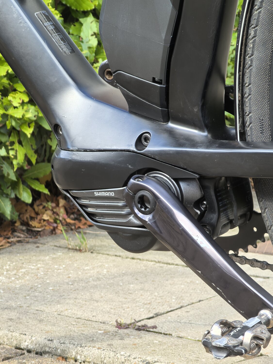

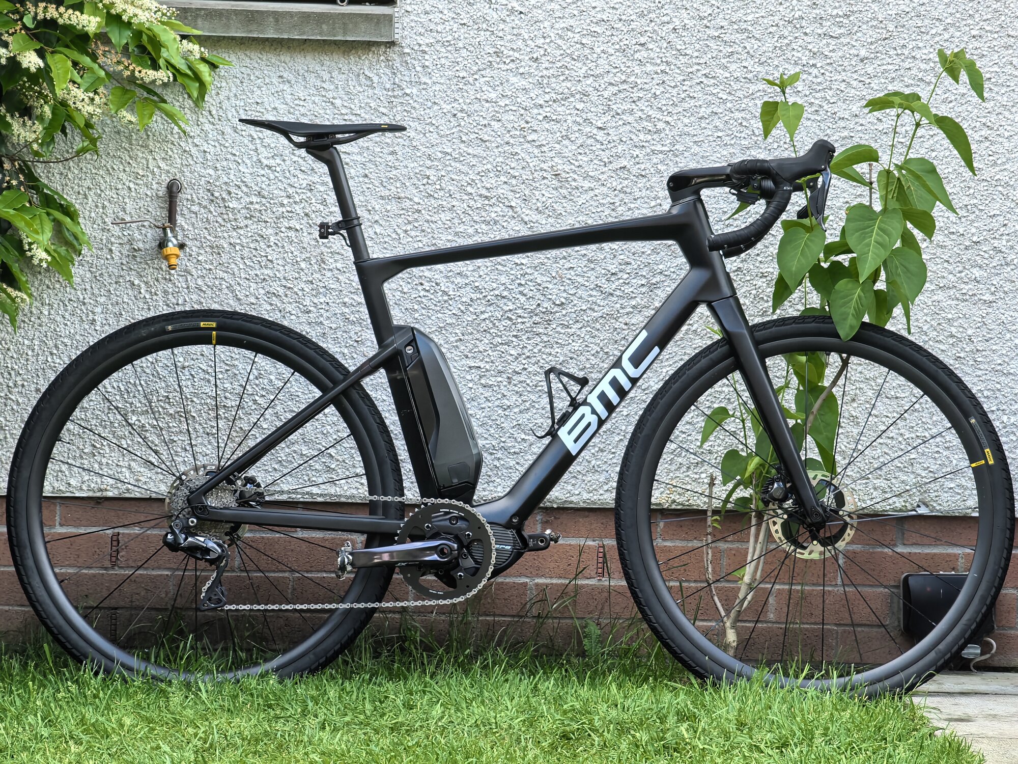

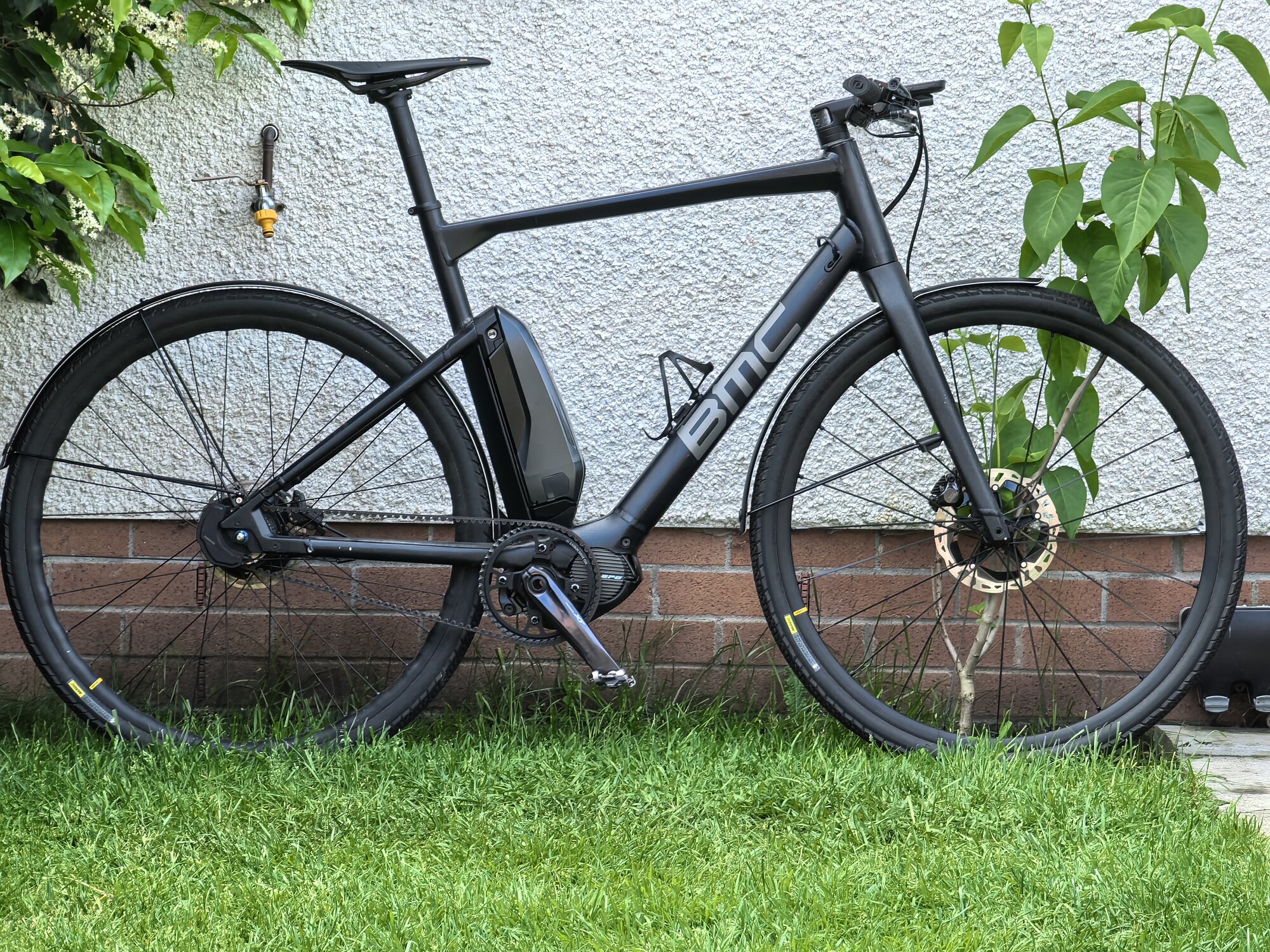

Hi everyone, first post so be gentle please.

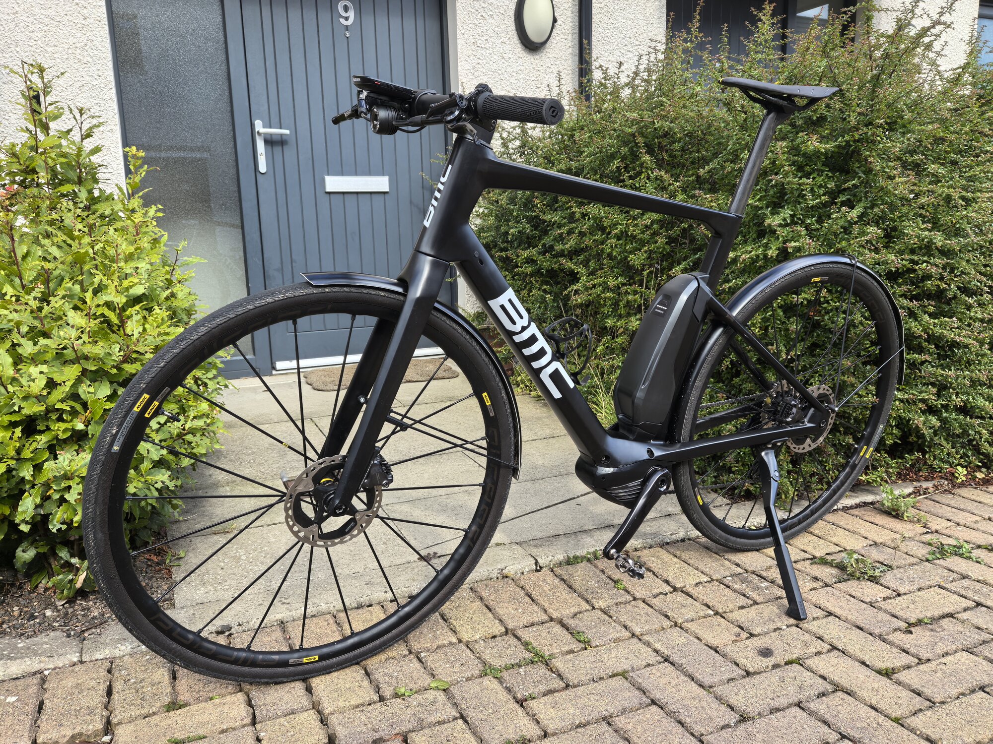

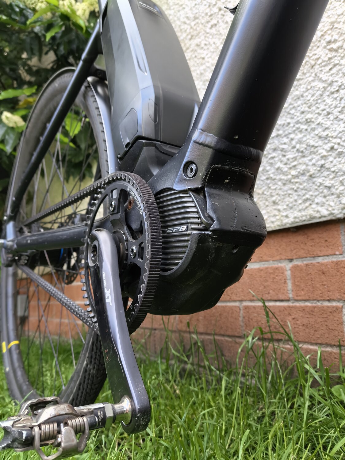

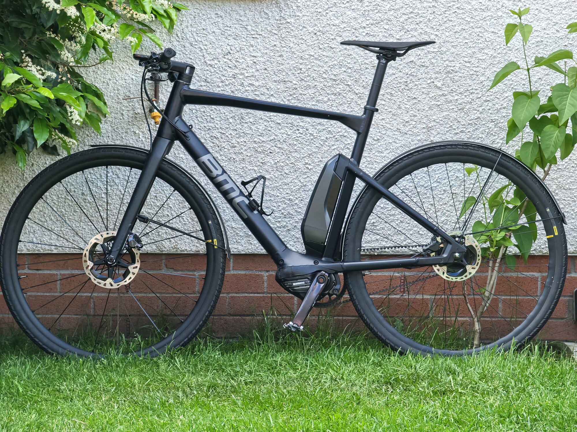

I own two versions of Alpenchallenge AMP (carbon and aluminium)
I have changed motors on both to newer generation EP8 and bikes perform amazing.

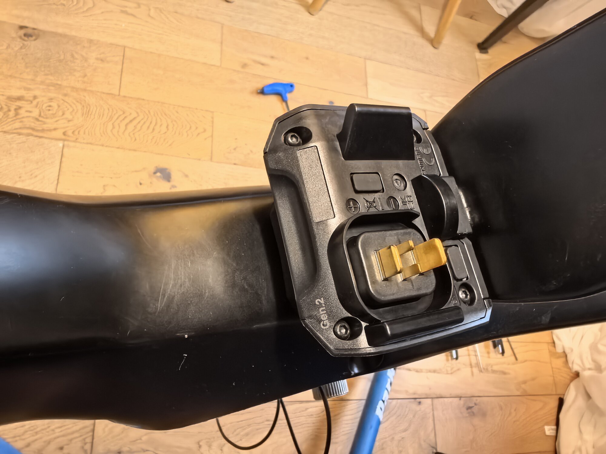

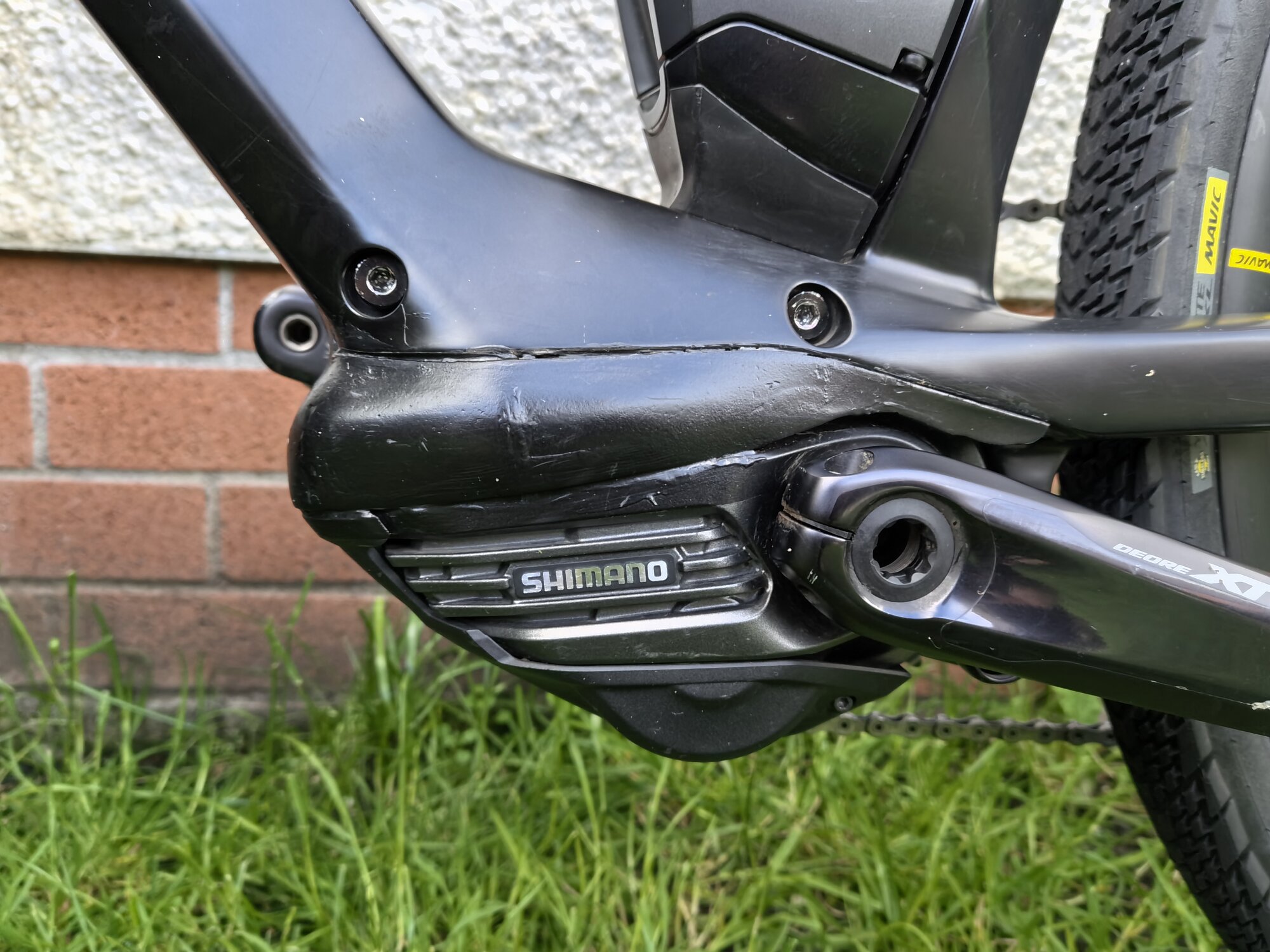

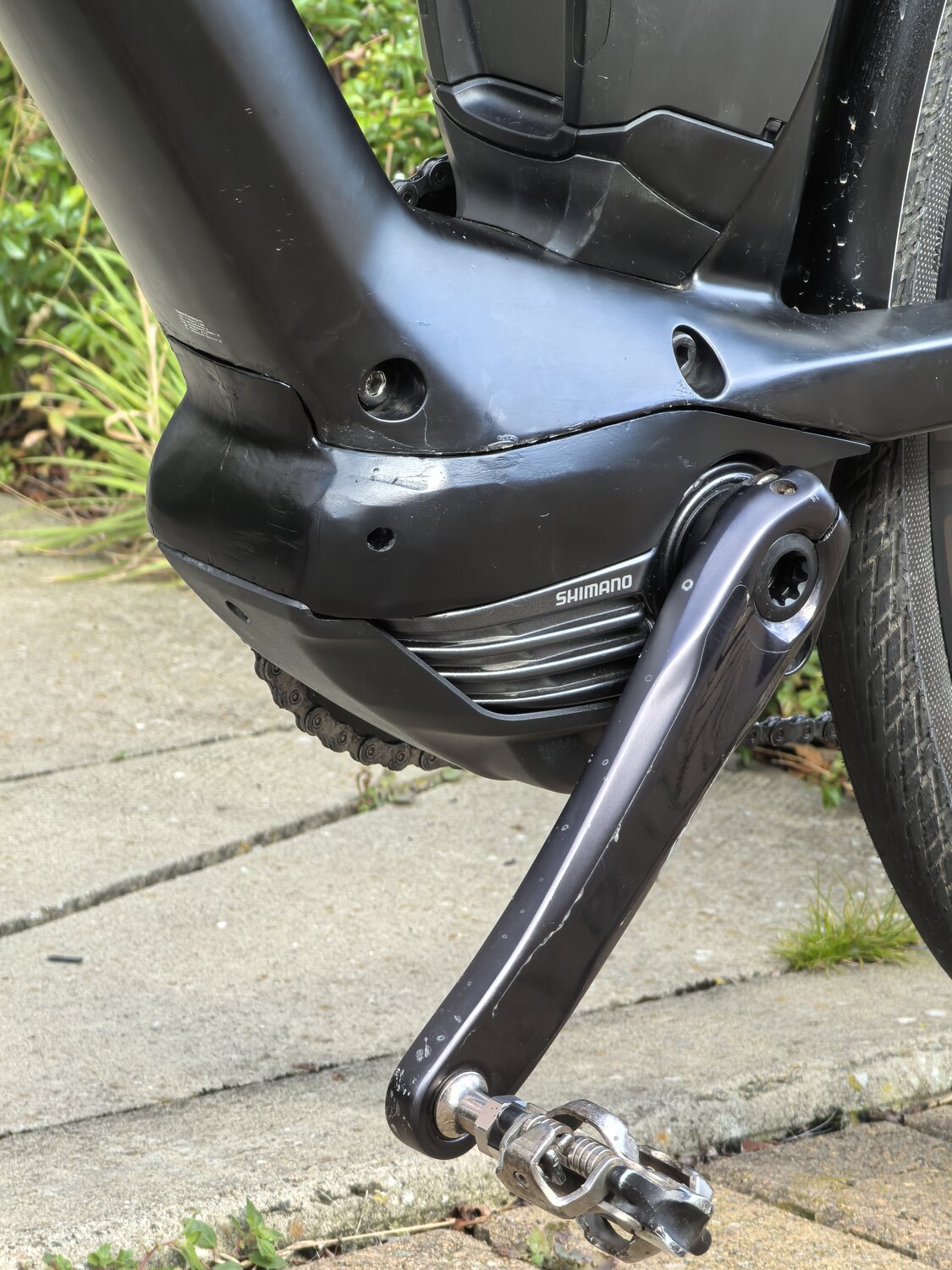

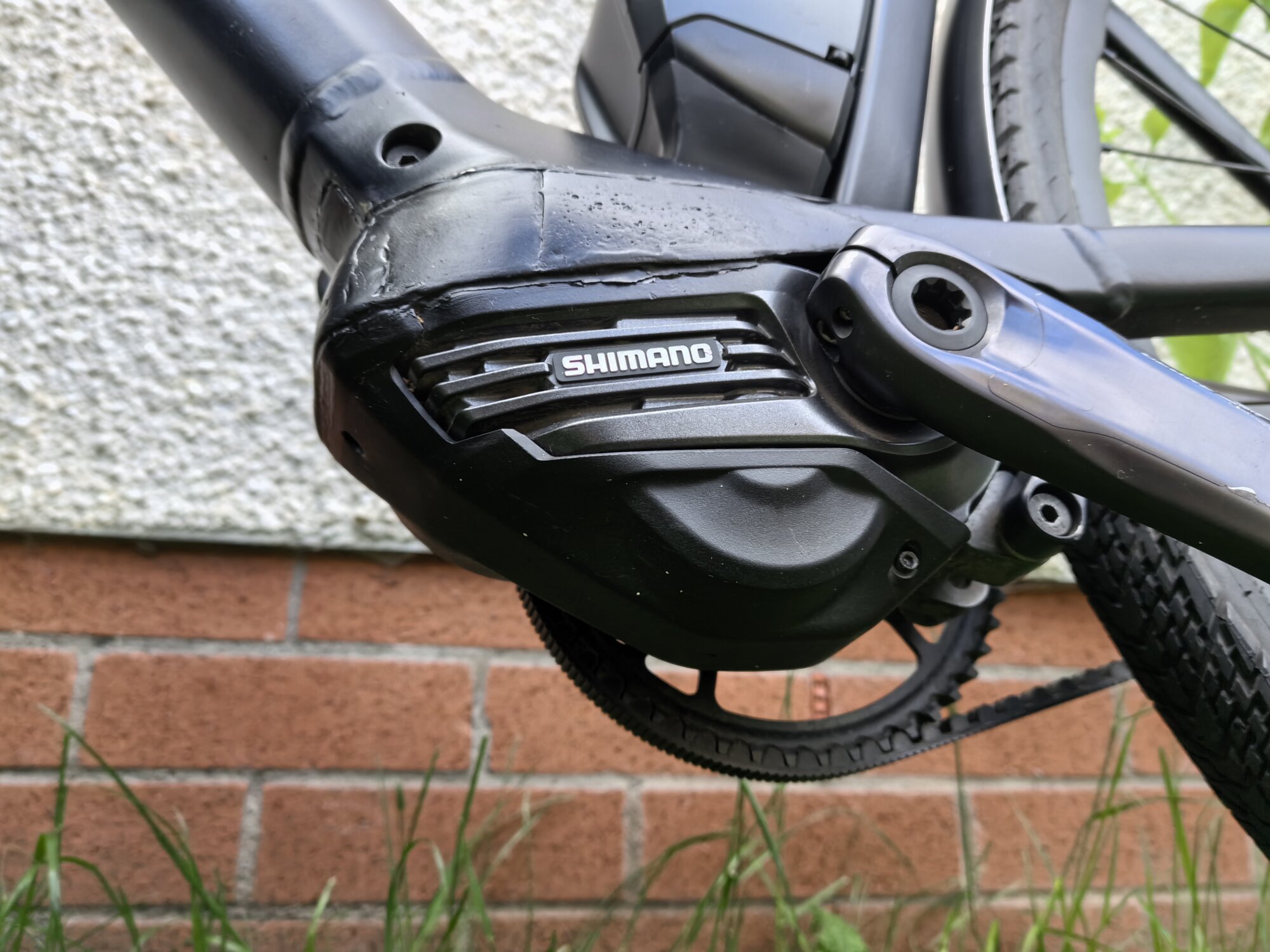

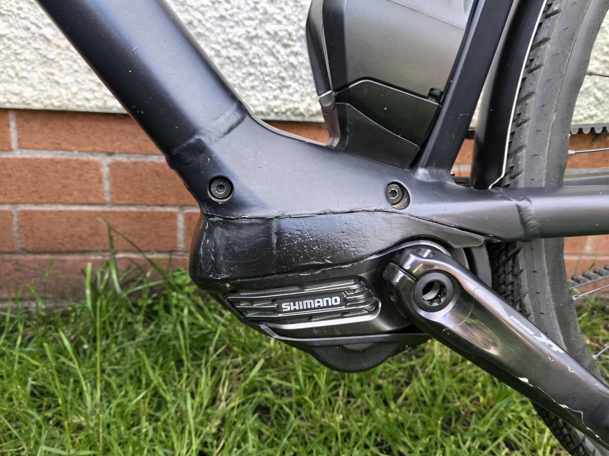

The problem is with motor covers as they been designed to fit on older DU-E8000 and DU-6100 units.
I made some DIY prototypes using epoxy and heat gun but those aren't perfect.
They are glued on so any motor service requires ungluing and glueing back on.
I am looking for someone who has some knowledge or tips to help me design those covers for 3D prints.
Or point me in a direction to whoever is in a 3D design business.
The idea is to get them (new covers) fit with EP8 screw holes so they can be easily removable and serviceable.
Bottom motor covers used here are genuine Shimano products (DC-EP800)
Thanks
Bart

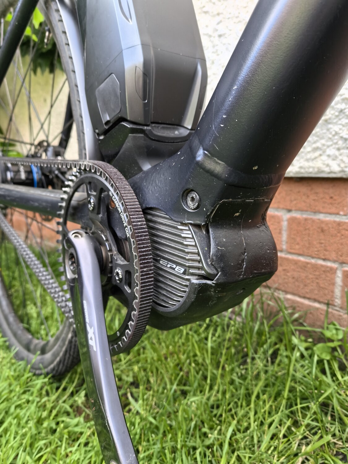

Of course both EP8 motors are much quieter compering to 6100 and 8000 versions.
I also notice that motor on a aluminium bike with a belt is whisper quiet vs just quiet on my carbon LTD bike.
Shimano is forcing some reduced power settings on EP8 if it is used with Di2 belt driven hubs - max torq is only 50Nm on the highest level of assistance (plenty enough for my needs)
No such a reduction happens when belt driven hub is mechanical (not Di2)

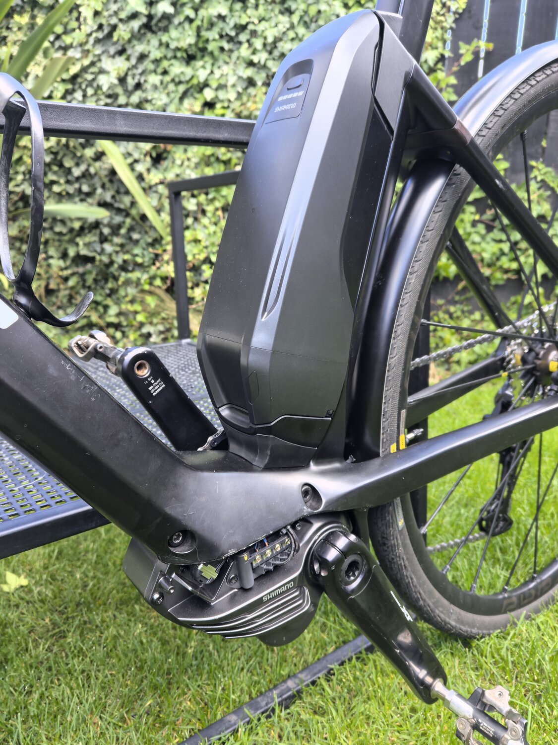

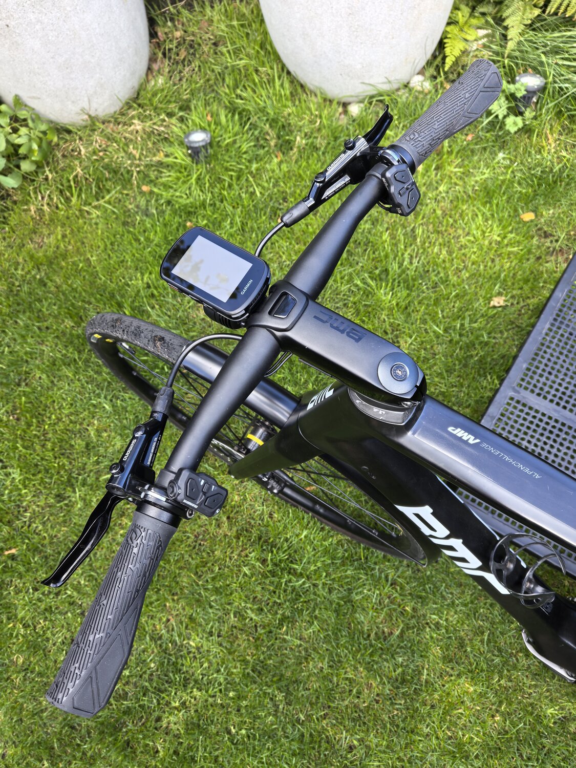

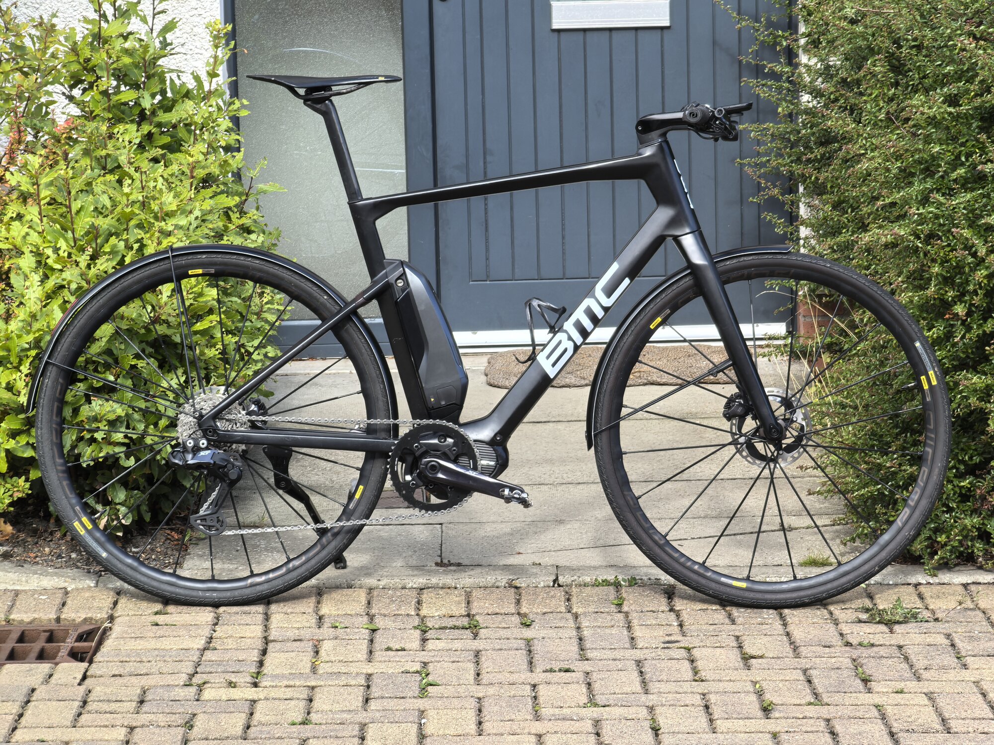

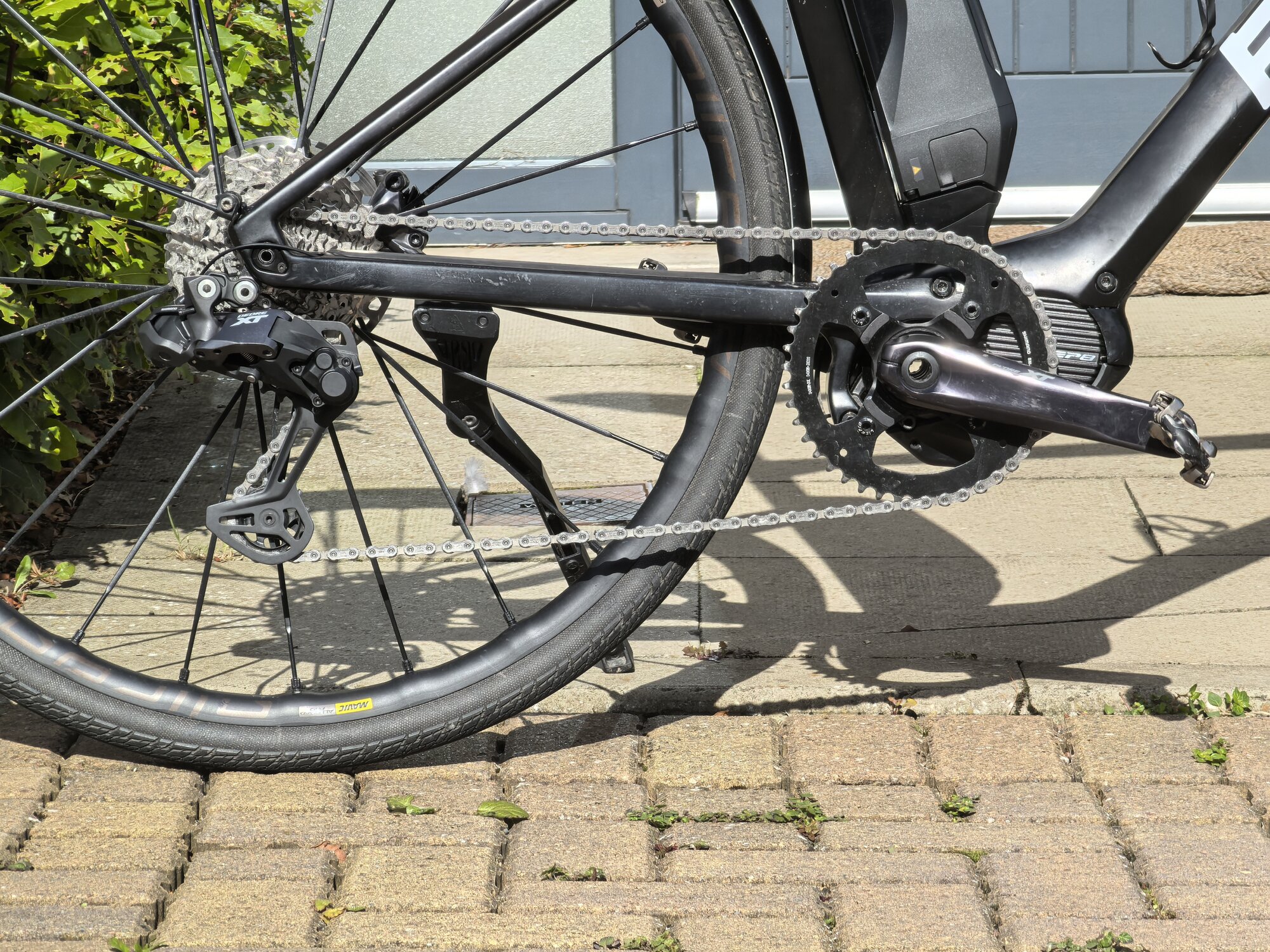

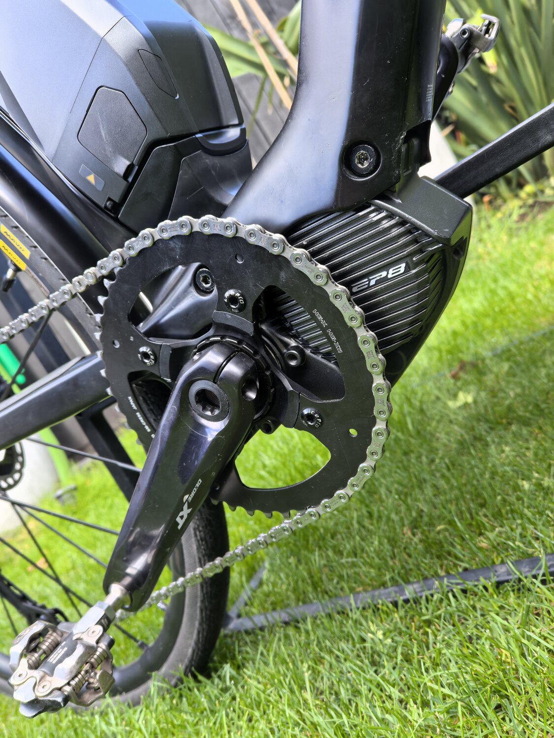

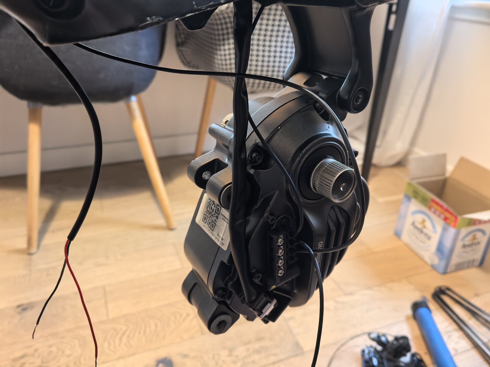

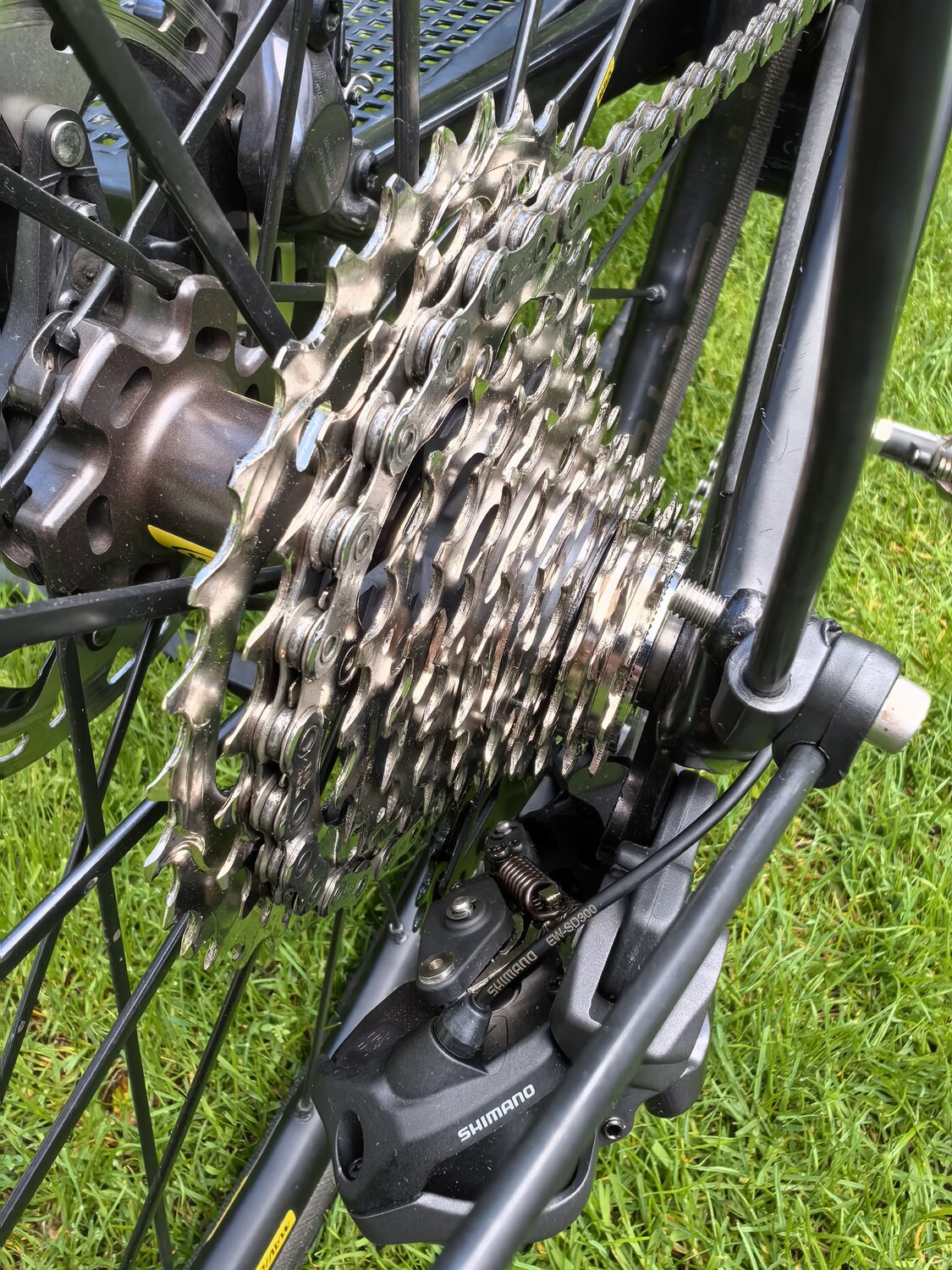

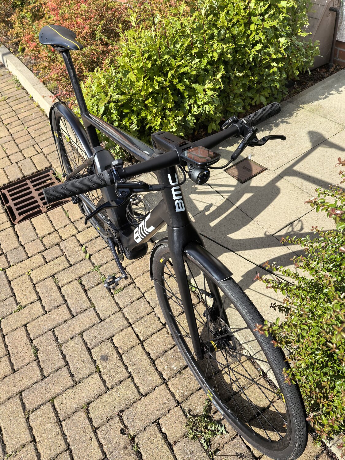

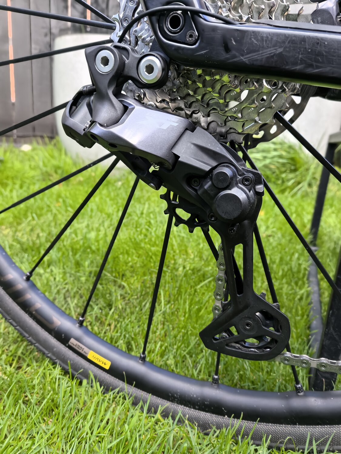

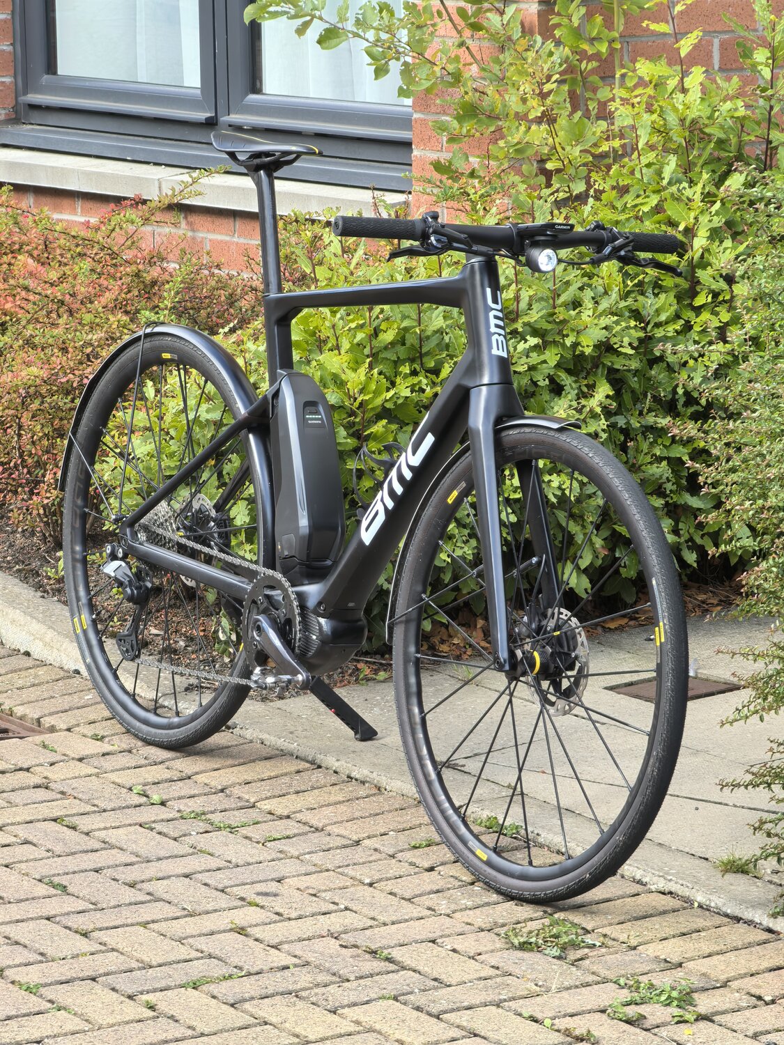

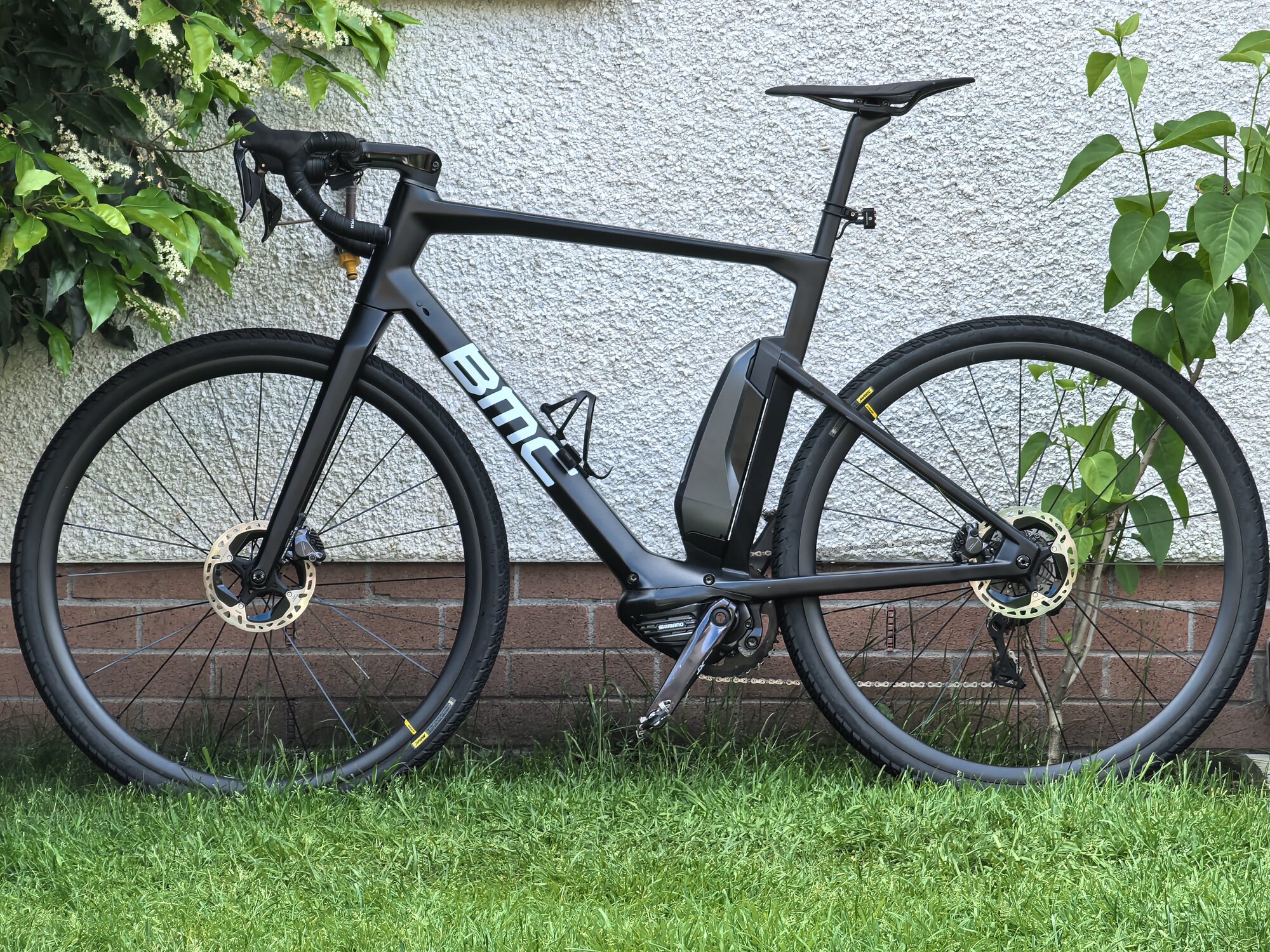

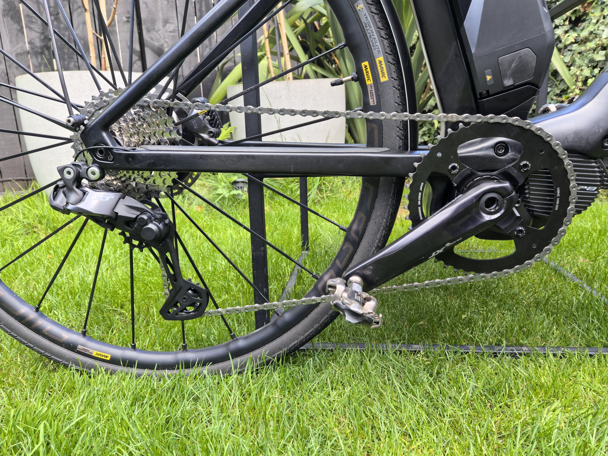

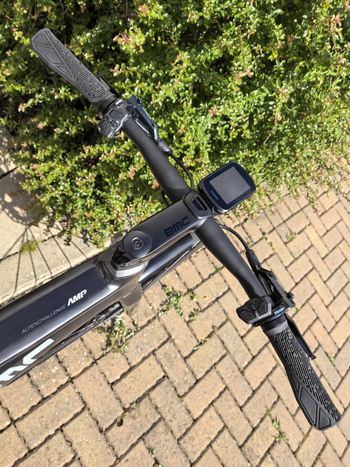

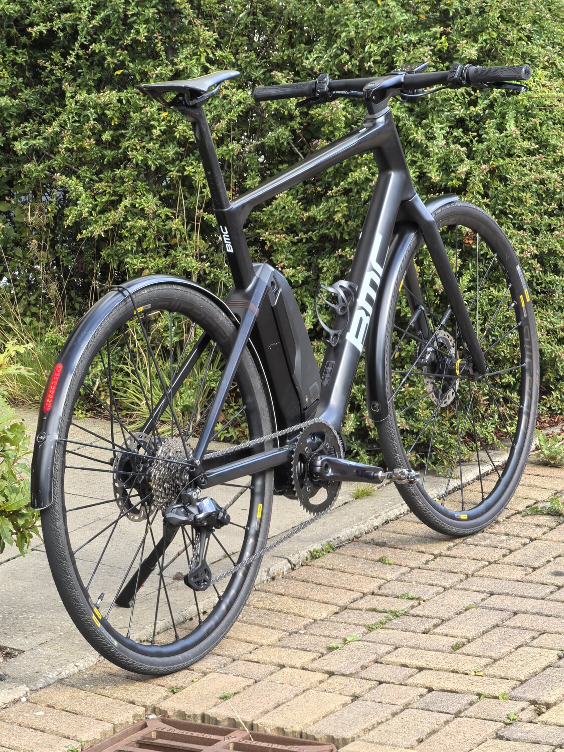

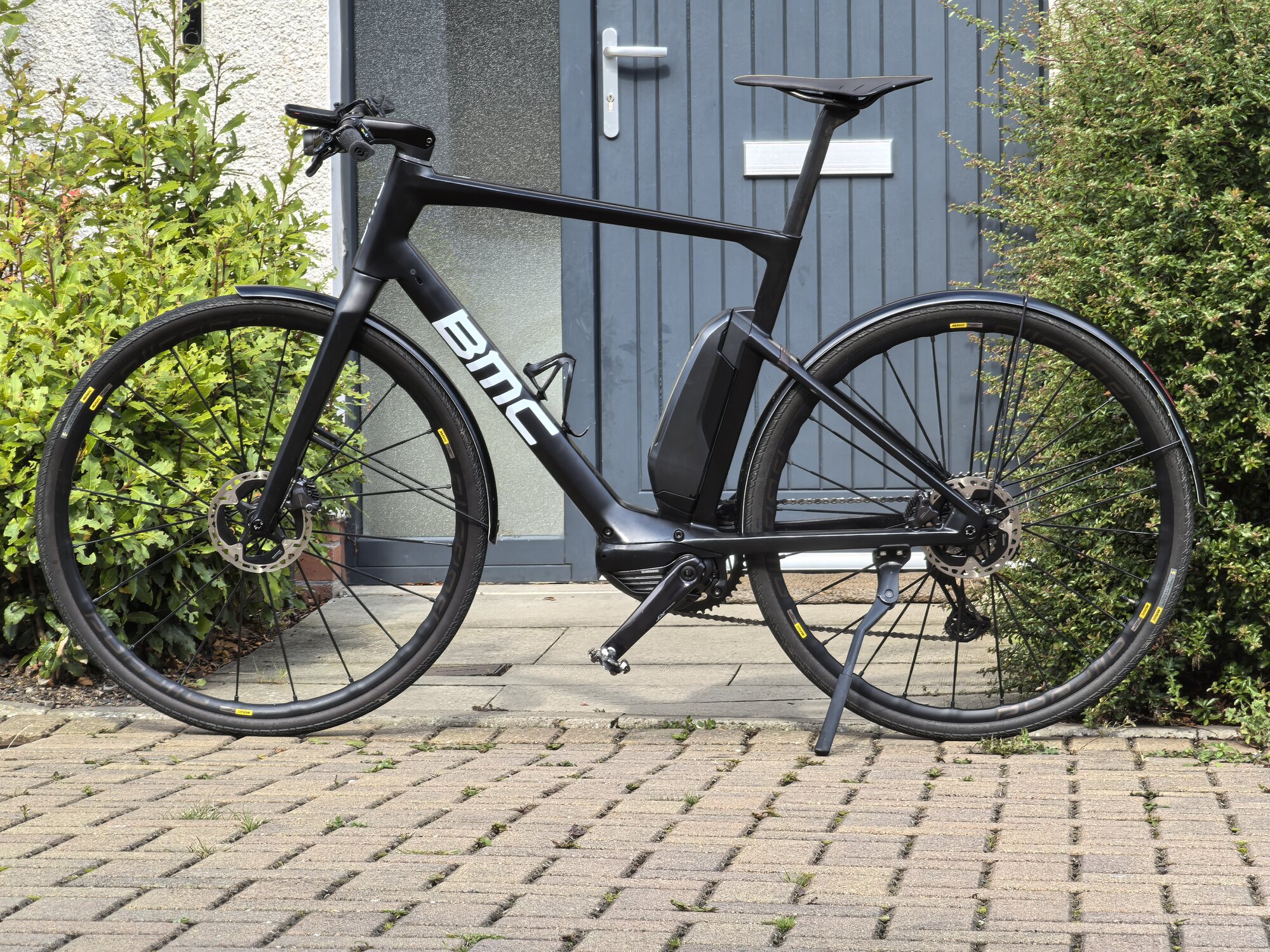

Currently upgrading one of my BMC AMP bikes from EP8 to EP801....
It is completed now apart from motor covers.

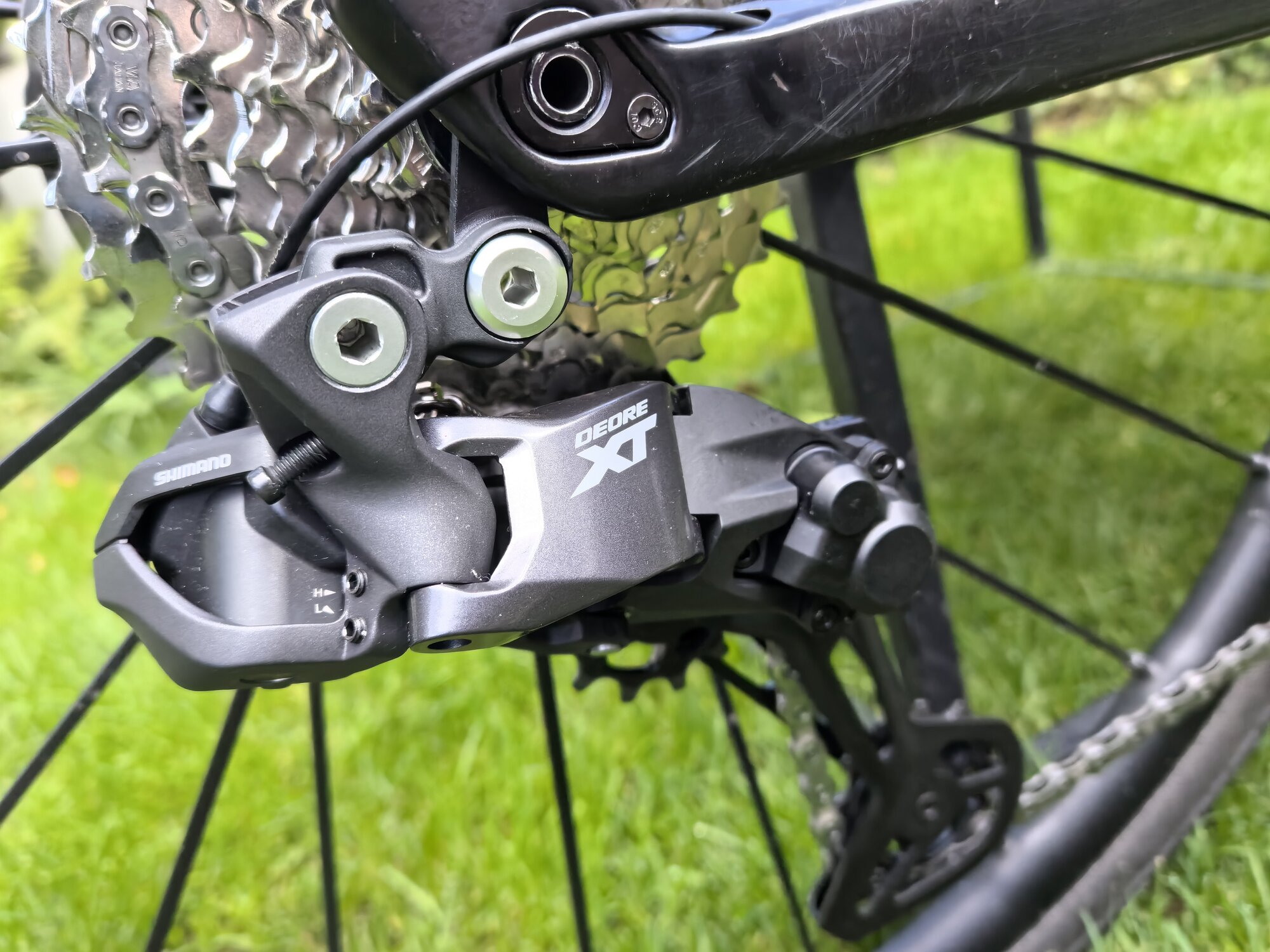

Went for Di2 Rear Mech RD-M8150 combined with 11-36 12 speed cassette.

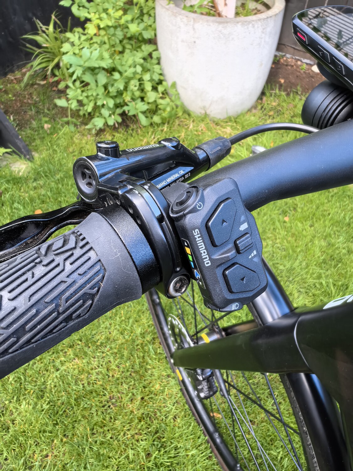

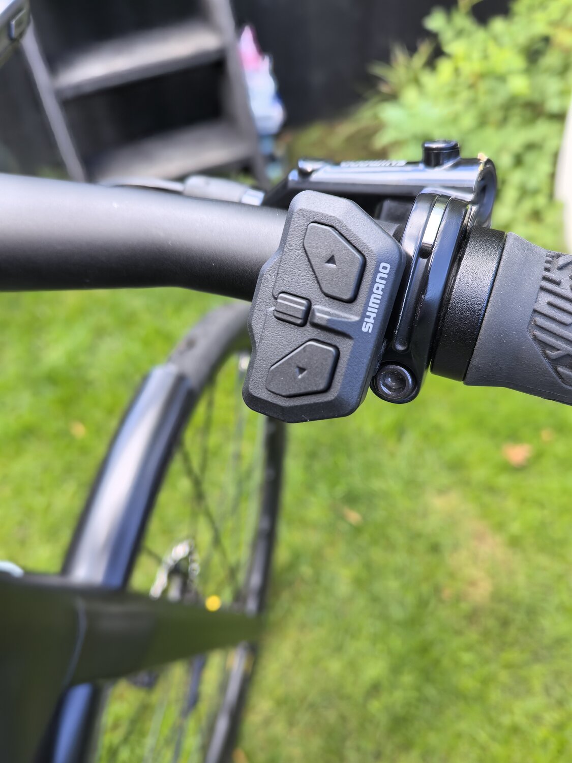

Switches on the handlebar are SW-EN600-L and SW-EN600-R
Motor has now unlocked assistance up to 50km/h thanks to Markus from eMax tunning.

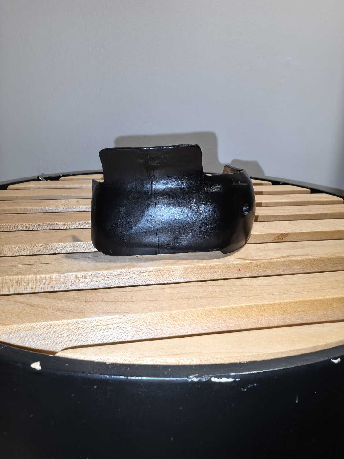

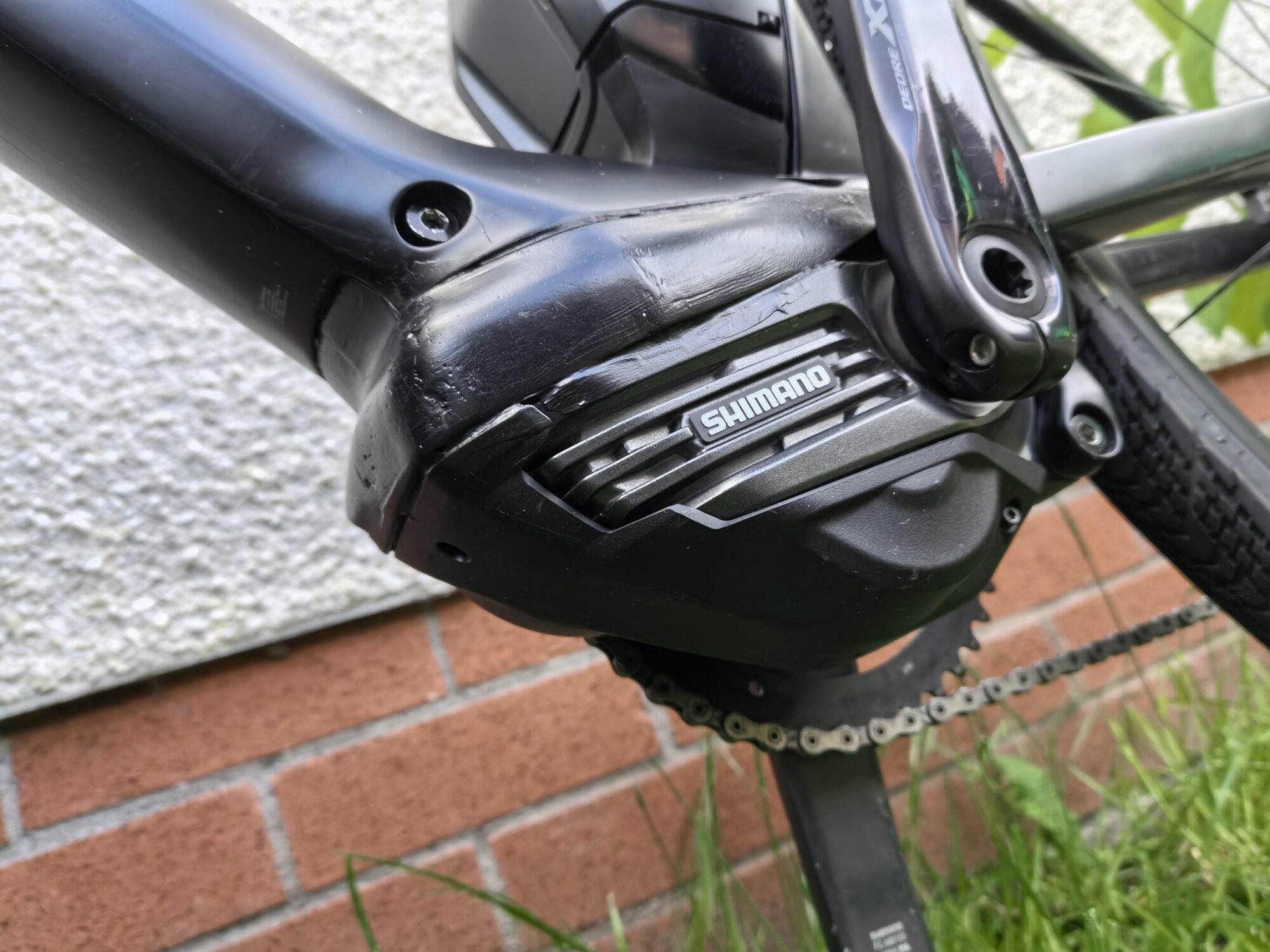

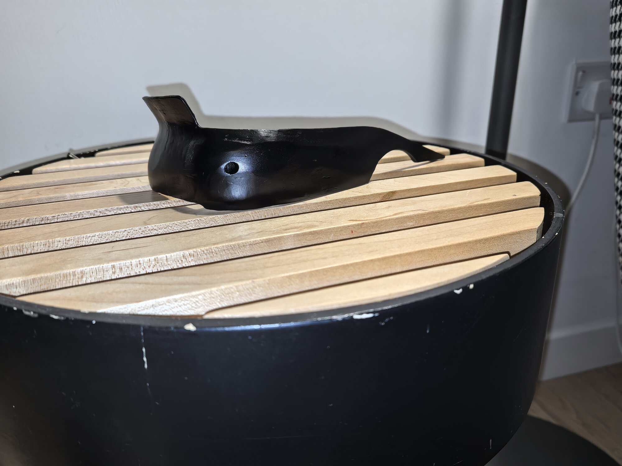

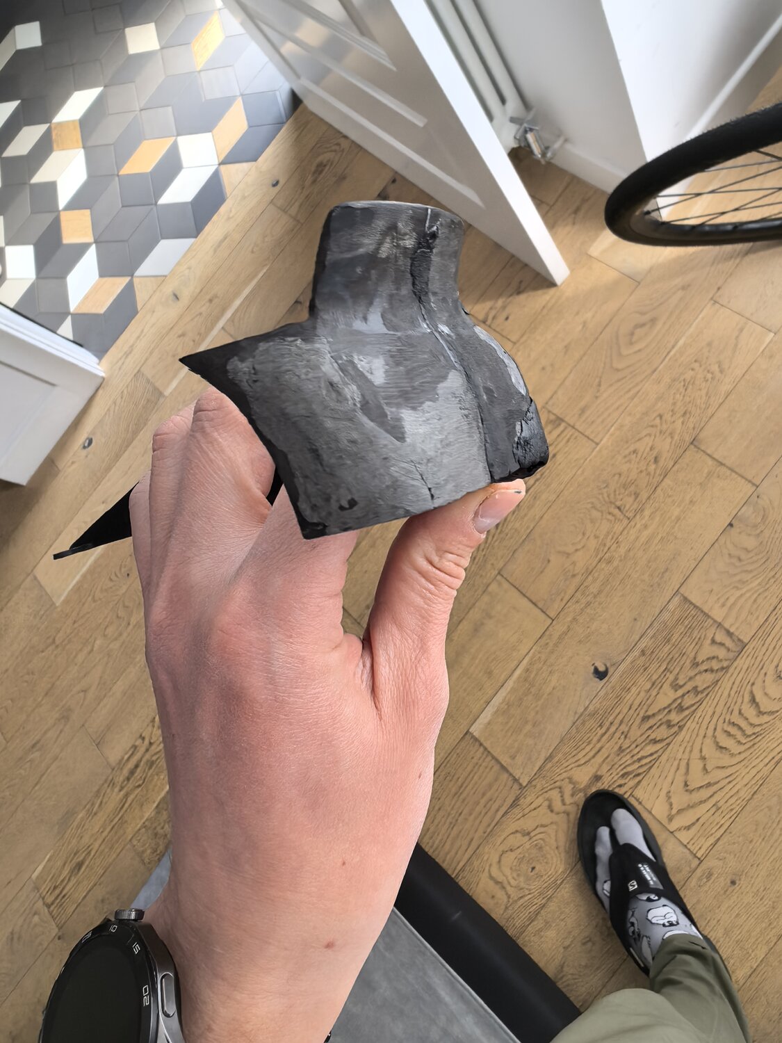

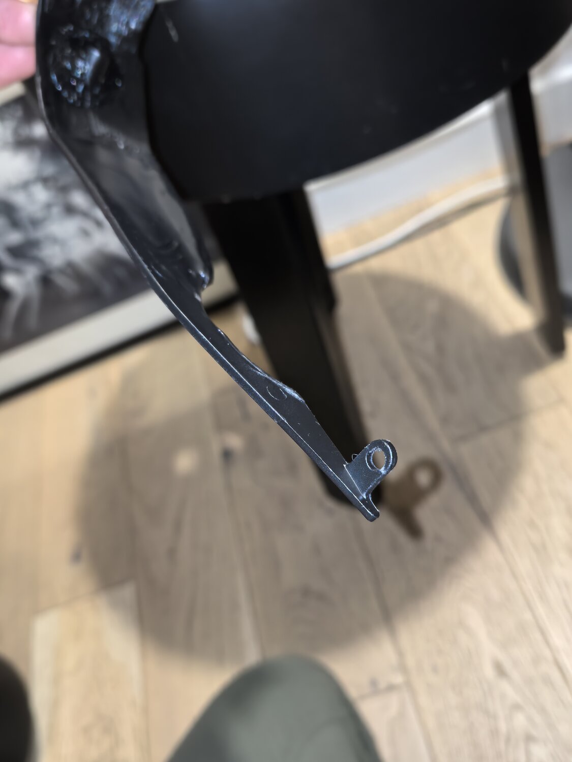

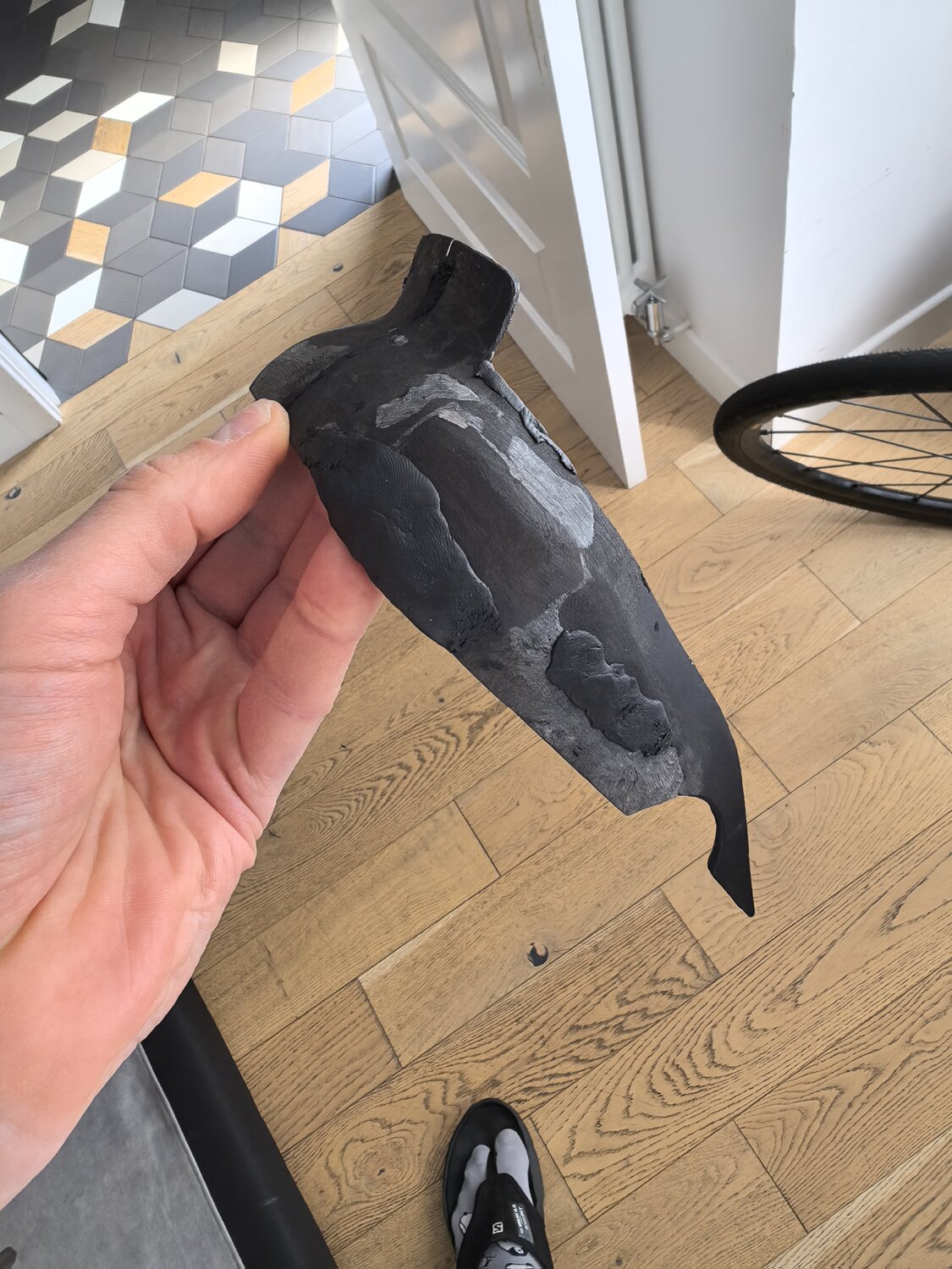

Currently modeling and sanding another motor cover that should look and fit much better when finished.

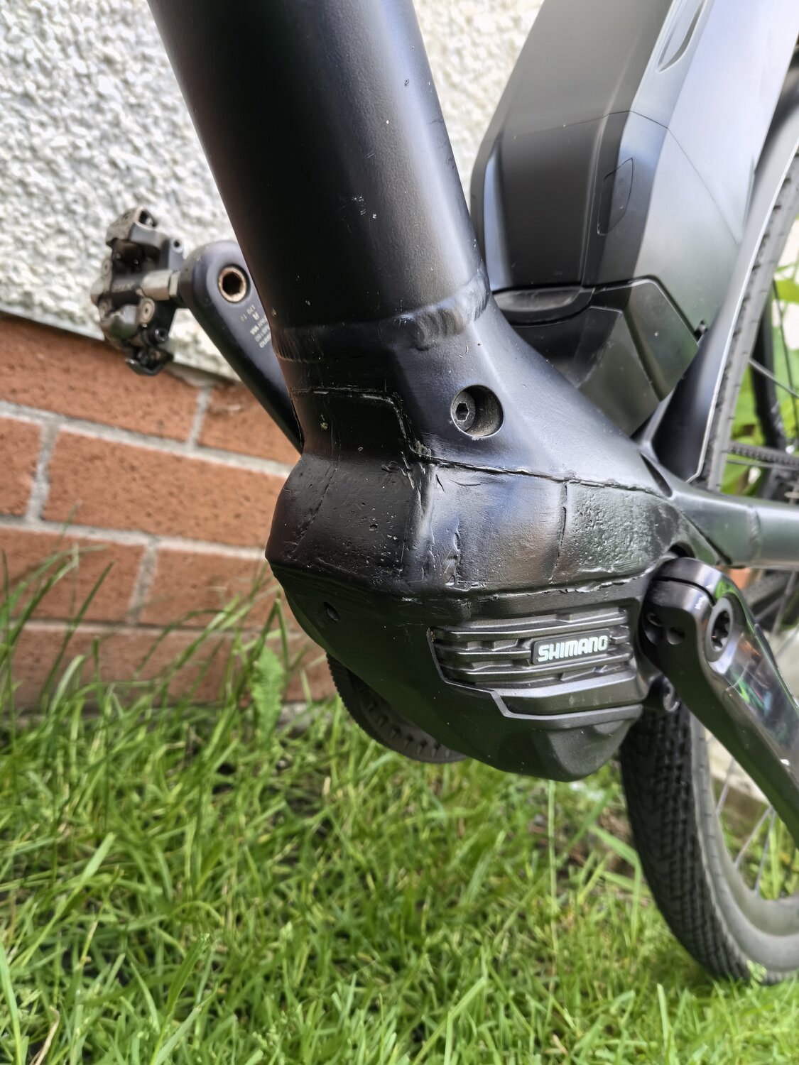

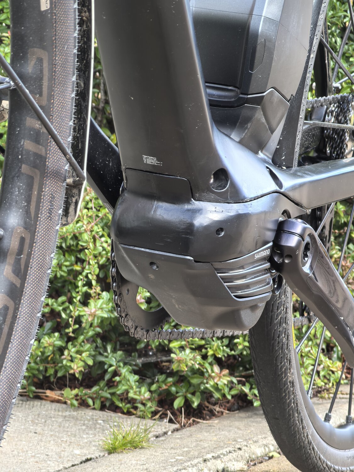

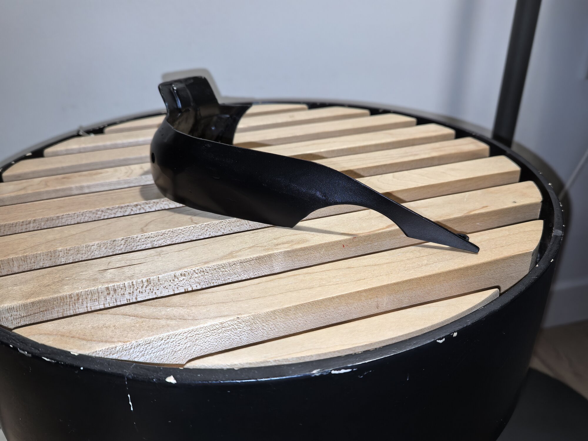

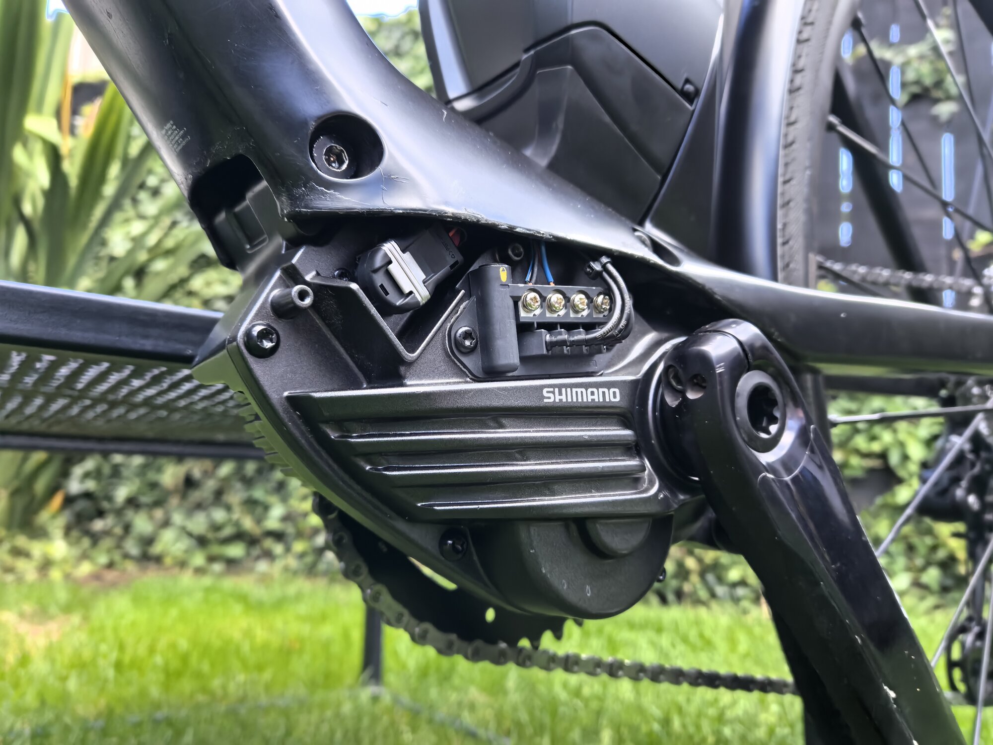

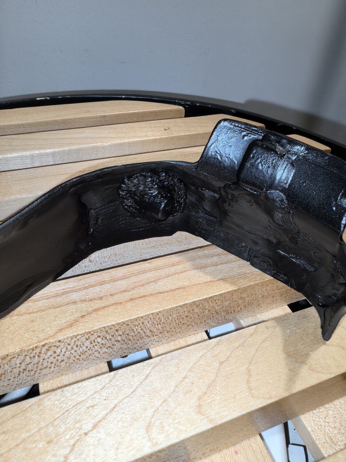

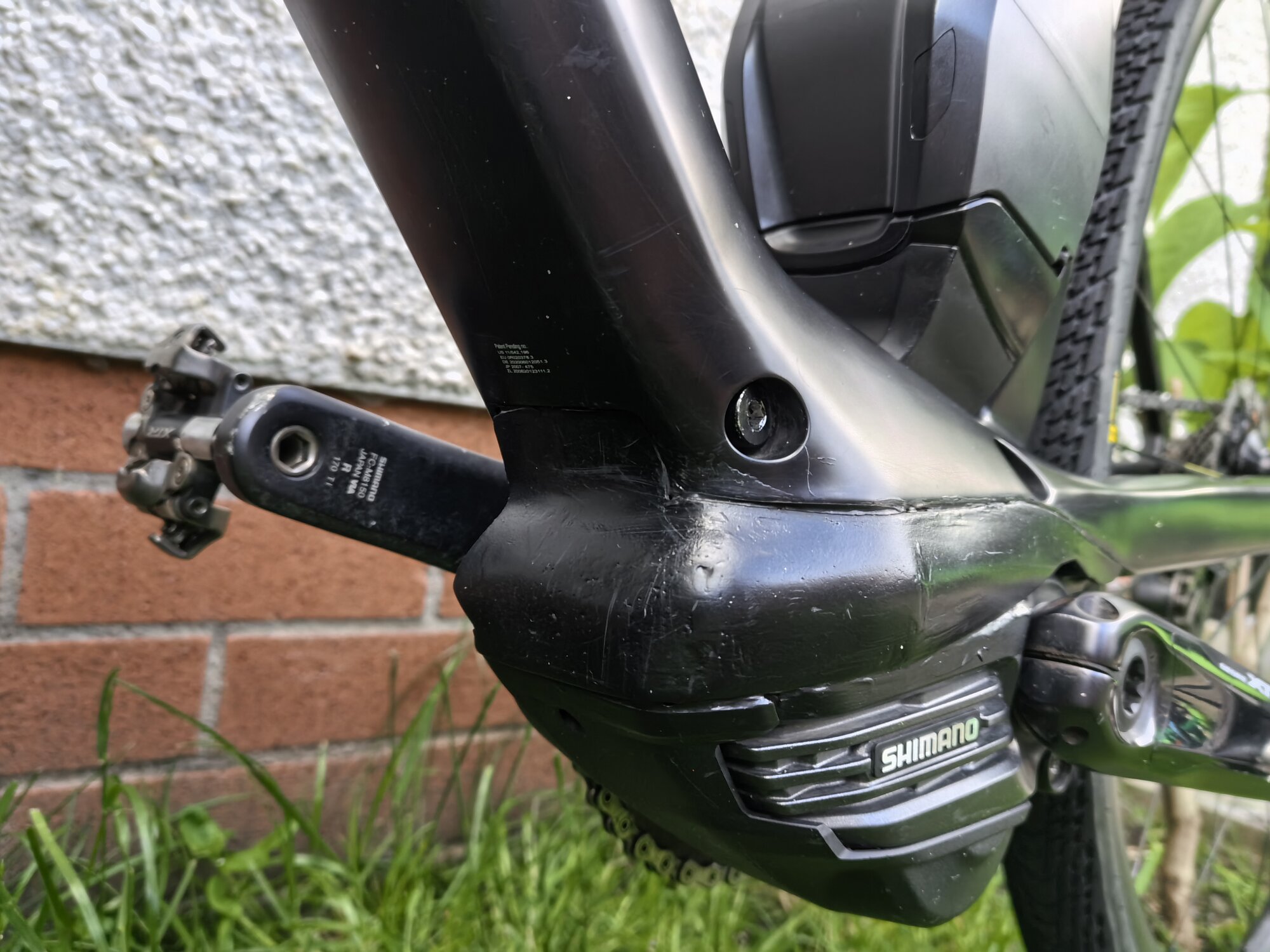

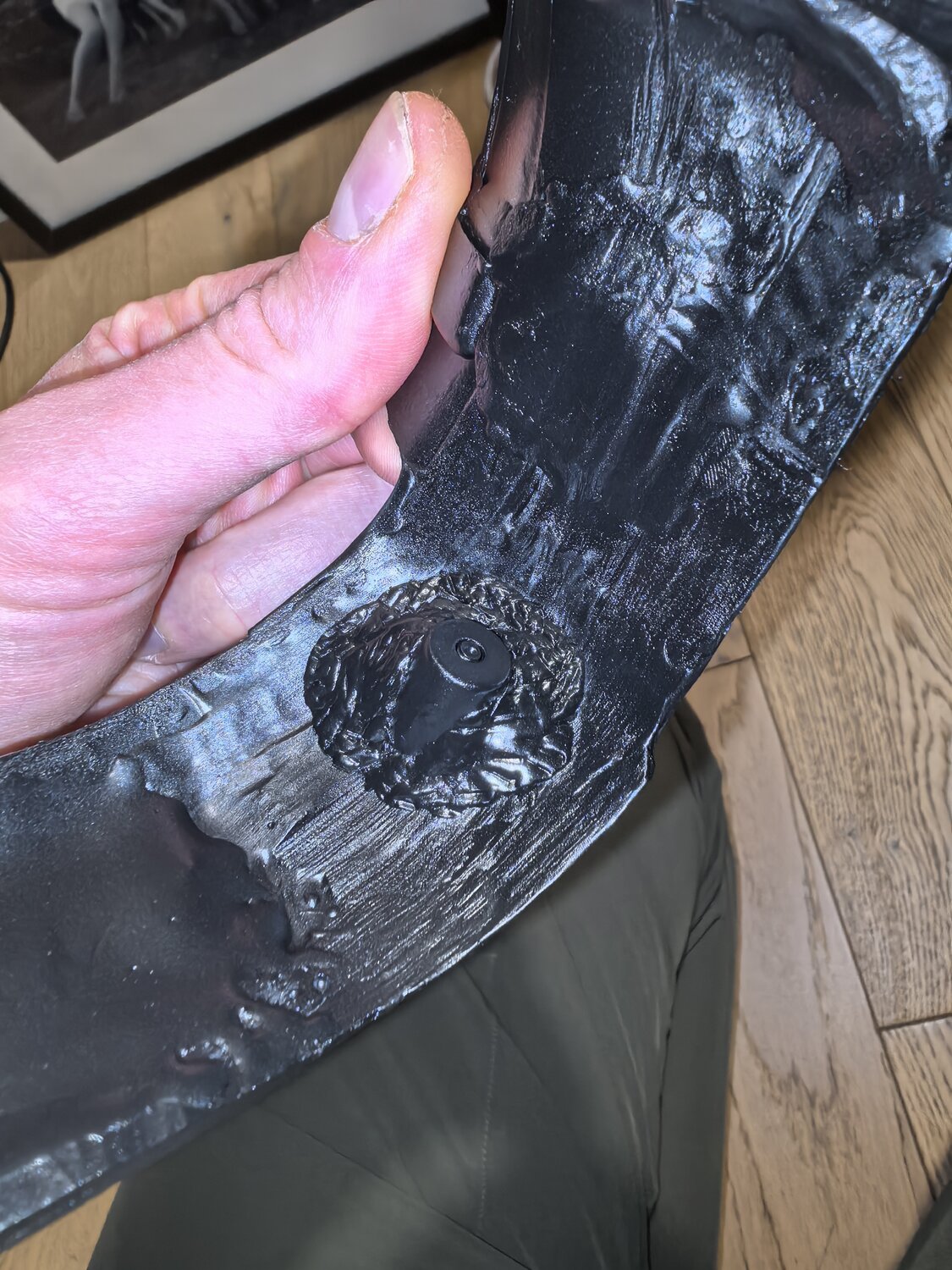

Managed to finish cover just now and painted it in Satin black finish.
This time it won't be glued on as it has two mounting points for bolts so motor and all connector points will be fully serviceble.
The base for this cover was originally BMC cover for DU-E8000 motor that was used on Alpenchallenge LTD models (search BMC motor cover kit 301669)
It was cut in several places and bend with heat gun. After that I used epoxy putty to file gaps and sand paper to finish.
Shimano DC-EP801 cover is used at the bottom.
