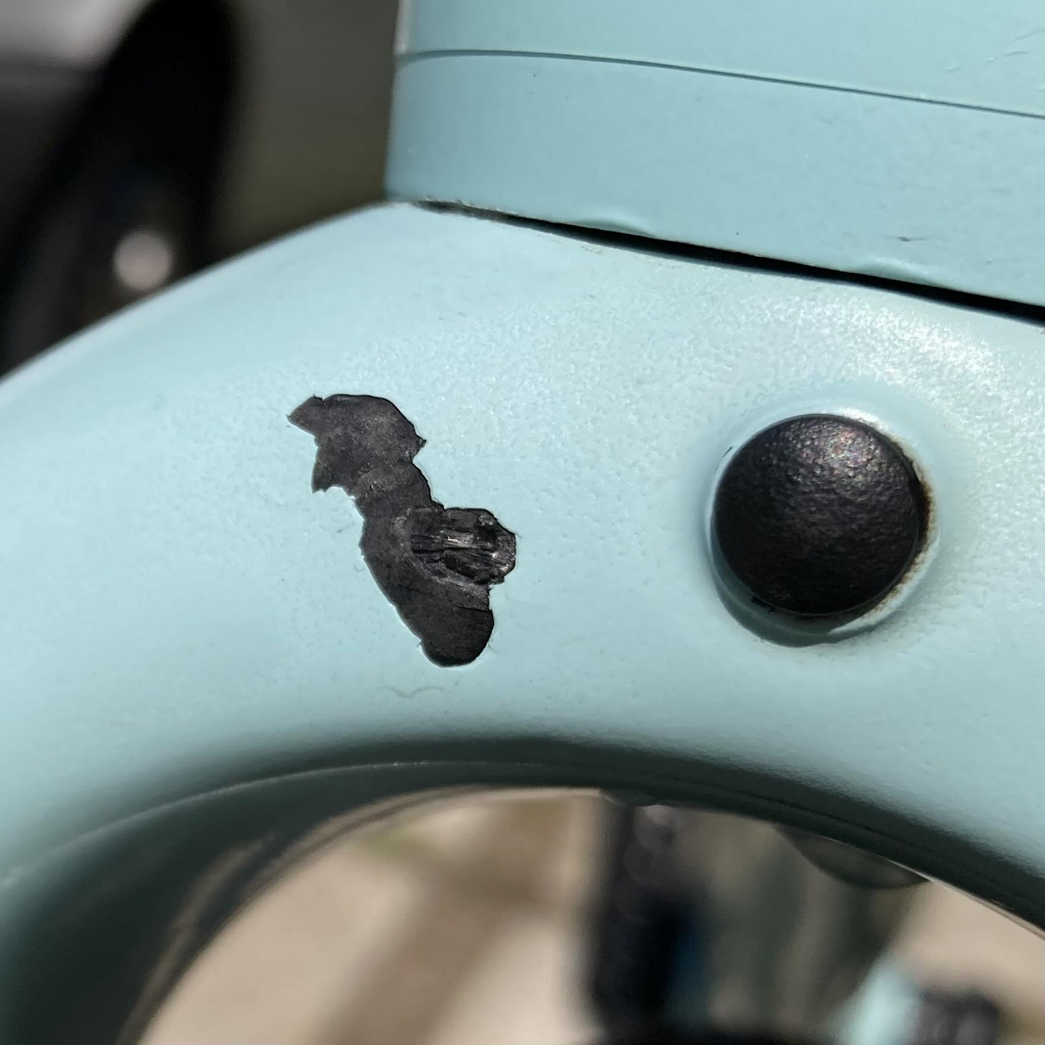

My brother has just got cured from his dream of a carbon fibre bike... The CF fork of his Marin DSX 3 got a hit by a pebble (ejected by a wheel of a preceding bike on a group ride).
It is not just the paint chip. The CF material got delaminated.
Yes you can fix it. Resin first, putty next, paint last.

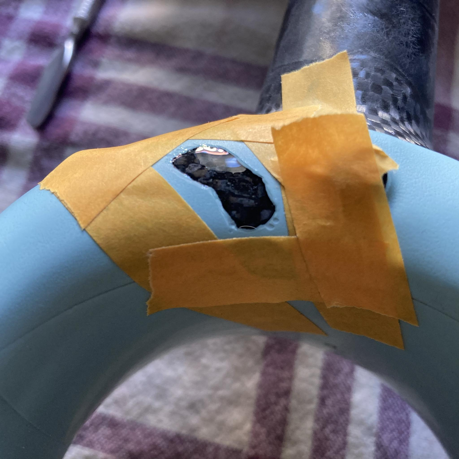

He simply did not expect a large stone being thrown by a neighbour rider's wheel at such a high velocity! (Jacek had protected his fork from behind with a 0.3 mm wrap because he thought the pebbles would be only thrown by his own wheel...) Besides, wrapping the fork crown is not that easy.

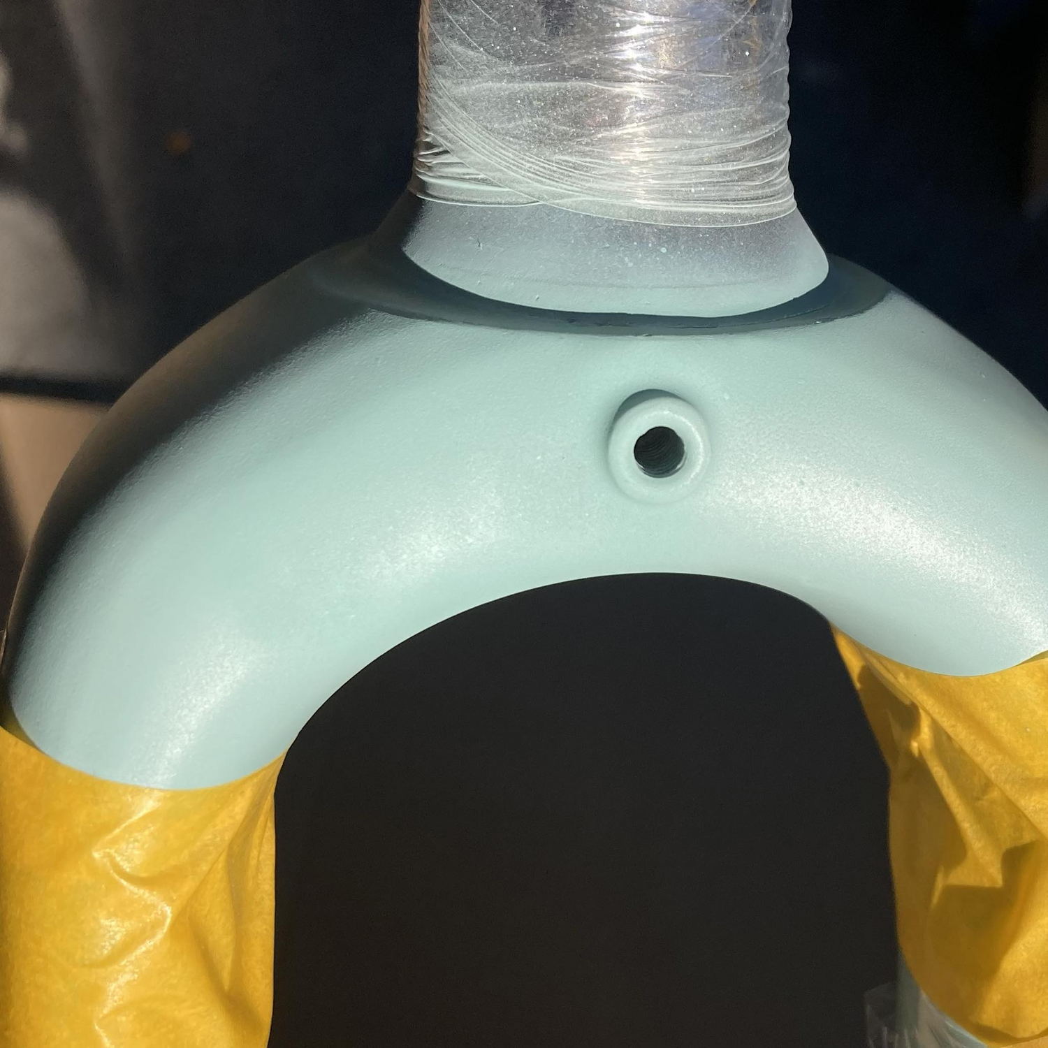

Now, he knows. He did a gorgeous work with resin, milling, putty, and now he could get colour matched paint. He will certainly think how to wrap the fork crown.
He says were it aluminium fork, he would only get the paint chip. However, carbon fibre got delaminated (forming a "hedgehog"), which made my brother lose his trust with the CF.
