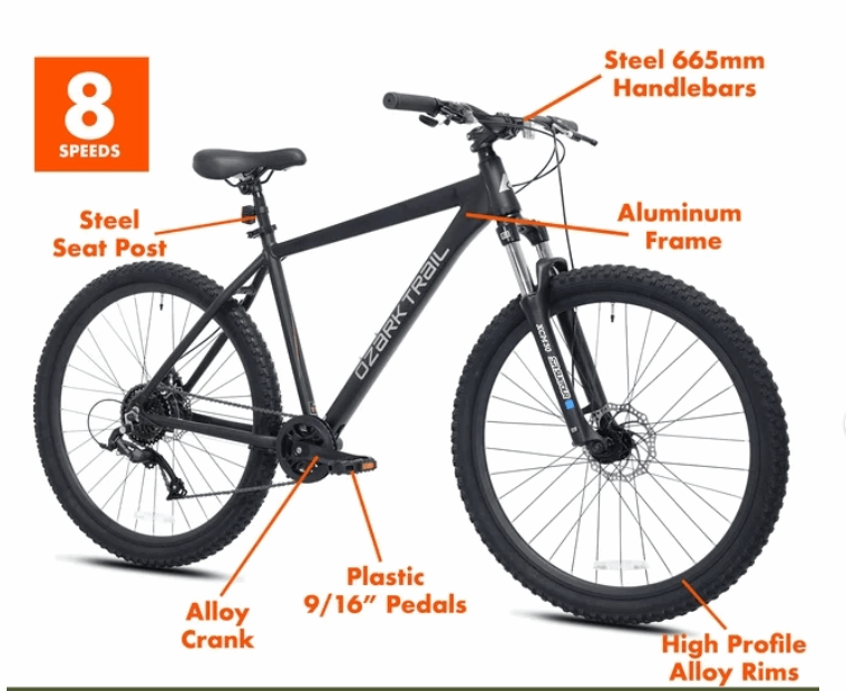

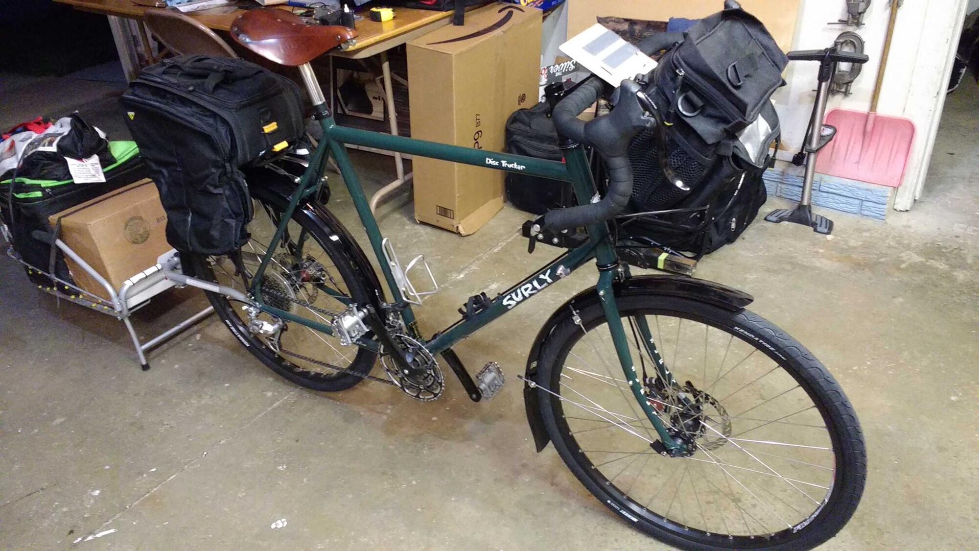

I'd like to know opinions which would be a better as a mid-motor 750w w/torque sensor commuter ebike conversion. A Surly 2012 26" Disc Trucker or an Ozark Trail Vibe 27.5" ($300).

I am not an expert at all, but you know the Surly has much better bones than the Walmart special. And I expect would be far easier to add fenders and rack to use as a commuter.
I've put motors on two Walmart bikes. While they're OK now, I wish I had started with a better bike, Ended up replacing everything on one, and almost everything on the other,

The Disc Trucker with its chromoly frame/fork is going to be a light-years-better bike than any Wal Mart Special. Hands down, no two ways about it. That is also a bike I would do a DIY build and have some hope of not needing a wheel rebuild. If you are using the factory-spec Novatec hubs then those should have a steel cassette body underneath, which is ONE of the important things you want for a survivable wheel build. Maybe enough to let them be and use them long term. The DT is after all meant to be something of a heavy hauler (tourer). The 68mm bottom bracket and straight down tube means you can fit ANY mid drive onto it, pretty much.
On wheel strength, yes on paper a 36H rim is better than a 32H, but 36H rims that are *quality* builds are few and far between. In fact they are very difficult to get built I have found, as there are 32H quality wheel builds always within easy reach, but the opposite is true of 36H. This has proven true so much that all of my cargo bike builds over the last few years have been 32H. BTW I weigh 235 now and used to be at 265. Add in to that cargo loads up to 100 lbs. 32H with proper rims, spokes and a good wheel build is going to be fine. What I'd call proper is say a SunRingle MTX39 and a DT Swiss 350 hub. Ideally a 350 Hybrid for its beefed up construction, solid 24 pt ratchet and steel cassette body. But I have built basic 350 Classics and upgraded to the steel cassette and with the factory 18 pt ratchet the hubs/wheels are plenty strong to take the beating a BBSxx hands out.
With all of that said, I think the DT has 36H wheels factory stock.

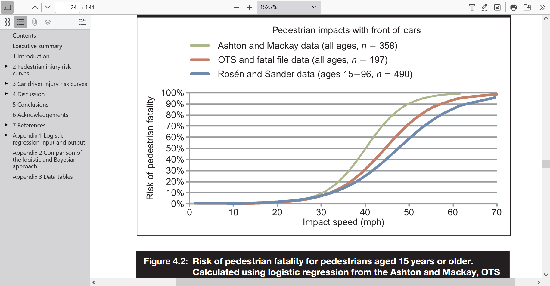

I am still holding off on the ToSeven so that the problems emerge and can be rectified with V2.1. I would be inclined to down tune the DM02 so that the bike parts hold up and the motor. It is common, and my case too when I started, for beginners to think that more is more. Eating up drivetrains every three weeks is fun but not for long. Crashing at over 24 doubles the risk of death and it makes crashing more likely. Even if you don't die that time, broken bones are no fun. I am not in a big rush to spend time in the ER. Russian roulette has a 1:6 chance, 17%, the same as death at 32 mph. Being a veg for life on tubes does not qualify as death.

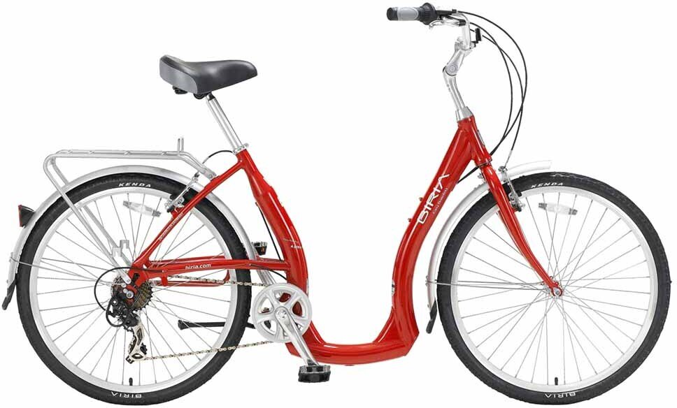

This is my next conversion for my wife, a Biria. They advertise it at 32 pounds. We're looking for easy dismount.
I have the bike delivered in the box, but I haven't opened it yet. They selll an e-version with front hubmotor and battery in the rear rack for $1999. I've already got motors and spare batteries sitting around already paid for so that's my plan. Probably use a rear drive motor, but if there is enough space between the rear tire and downtube, maybe a TSDZ2 mid drive will fit. I'd have to order one of those though,
Here's my wife's Biria easy boarding bike that I converted with a front hub motor a few years ago. My wife loves it. I'm pretty sure that a TSDZ2 won't fit but I've never tried.
