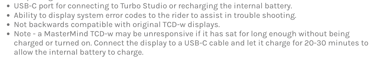

It kind of sounds like what they talk about in this TSB. It's intended for shops but there may be some useful info. It's in the manuals listings for Turbo Vado.
(Also since the charger plug connector is magnetic, check to make sure it didn't pick up some stray piece of metal.)
I think this was it. Not sure if this is possible but I had left a phone cable plugged in to the display over winter. Maybe it got wet and allowed the display battery to slowly drain.
I put battery pack on as per TSB for 20 mins and the display switched on. On a short ride the motor and display are performing as normal and the bike is now recharging.
Thanks Stefan and Alllan47 for your help.

I found the part number for the Mastermind.
S216800041ELE TCD-W 2, WIRED DISPLAY WITH REMOTEMasterMind TCD-w
And yes it does have a battery that can be recharged via the usb-c port. I wish I would have known this before taking it to the LBS.
