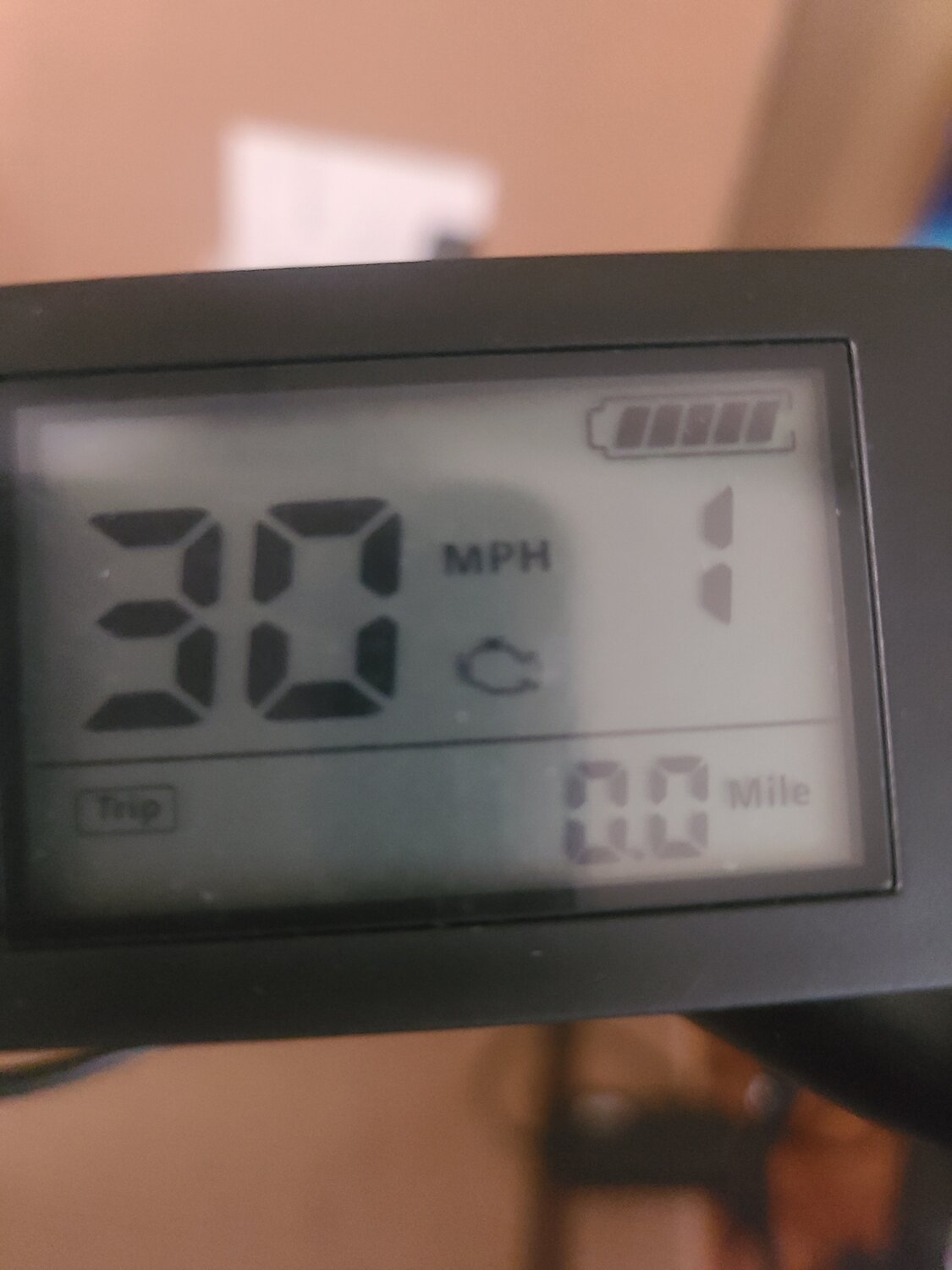

I'm back working on my bike and hoping for solutions. I've put the new display on from AR but it is not functioning properly (also shows a flashing motor icon). Have sent a video of the screen to AR to see if there are any settings to be changed. My display does not show the voltage other than to be sure it is set to the correct 48 volt. I have tried 2 different batteries with the same motor cutout result. Again, I am able to restart it immediately after
My battery is 12 Amp hours, 576 watt hours.
