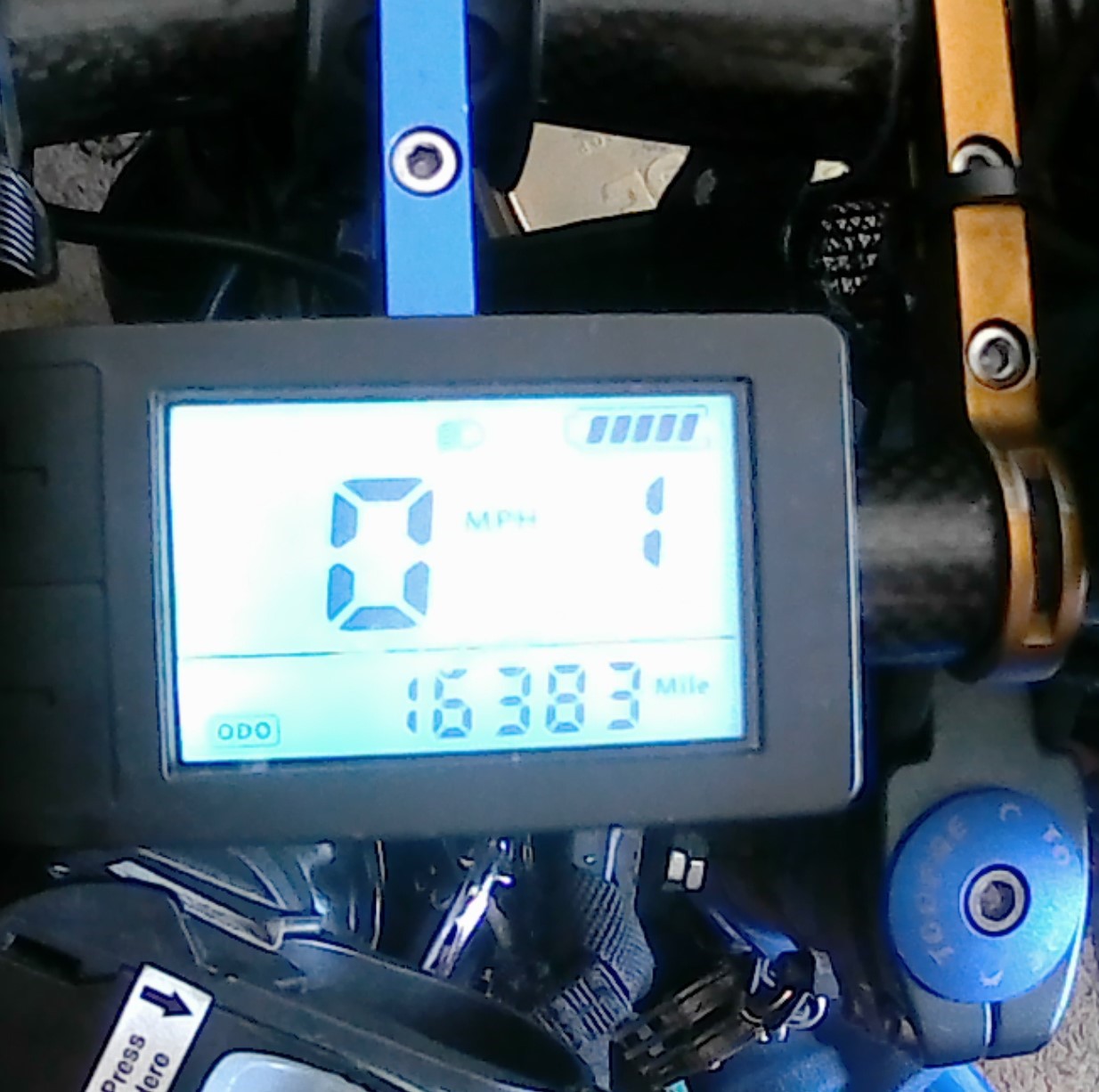

[#10] X52.. My 2021 X52 has major rear hub motor “grindage” at mile 16,383.
Sic Puppy
My 2021 X52 has major rear hub motor “grindage” at mile 16,383..
Here are the spec's for the 2021 model year (the 1st generation)ArielRider X52 rear hub motor:
Instead of nylon gears that are used in the rear hub motors of BaFang 750w or 1000w BLADE(model name) motors, ArielRider, back in 2021, made a very BIG DEAL about the unique metal-geared motor set-up during their advertising campaign. Of course, in 2022, they switched over to the (still currently in use) 1,000watt (peak output of 2,000watts) BAFANG BLADE nylon gear motor.
In regard to their “fabulous” metal gear motor, AR advertising never did even state the brand name. However, after some research I believe it to be the 1,000w/2,000w Peak Output Hengtai Geared Hub Motor. I have only been able to locate one other USA-based ebike company that uses this type/brand of motor so I cannot be 100%absolutely positive it is a Hengtai Geared Hub Motor. But, how many metal geared versions can there be out in ebike world?
In addition to my 2021 AR X52 ebeast, with its' 16,383miles, I also own these two magnificent rascals:
  1. 2018(year) M2S(brand) KUSH (model-- now called 750FS). This dual-suspension fat tire ebike has the famous BaFang 750watt/1,200w peak rear hub. This ebike has 22,000 miles of absolutely PROBLEM-FREE motor issues. It still runs like a scalded doggie.
  2. 2019(year) M2S(brand) R750(model). This ebike is a carbon copy of the aforementioned M2S ebike with the exception of it being a front suspension-only version. It currently has 15,250 miles of absolutely PROBLEM-FREE motor issues. It, too, still runs like a scalded doggie.
  3. Well, I have always wondered just how many miles these rear hub motors would last until the motor started to go into “stupid” mode. Now, at least for one brand (ArielRider), and its friggin' metal gear motor, I know: 16,383.
  4. I headed out for a ride on the AR X52 this morning and was greeted by a very disconcerting groveling noise in my rear wheel area. At first I thought that maybe a stick, or a piece of wire, etc. had become entangled in the cassette gear. No such luck. Luckily, I was near a large vacant parking lot so I embarked on a mission of “what the#$%^&”. It's readily apparent that this motor was having issues. Before I continue, I need to convey to you, the reader, that I am a 72 year old “cruiser” who loves to pedal. My mission on my daily 50 mile ebike rides is Maximum miles/Minimum turbo assist. If I ever exceed 28mph, it is seldom for more than 30 seconds total, and then it will most likely be a downhill section. Putt-Putt PizzaHut, that's me.
ShitFire..So, noise-wise, here we go.
It is readily apparent that this motor was/is having issues. Sadly, the rocks-in-a-can noise only broadcast itself when I was actually pedaling. If I just coasted along, the noise, while still there, was hardly noticeable. But, if I pressed the thumb throttle or pedaled, I was greeted by a vicious (and very metallic) grinding-type noise. So, back to the condo.

ShitFire. It looks like Sic Puppy is going to delve into the world of tear down/build back up motor overhaul.
I have never had to deal with getting into the internals of a rear hub motor. Luckily, YouTube has numerous videos that can/will assist me. Hopefully, applying copious amounts of waterproof axle grease will be the remedy for said rocks/gravel noise. If that doesn't solve the issue then I am in for a real pickle of a situation.
There is no way in hell that I'll use another off-brand metal gear motor unit. That means going to the BaFang 1000w nylon gear. Assuming, of course that it will even be able to be accommodated by the current outer housing shell. That means a cost of $150 to $200. And then, even if it does work, I will need to buy a new controller module box AND a new computer display unit (that's the display on your handlebar) Jack Cecil(the company) sells the coupled pair for around $500.00.. Ouch!! Not gonna happen.
I'm in no big hurry to commence this ordeal, however, once its been handled, I will add an UPDATE to this thread title.
