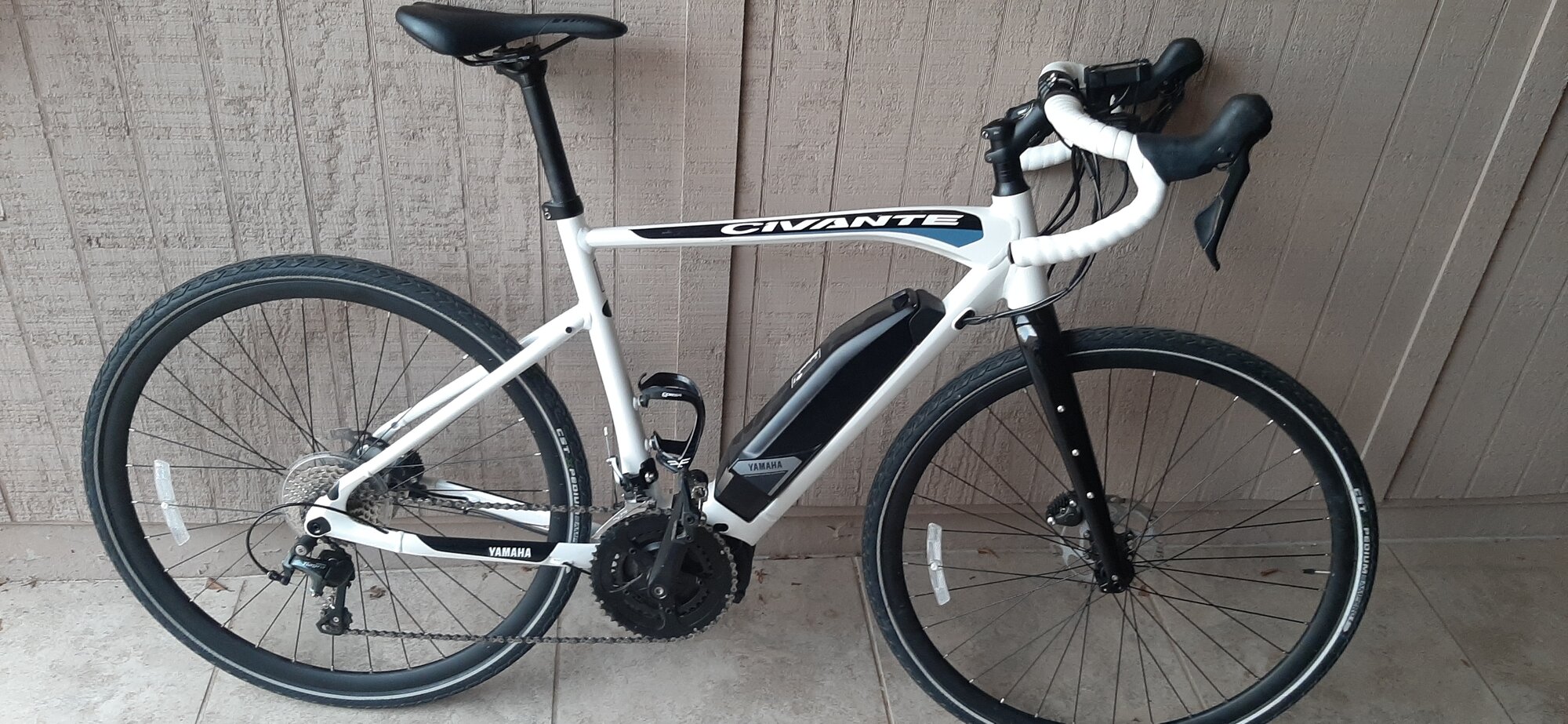

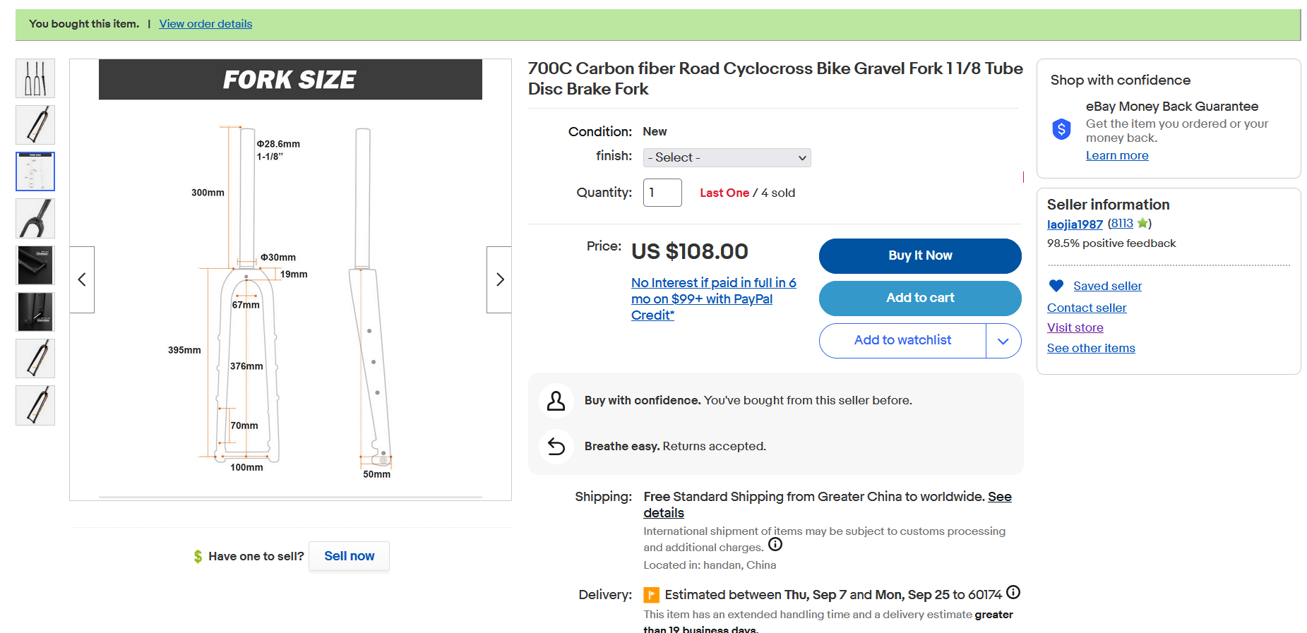

I swapped out my Civante fork to a carbon fork. Info on what you need. Stock fork is 11/8 taper to 11/4 size which is not common size head tube. I wanted a fork with replaceable crown race. I found one on ebay that is 11/8 straight. Sure there are also pricy ones from Whiskey or Ritchey ect.
1) Fork

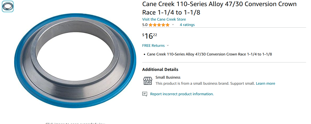

2) Crane Creek 110 series alloy 47 30 conversion crown race

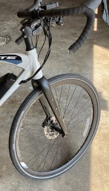

Fork replacement complete. Creaking noise completely gone. Some satisfaction is resolving the problem, but still angry with Yamaha for burying a known production issue. If they were selling thousands of these bikes (instead of hundreds), a recall would have been certain.

1) Fork

I love my new carbon fork. The annoying cracking sound is gone. The bike rides a smidge smoother and the fork is about 450 grams lighter than the original, so it saves 1 pound in weight. I have dropped 4 to 5 pounds on the bike through various upgrades of carbon parts, lighter chain and cassette (it remains to be seen if the chain and cassette hold up).
