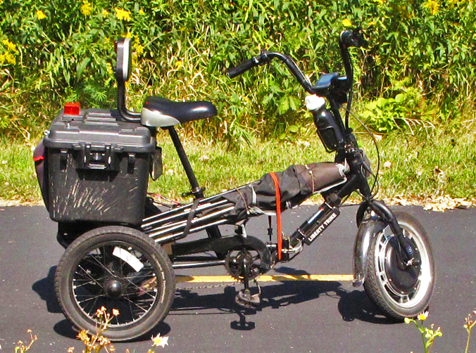

I'm NOT a tinker-er, but I did see your warning on that above! I'd love to find a Thudbuster or similar, but the Liberty takes a size that hasn't been made since like...the 90s. So the elastopolymers are all shot. The Rad has a more normal size for upgrading to a Thudbuster (or alternative). I've settled on a cheesy $30 suspension seatpost for now, which does help, but I need more to go further.
The Liberty Trike also has teeny tiny short cranks, which make it hard for me, as a large person, to pedal. I measured and found that the cranks on the Rad are 40mm longer. Feels vastly better.
Use the pedals for ghost pedaling exercise or at speed 3 for some mild pedal assist exercise. Also added pedal extensions for my size 11 so as not to hit heel on frame.
You never mentioned whether you NOW actually appreciate the quiet ride of your Rad trike over the noise of a motorcycle engine? Almost bought a IC scooter 5 yrs ago, but by accident more than planned tried out a Liberty Trike that the bike shop had just received for a client in his 80s. Was allowed to try it out and fell in love at first sight and ride. So ordered one direct from Jason Kraft.
Once retired and now 79, am no longer in a hurry to get anywhere. Enjoy taking my time at a slower pace (10-12mph or even 8mph). Didn't know if i could get along without a car, but after 4 years and 6,350 miles on my LT don't miss not having 4 wheels, insurance, maintenance and other drivers not paying attention. Always got a certain satifaction doing my own maintenace. Even body work on my used 70 Thunderbird and rebuilding the engine of my used 1998 Honda Civic ... besides all the other required upkeep and preventive maintenance.
Now enjoying the Good Life with a few hobbies like designing, building and monitoring my bluebird nest boxes along my 6 mile bluebird trail. Also designed and built my own 36v 30Q experimental battery for backup and extra capacity range for my LT.

Weigh 210lbs, 6ft.
Yes, there are times i wish it's top speed was 15mph so i could cruise at 10-12mph on smooth urban paths when at 3 bars and just 2 bars. Also wish it was 12s with 25amp Controller instead of 20A for hill climbing.
EDIT: Also made adjustments and a few modifications so my LT is as quiet as quiet can be
