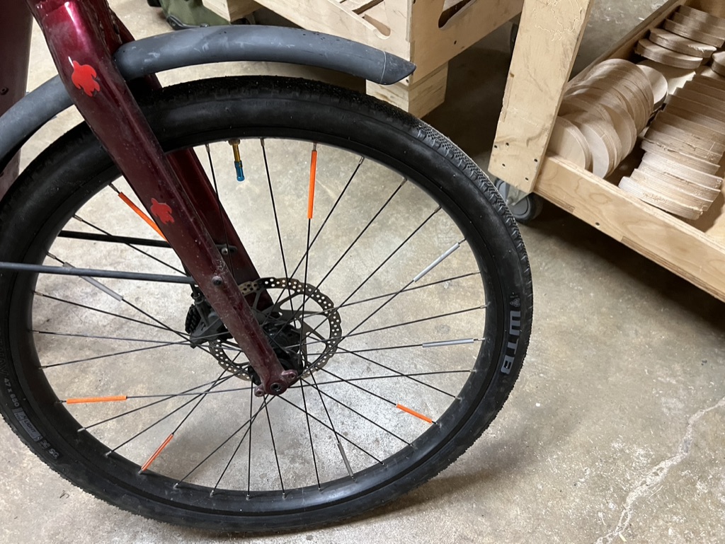

this guy. a little stiffer then the last ones as its thicker casing is about as thin. I could get it on with hands only. not such a balloon tire I can run it at 45 psi in front and 40 in back. but should not puncture as easily. seems about the same on speed.

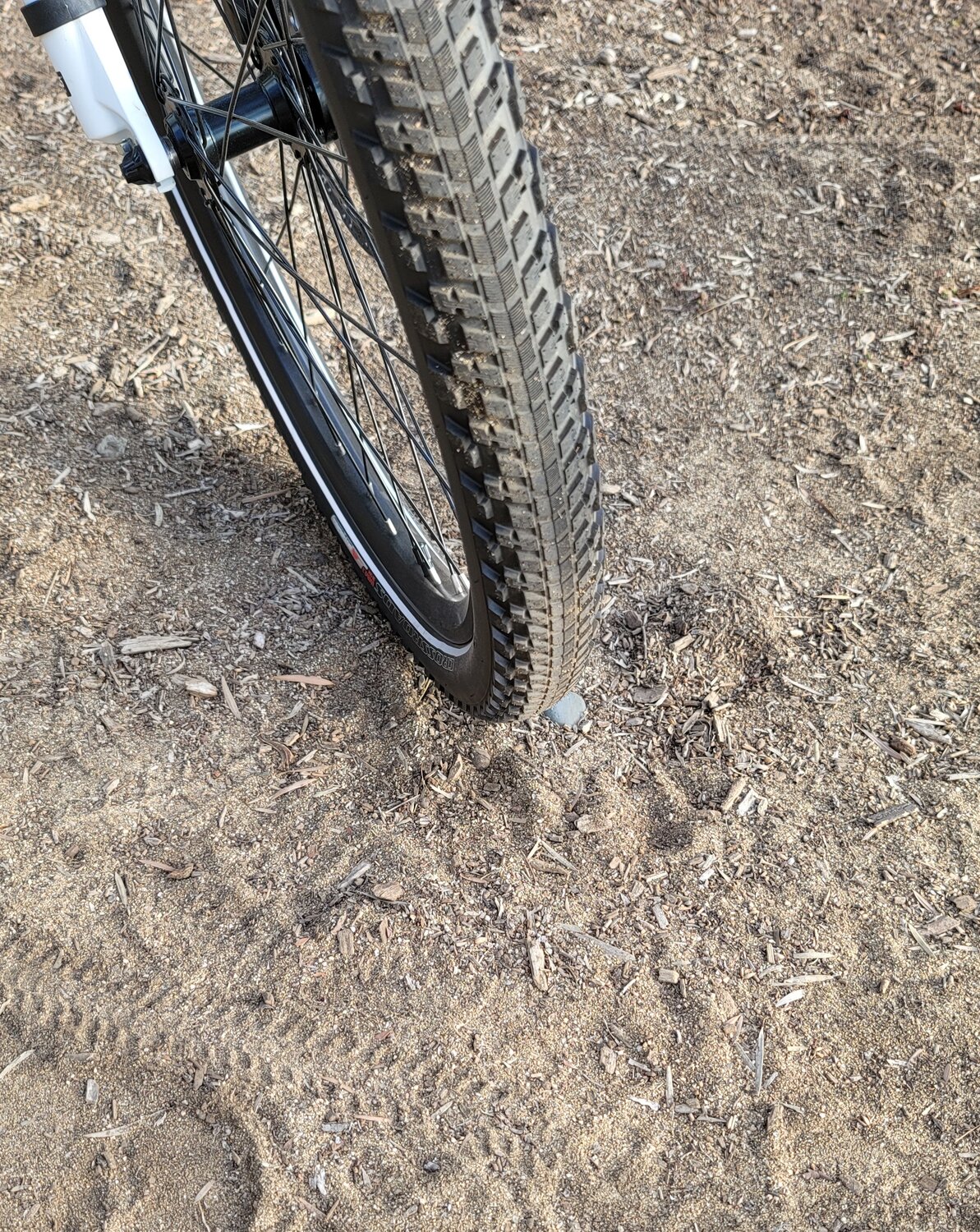

I'm a big fan of hybrid treads like the ones on your Rubans. Below is the 27.5 x 2.3" Specialized Crossroads Armadillo I'm running now.
Sure, there's some added rolling resistance on pavement, but small price to pay for the versatility and totally unnoticeable at PAS 1/9.
Addendum: This tire made that tread mark in the dirt. The side knobs are fully engaged on soft surfaces.

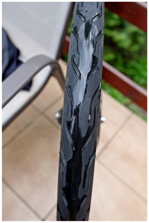

A Specialized Electrak 2.0 (29x2.0"). An extremely fast and surprisingly grippy tyre (thanks to the Gripton component owned by Specialized).

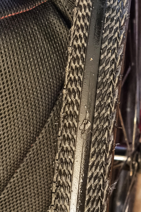

Specialized Pathfinder Pro 2Bliss (38-622). In my opinion, the ultimate gravel tyre. See the strip of smooth rubber in the centre of the tread. (Also a Gripton tyre).

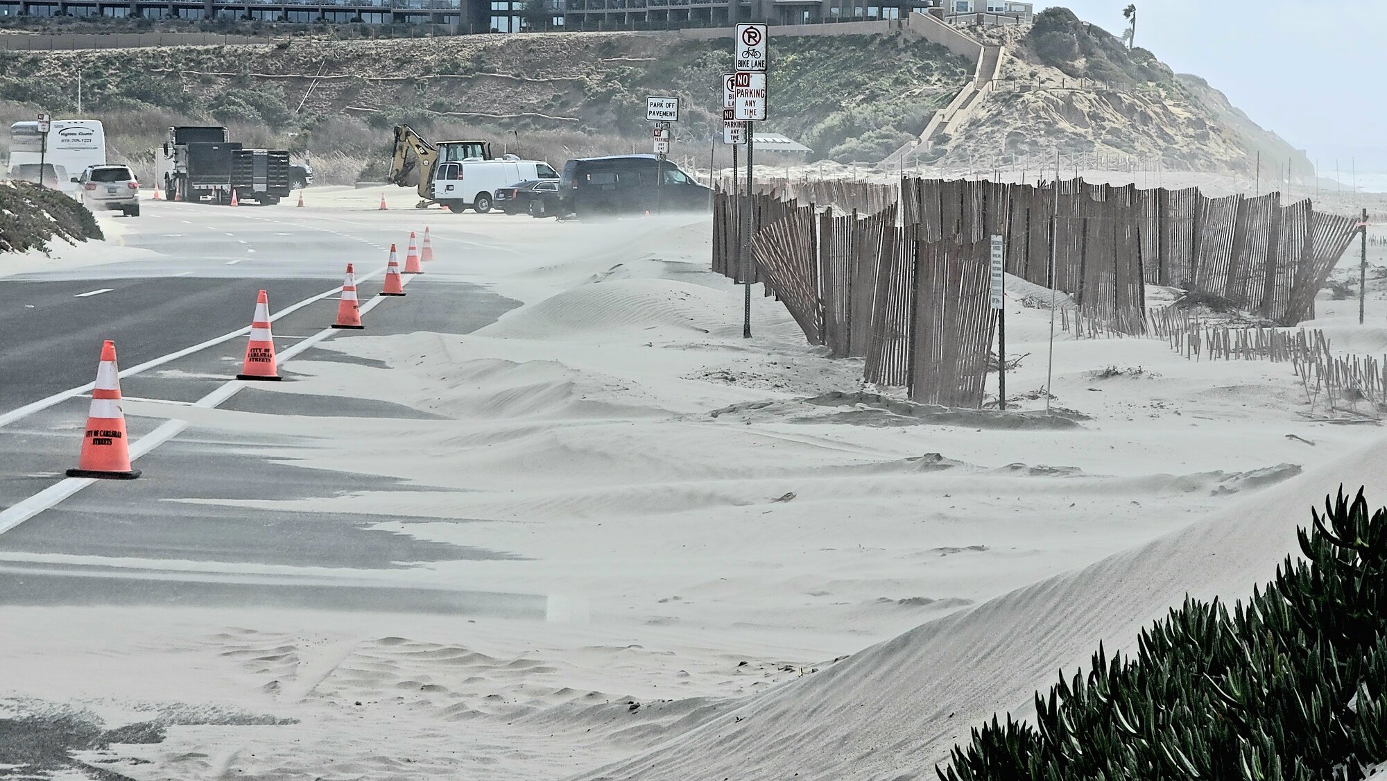

Sand finds its way into and onto everything in a SoCal beach town. How would those tires do in, say, 3" of sand on a hard base? Common occurrence around here — even on the roads at times...
No positive experience on riding in deep sand here Jeremy. Regarding shallow sand, we have enough of it in the post-glacial Mazovia. My tyres were doing alright there. Not that I had to ride for miles in the sand 🤣
