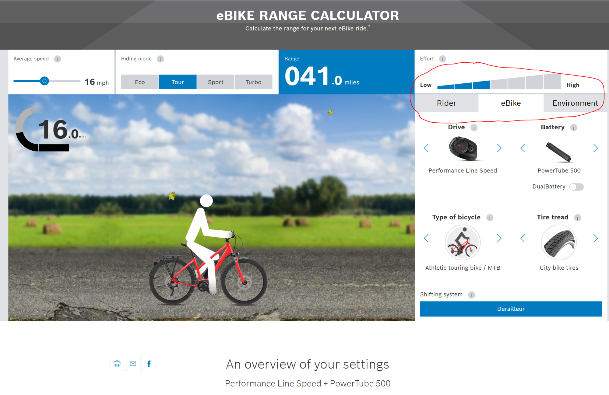

These are realistic numbers because we have seen outrageous claims on the market. The Bosch Range Estimator tool offers very precise range numbers.
As you can see below, you can set all the precise parameters like the motor + battery combination, road conditions, riding style, average speed, cadence etc.
So, 41 miles using a 500Whr powertube and at 16mpgh average speed.
