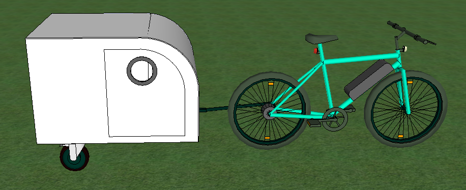

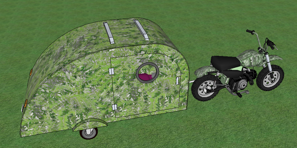

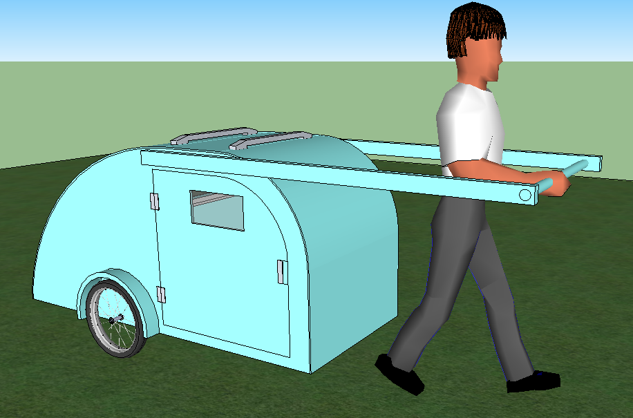

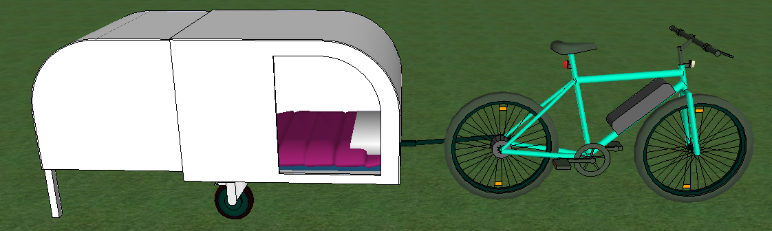

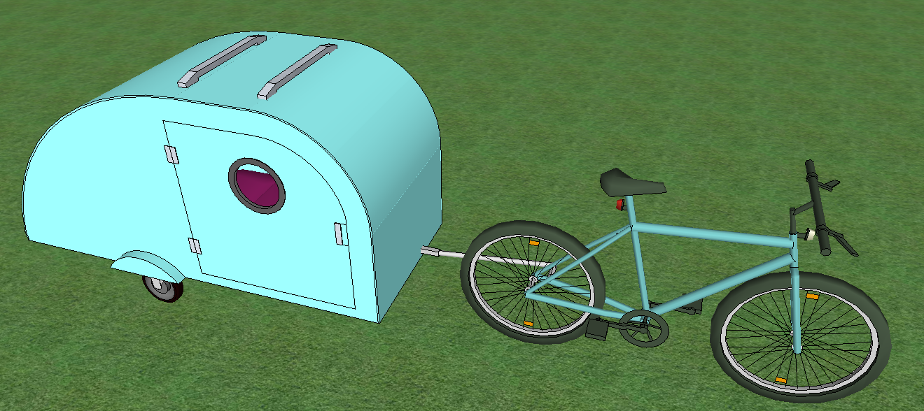

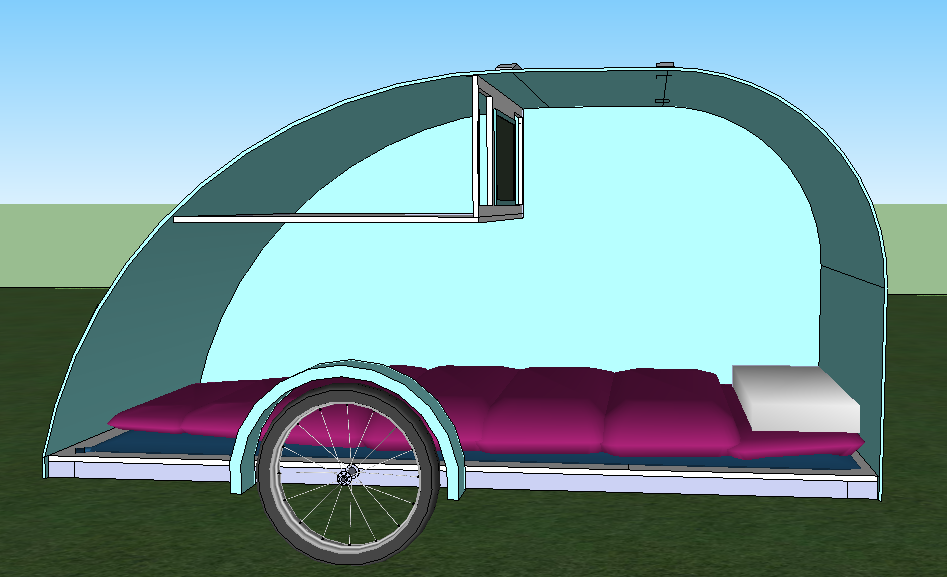

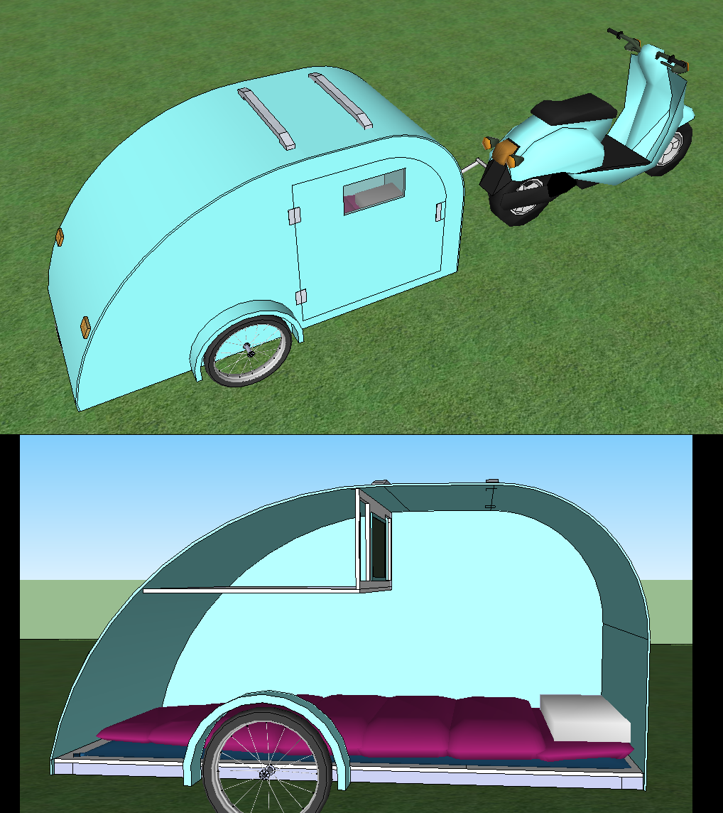

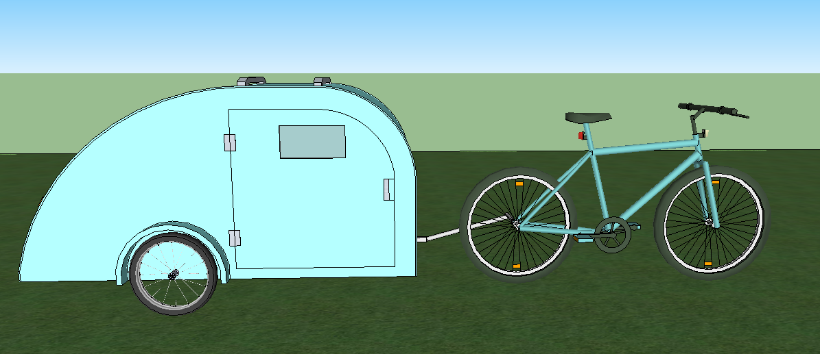

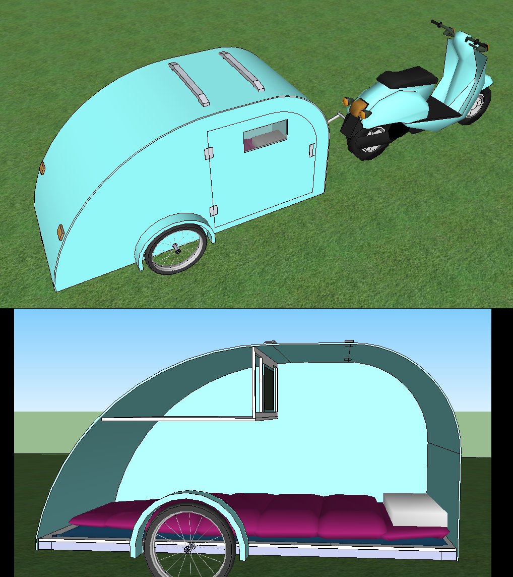

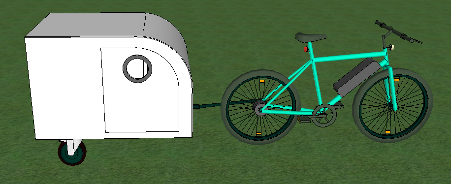

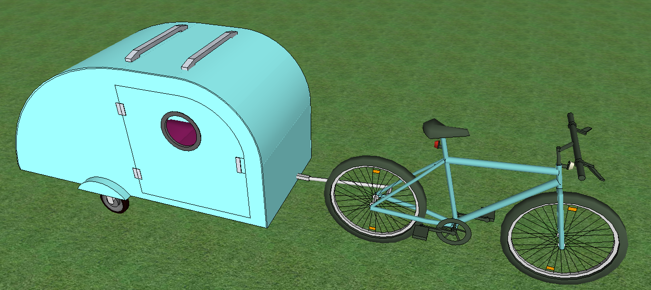

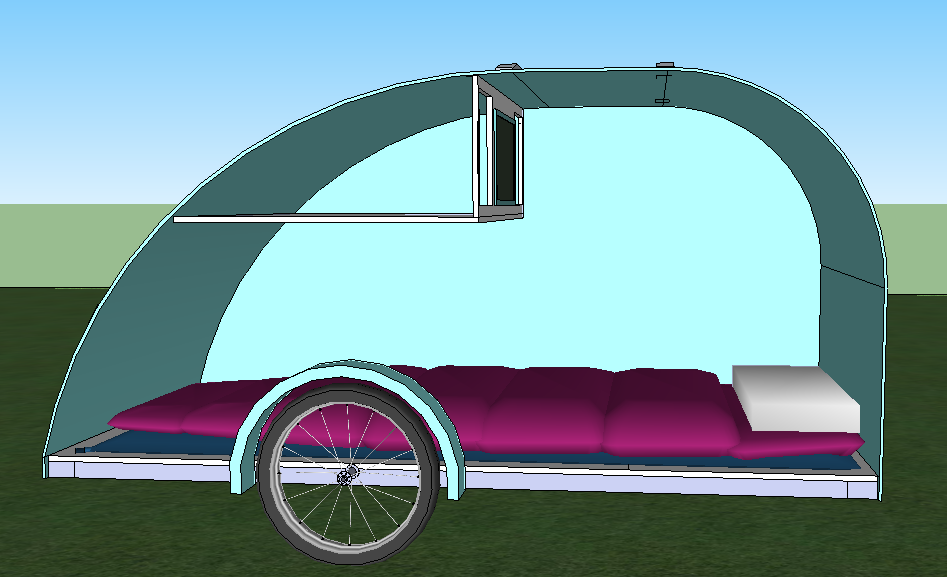

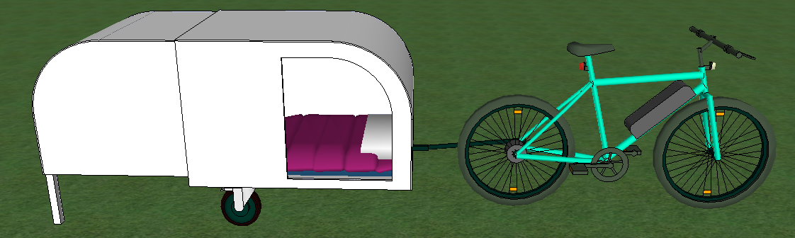

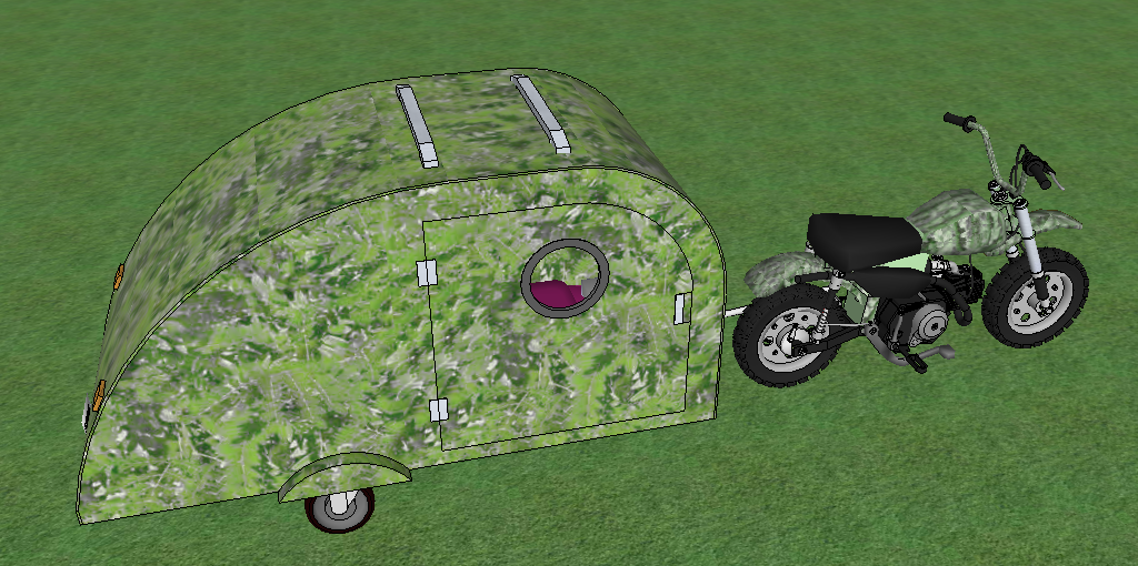

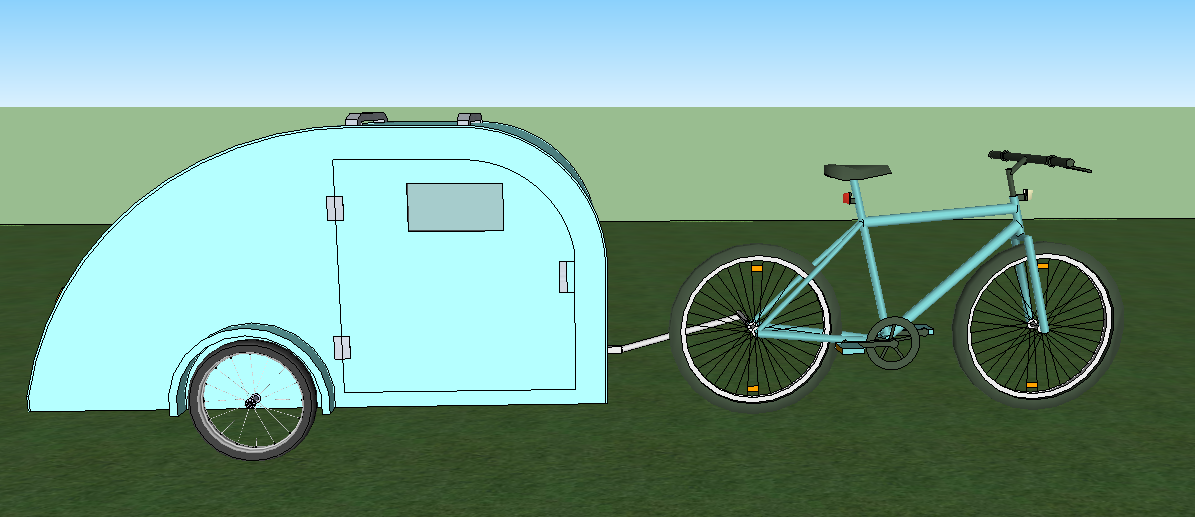

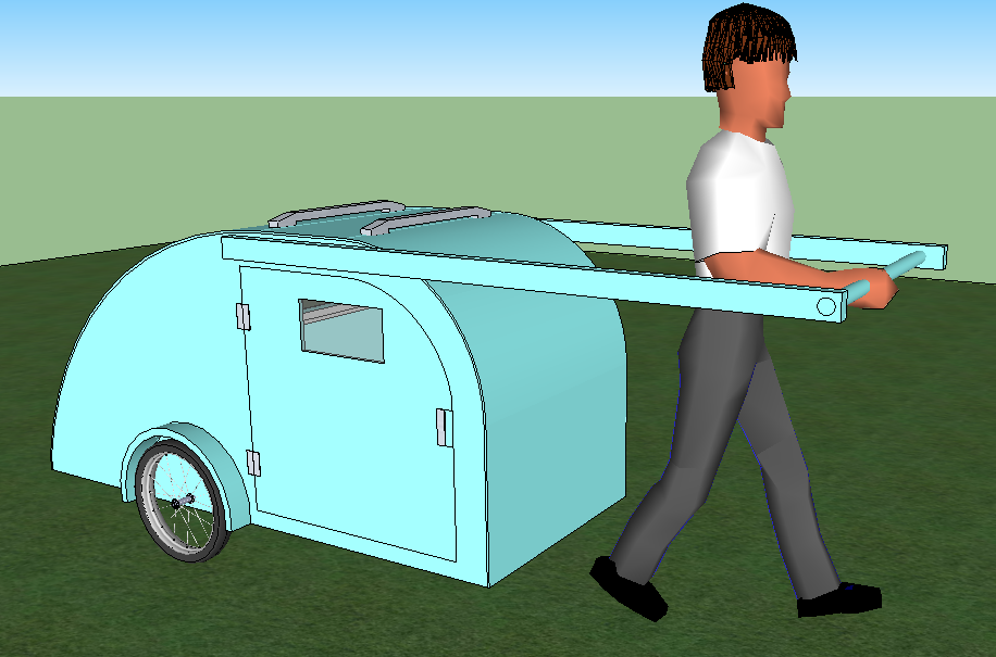

Hi Jason, I have designed a few bike campers that have been built by other people so here are those for ideas: Some use caster wheels instead of bike wheels for more weight.
View attachment 130621View attachment 130622View attachment 130623View attachment 130624View attachment 130625View attachment 130626View attachment 130627View attachment 130629
I'd probably go with design tried by some of the cruiser site of using modified canoe. Large wheels from cruisers front wheels and can have optional brakes. But it's so streamlined, almost zero resistance.
unlike blunt front end, that can be huge resistance, and a major issue if against the wind. Interior standard seating is bunk level, and a lot of gear stored below bunk area. Remove towing bar, it's still a canoe down the river. A stand up tent handy
for changing clothes or optional sleeping and day storage. Hooks on tent for hanging solar panels high off the ground. My tent was heavy with the carbon fiber poles in external slots then flex from corner to corner.
Its a strong tent, but bagged up heavy as heck, maybe 60lbs. The poles about 3ft long have metal coupler to add next rod section, repeated till about 12ft long. That type. If it gets loose in wind storm,, it's one huge ball filled with military cots with pointed feet and everything else punching holes through tent every revolution. I never used so many patch kits in my life all at once. And there's two layers to patch.

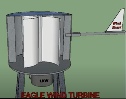

I designed an EV car with a hood that had small VAWT wind turbines attached to generators (under the hood) and wind scoops that block the wind so it only hit one side.
Used for slowing and braking to regenerate power for the battery.
Based on this same design:

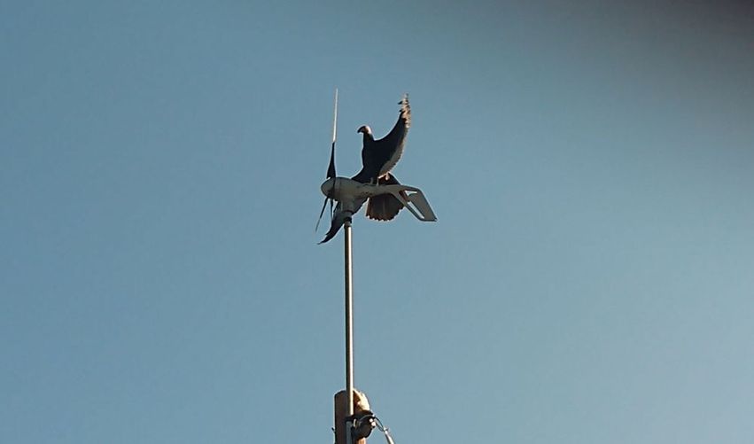

I have a wind turbine at my off grid cabin we don't get enough wind for it to produce much. Solar is much better but the buzzards seem to enjoy the turbine.
