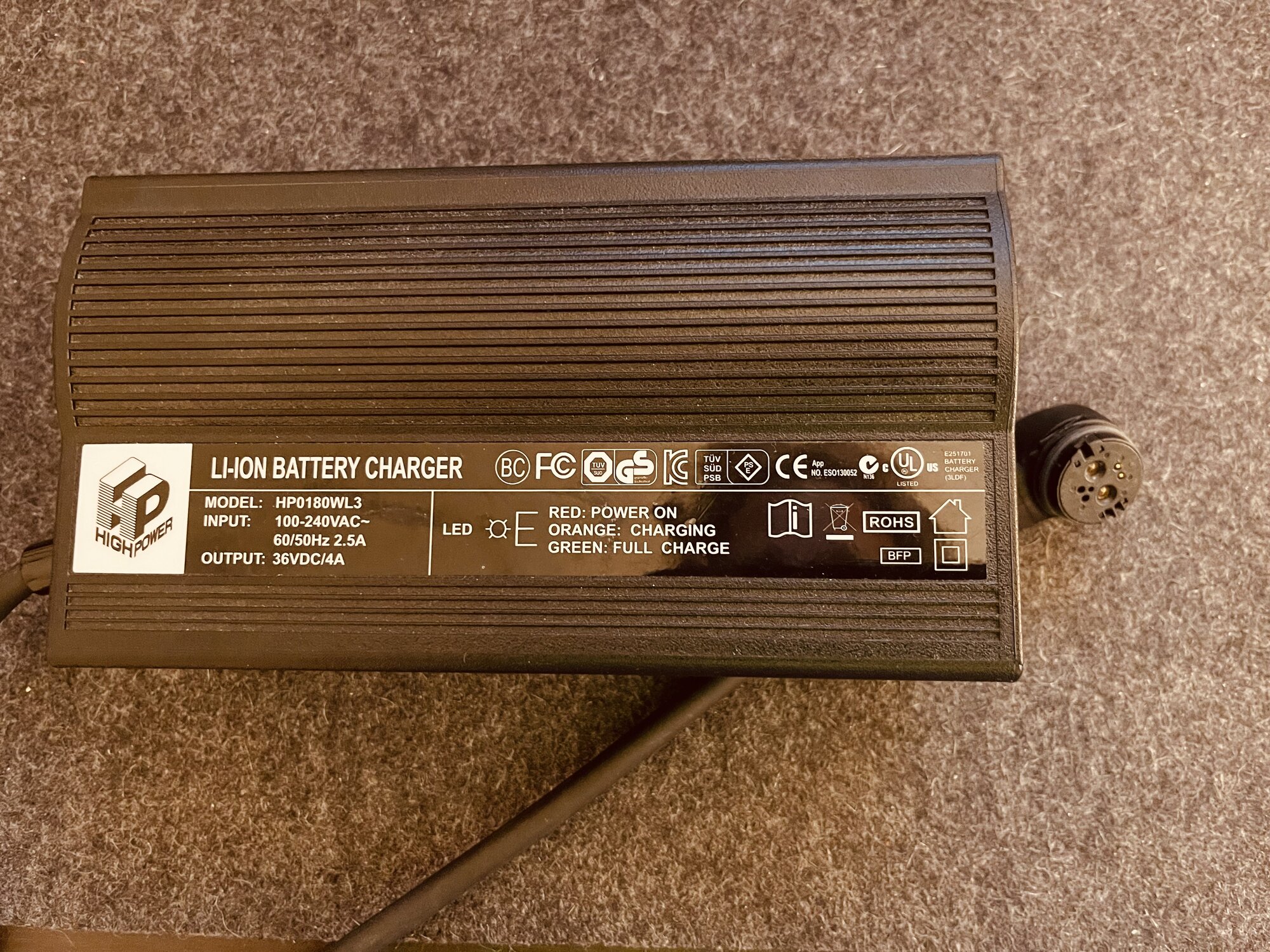

I bought a used bike that the owner said had a dead battery. I connected the battery to the charger and immediately got a green light. The battery measures 10.8V (not good) and the power button on the battery doesn't turn the battery on. I measured the output from the included charger and it measured zero volts. Can anybody else measure the output of their charger for me? Does the charger need to be connected to the battery to generate an output voltage to the battery?

My charger reads zero volts
There is some sort of protocol between the charger and battery to enable charging.

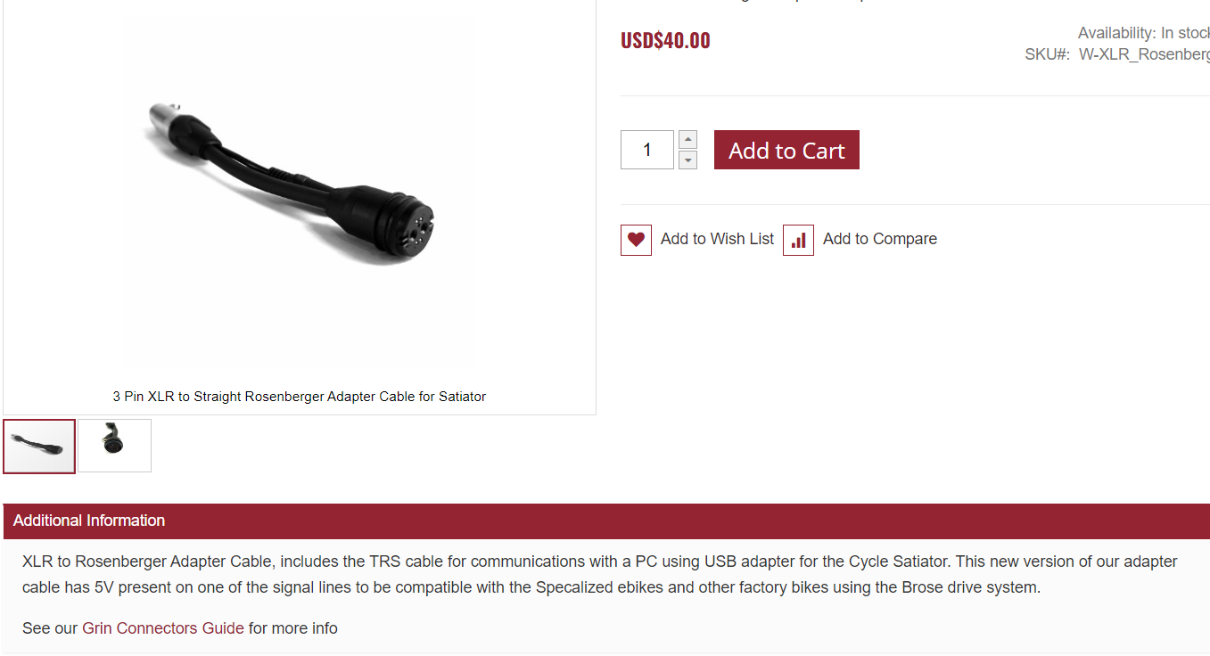

From the grin website

That being said, you cannot measure voltage with a simple multimeter at the charge end(I have confirmed several times now) without something to apply 5v to the data lines as shown for the connector above.
