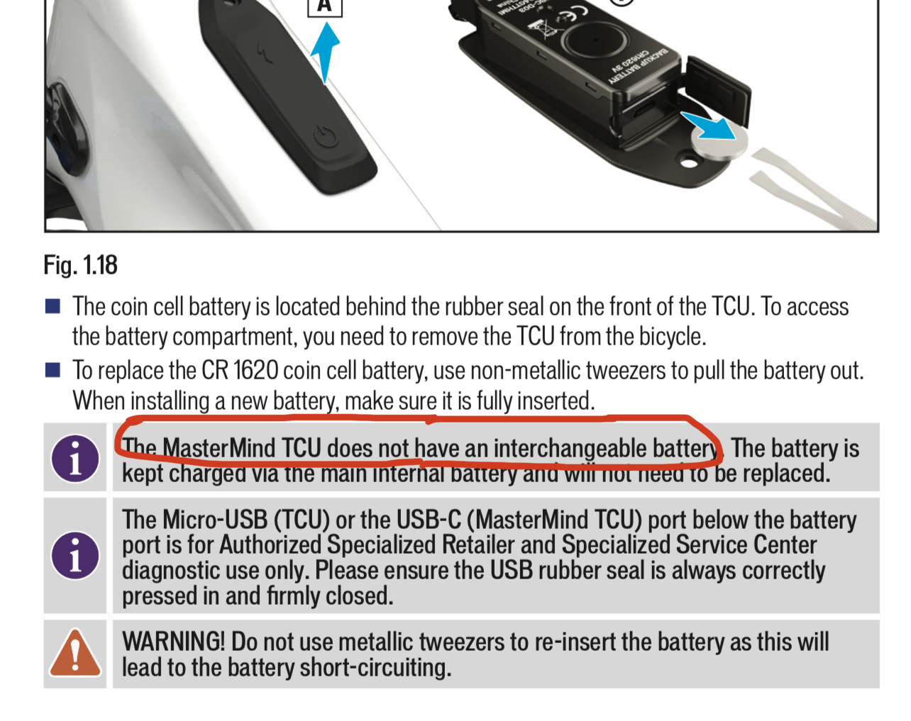

Not on the bike display, but instead this message came up yesterday on my Garmin Edge 1030+ while riding my '22 Vado SL 5.0. It eventually went away but I was wondering exactly what it meant. My main battery had just been charged to 100%, but then I was wondering if it was referring to the TCU battery somehow. Does the Mastermind TCU have a replaceable battery? The manual that came with the bike only discusses the LED-based TCU and was not updated for the Mastermind.
In any case, I doubt that the battery would be that low on a new bike without a warning appearing on the TCU display itself so will consider this message spurious for now.
there’s a separately manual for the mastermind and traditional TCU. it states that the mastermind doesn’t have a replaceable battery!
EXCEPT that no tool or tweezer or anything could get that battery out!!!!!!!!!!!!!!!! When my Creo's power refused to go UP or DOWN or even power off, I thought it might be that battery. I had plastic tweezers, thin Swiss Army tweezers, dental tools. NOPE. I was able to "reboot" the Creo to OFF, by pressing and holding both buttons and then power it on again, I still could not adjust the power up/down. I took the bike to the shop and that's where they discovered the Creo remote buttons were bound too tightly by the bar tape and that fixed the problem. The shop also mentioned that they had trouble removing that dime sized little battery.
So, while there's a battery, it is probably more like the Mastermind unit. It is not replaceable since it is impossible to remove it. :eek:
But I will ask, has anybody managed to remove it? :oops:
That's what I thought. Spurious message then. And while searching the forums, I see that this has happened to other e-bike brands.

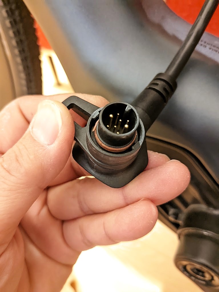

I spotted this message on my Garmin 530 on my ride today and wondered if it could be the RE seal as well as we encountered rain on our ride yesterday. No shutdown issues ever arose and the bike operated in the usual fashion with PAS and neither did I see the red LED show up on the TCD. Both my wife and I had the motors replaced on our MY20 Creos last year and had the dealer perform the necessary firmware updates just a few days ago.
Here’s an image of the seal on my RE cable. It’s definitely been compromised and likely was the result of the critical ebike battery sensor message that showed up on my Garmin HU. The seal on my wife’s RE seems fine.
Just a follow up to my last post. I’ve cleaned out both the area around the seals as well as the charging port with a bit of alcohol. In my case, I believe that grit worked itself inside the mechanism and the result of constant locking/unlocking partially tore the seal(s). Action is much smoother now. I’ve ordered two sets (5pack) of O-rings from my Specialized LBS as they are relatively inexpensive to replace. Part # for anyone who wishes to replace their seals is S209900061

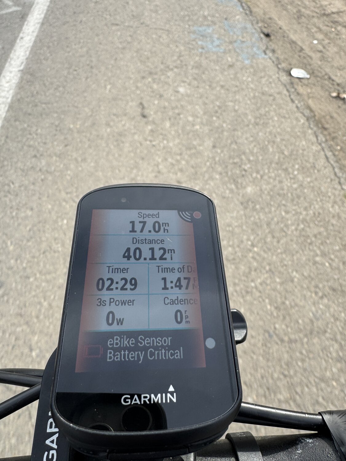

Just got this message for the first time on my 2021 Creo Comp Carbon SL. Didn't seem to affect the ride and I just Ok'd the message for it to go away. Hope it doesn't become a regular thing.
It will come up at time to time, but look at it this way. If the bike has an issue it will tell you on the TCU. Both Garmin and Wahoo give this message, ignore it.
