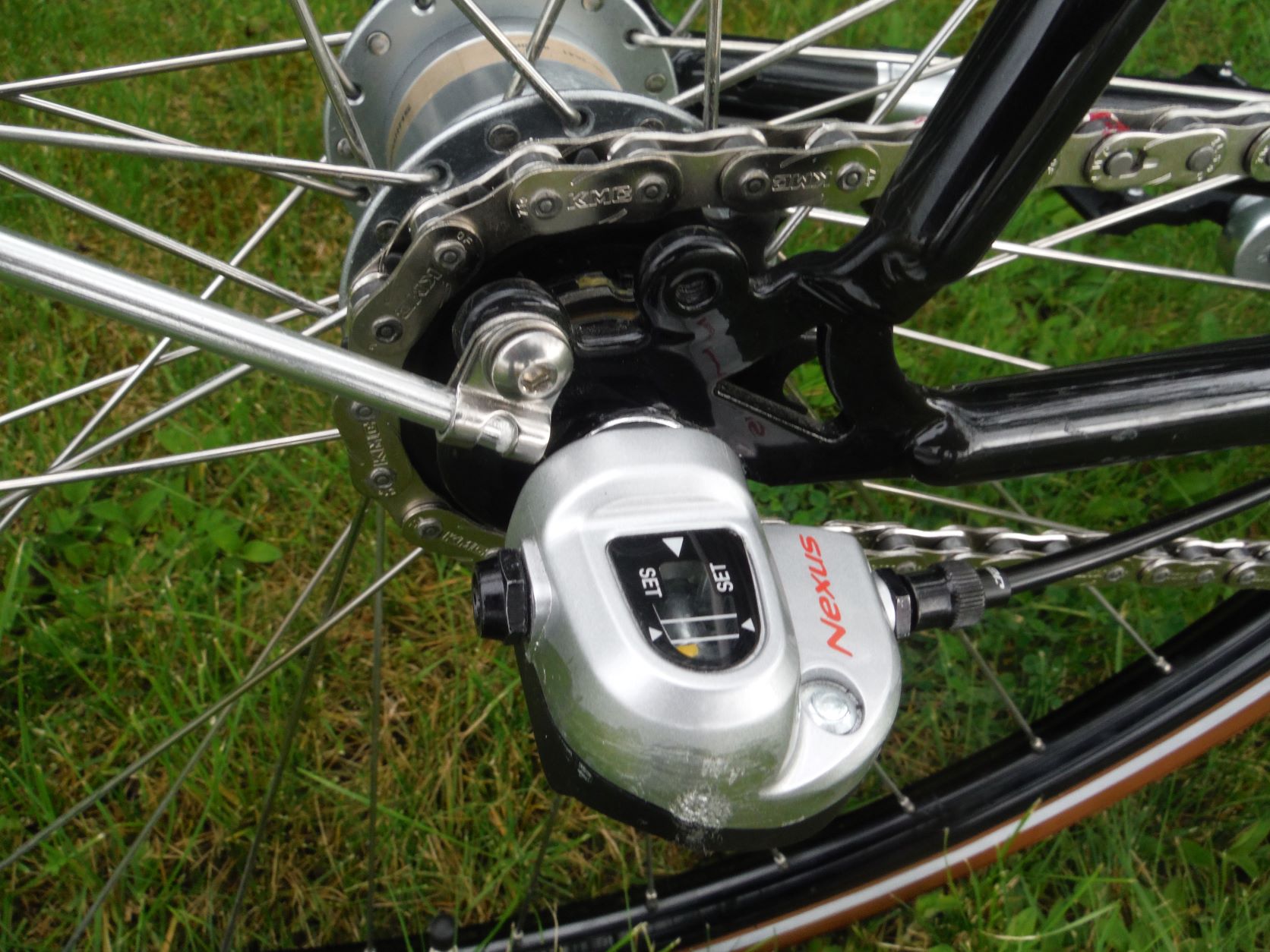

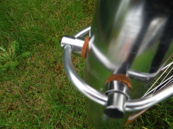

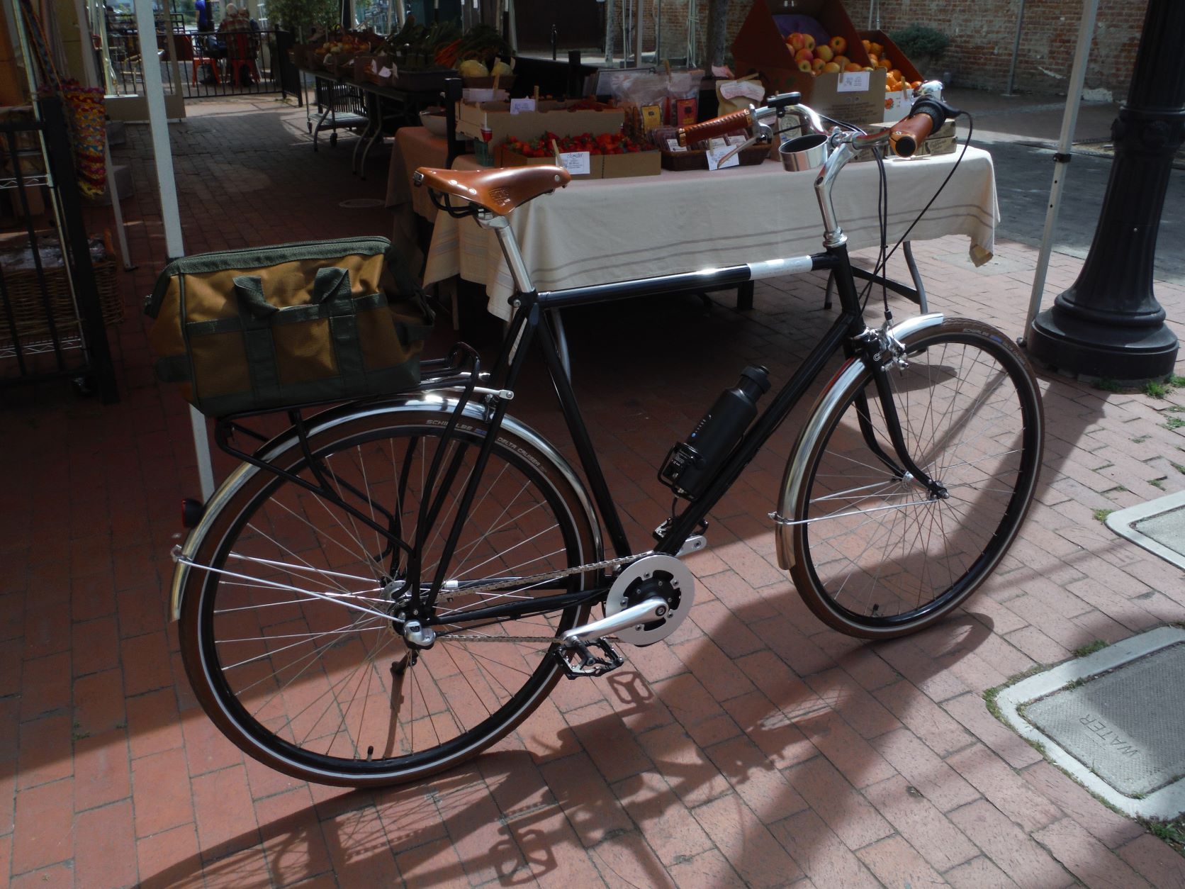

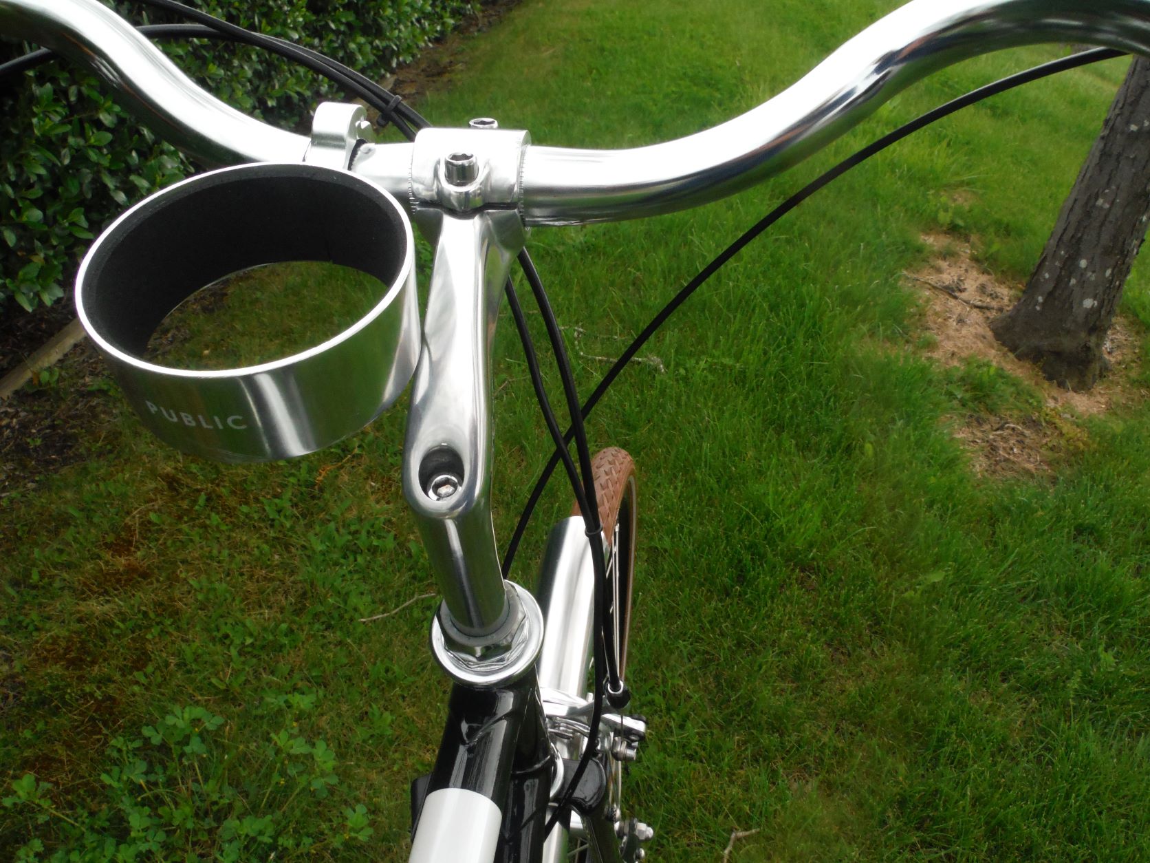

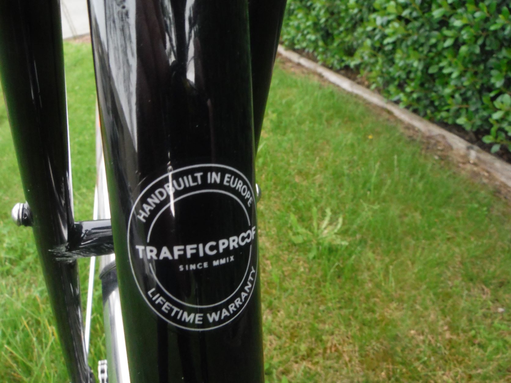

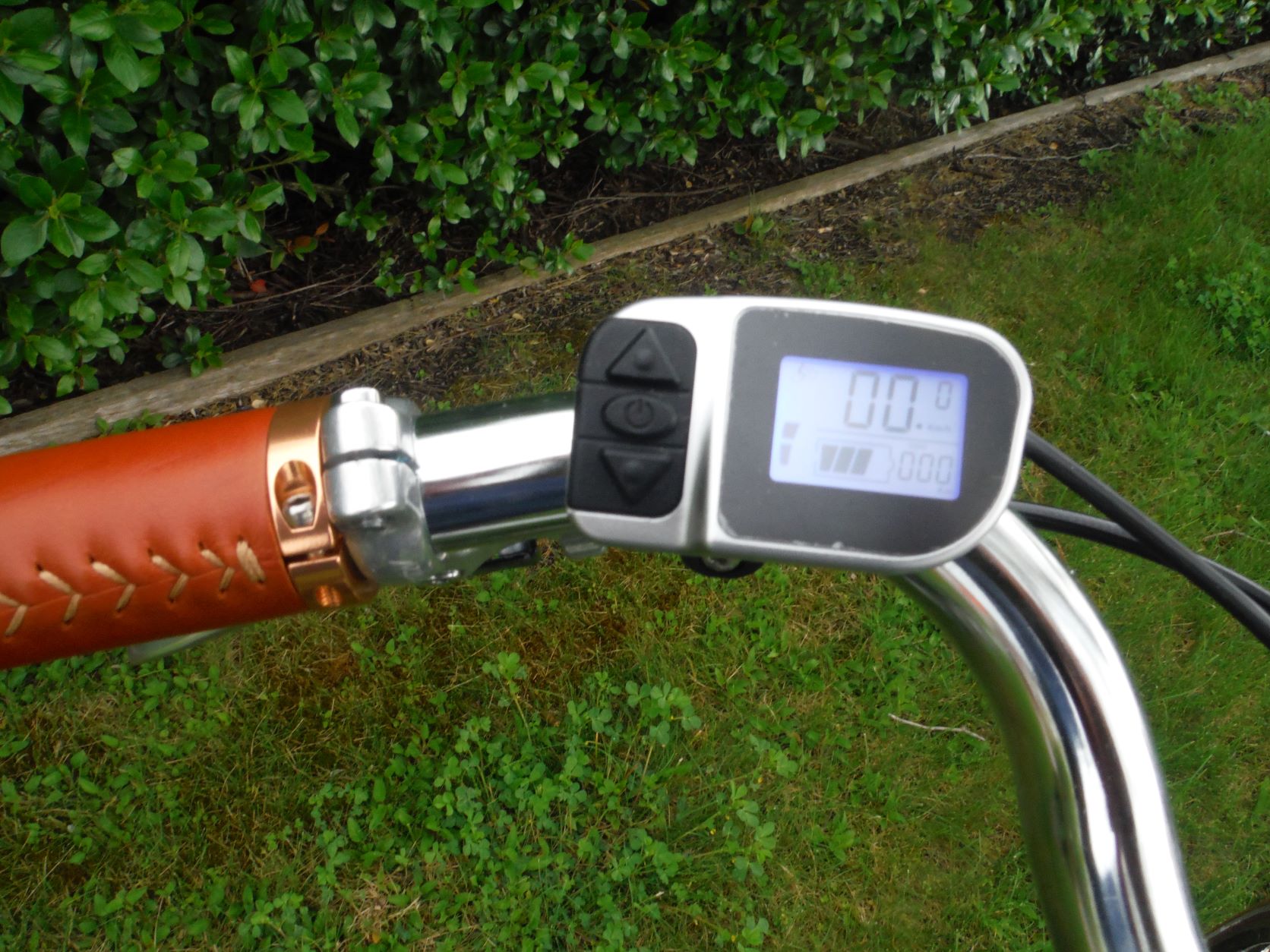

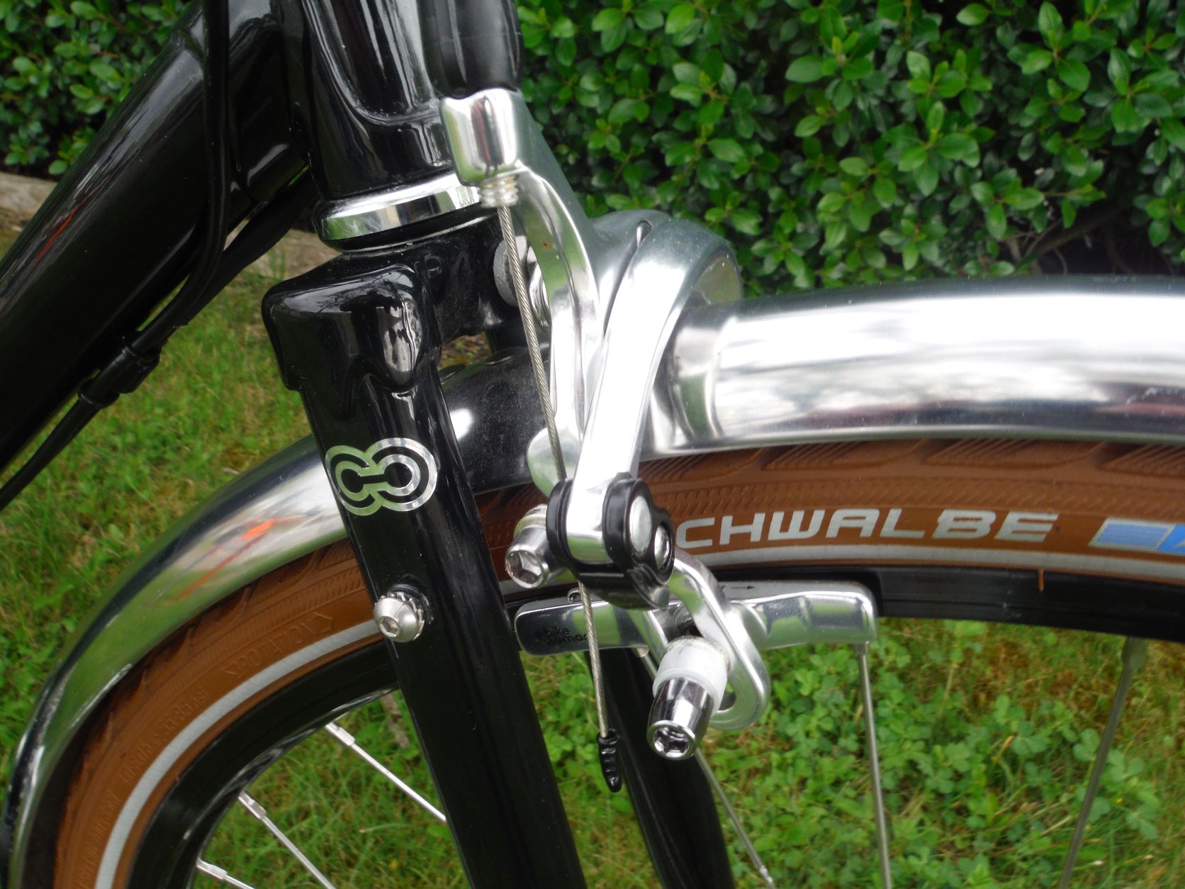

When I make bikes I normally disable this feature. Because it is APITA. Here is one of my unlimited bikes. Matching leather washers were used to hold the fenders. It is sooo much fun to blast past guys in spandex on a bike that does not really look electric. You can see the wire from what appears to be a range extender, if you look closely.

At the hub there is a magnet and a pickup. As the wheel rotates it calculates speed. Metallic crud from the road or chain and cog ware is attracted to the magnet and dirties it. Removing that dirt could potentially fix the bike. I am not a expert on these and last rode one three or four years ago. But I used to sell them and have some idea. I also work on eBikes daily. Good luck. What did you think of the bike I made a mid-drive and posted photos of above?
I'll look at that and also tell the repair guy your advice. Thanks very much. I think your bike is beautiful. I've never seen one with leather trim like that. The attention to detail is outstanding.
Yes, I saw the leather washers. Nice touch!

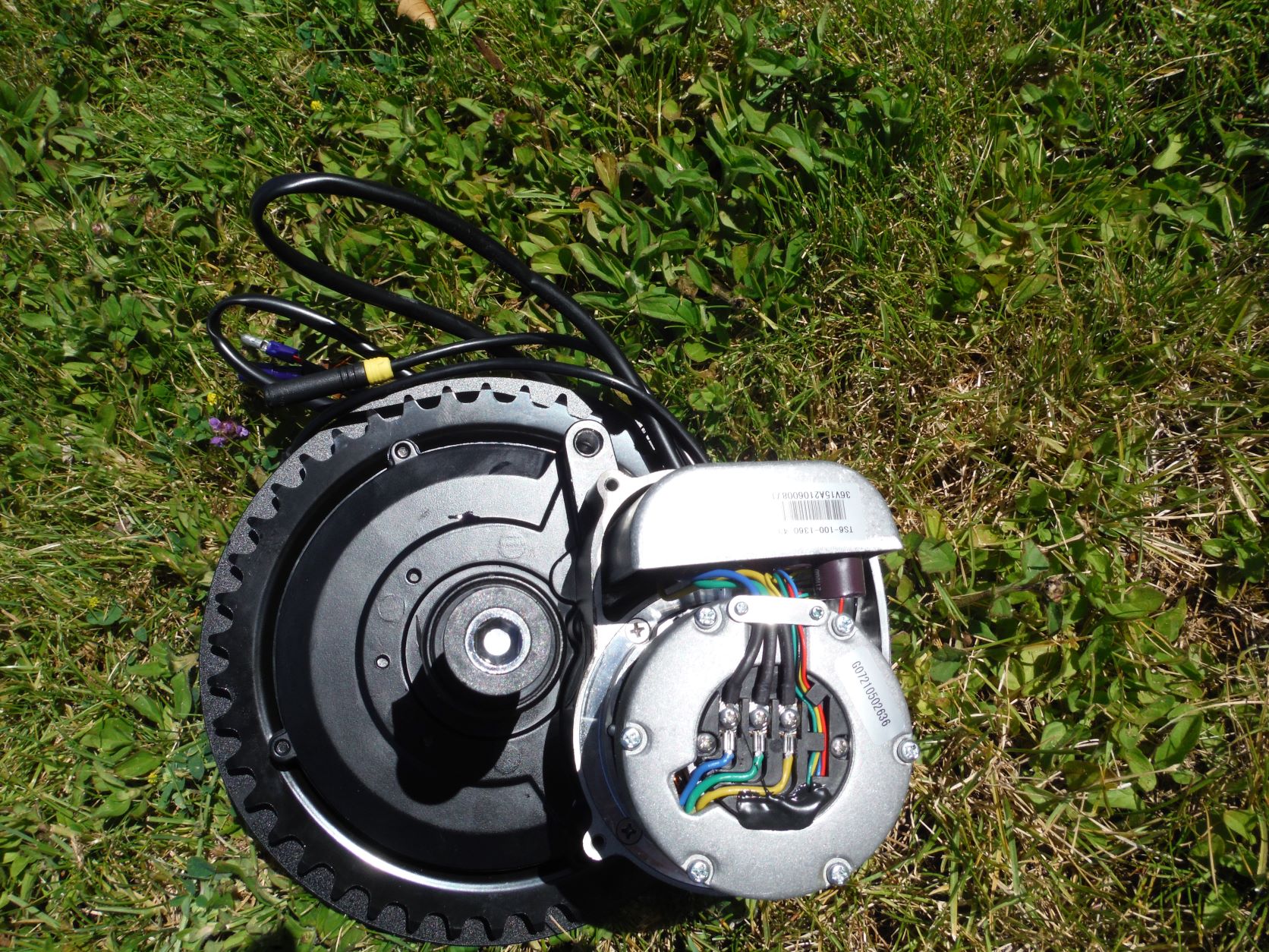

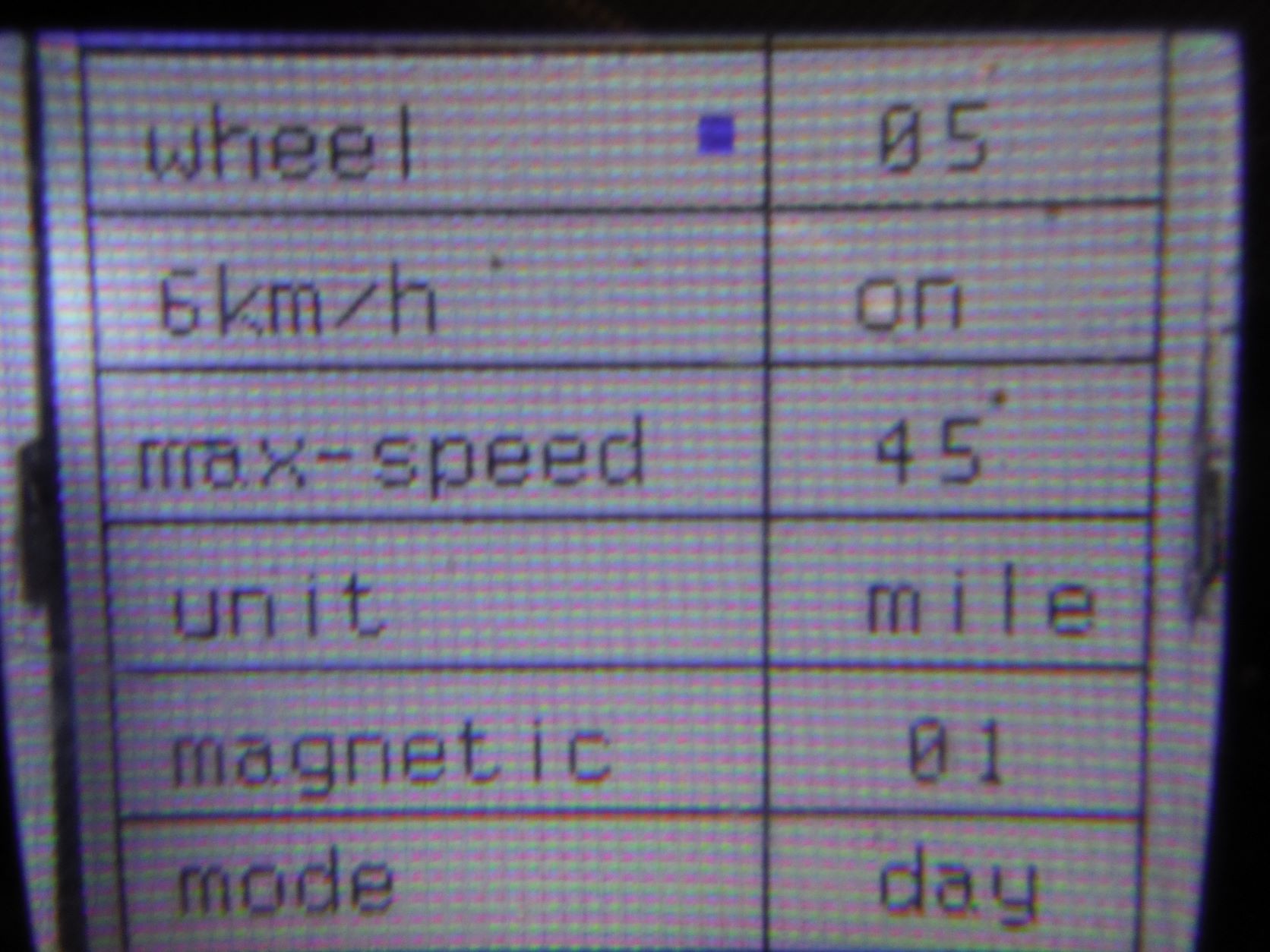

Thanks, @Katy. Hub motors are well known to cut out under high load. Oddly this is the sign of a good motor. It is a failsafe to not burn out the motor. Cheaper ones will melt the internal gears or windings before they cut out. It is what also happens at the speed limit. I remove speed limiters when I use small mid-drives between the pedals. Here is one from last week for a commuter. I set the top speed at 45 with a wheel size of five inches.

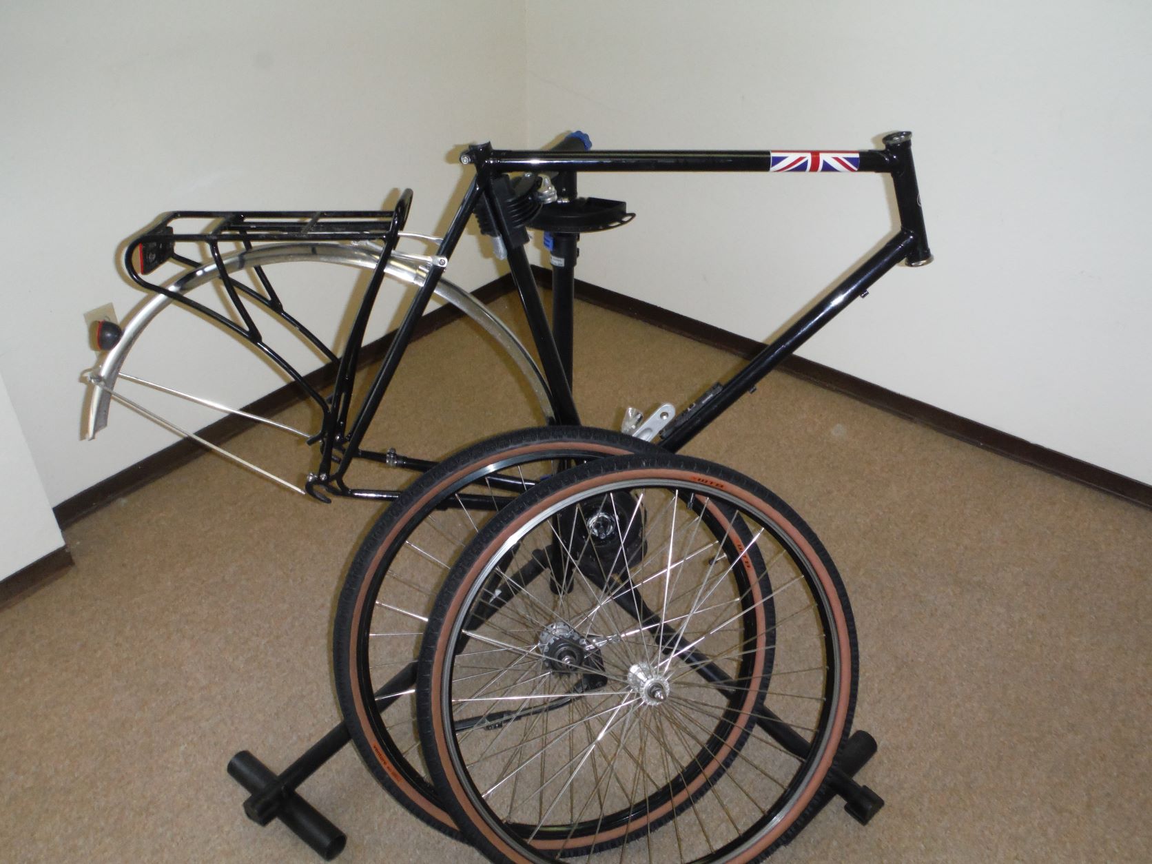

@Katy, I am giving it's older brother a total rebuild and makeover today. It has been ridden hard daily for years. These Crème bikes are only available in North America from BC and Montreal at about $1200 before shipping and not yet electric or with the special custom details. This one is getting all new goodies.
