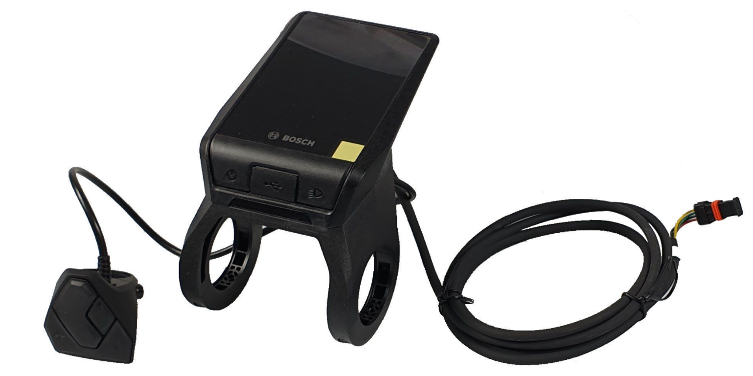

Just wondering if any Kalkhoff owner has done a Kiox to Nyon upgrade (2021 BUI350 Nyon) and if so were there any complications along the way or extra cables required?
If so was the mount supplied with the kit OK?
I have a friend with a 7B Belt that would like to upgrade from the Kiox display.
The main problem would appear to be lack of availability of the Nyon Retrofit Kits.
you don't need new cables. you will just unscrew the ones from the kiox mount and screw them onto the nyon mount. here you go on the Nyon I bought this one and put it on my bulls. its reply easy it just takes a little fiddling with the wires the way they mount. https://www.ebay.com/itm/274783173212
