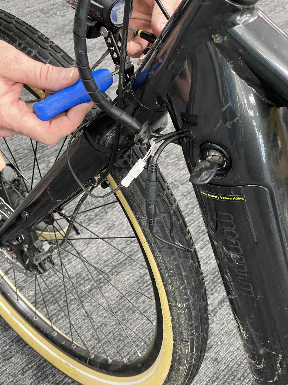

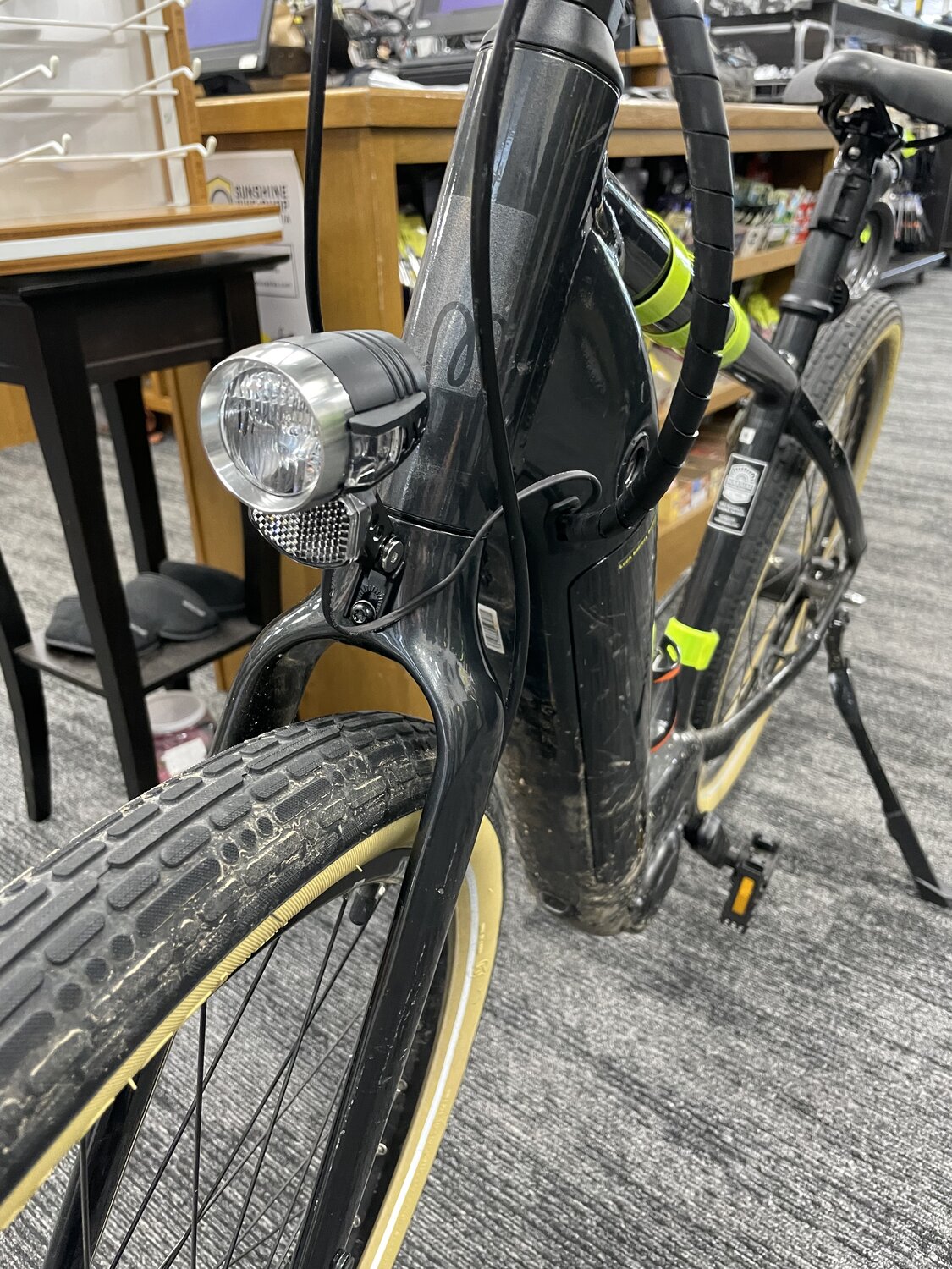

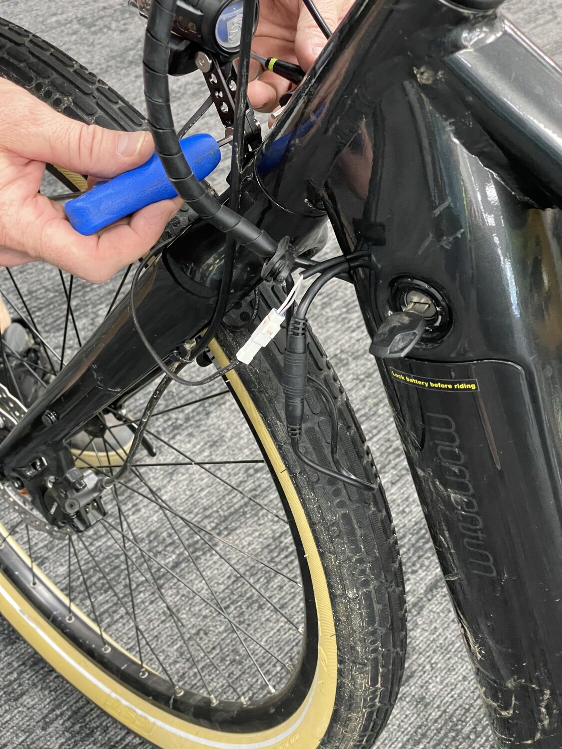

Nice writeup! My local bike shop ordered a AXA Blueline 50 ebike lamp ($63) for my 2020 Momentum Transend E+. I expected to need an appointment for the mechanic to do something like your procedure, but the owner of the shop was able to simply pull the wires out of the side port and the lamp came with the matching quick connect already on it. In 30 minutes he was finished. No charge for the install.
@Wwarren Thanks for sharing! I tried to fish my wire out through the cable hole, but I couldn't locate the wire so I removed the battery lock and found the headlight wire/connector way up against the headset. Nice looking headlight and it sure saves a lot of hassle having the proper connector already installed. Well done!
Having ridden a couple of days with the AXA light, I’m happy with its brightness for evening rides and like that it has side illumination and an attached reflector. I was surprised however when powering the bike on, that the control pad defaults to the light being on. For day riding I have to remember to turn it off. I’m not sure if it’s the light or the control pad doing that.
View attachment 94726View attachment 94727
