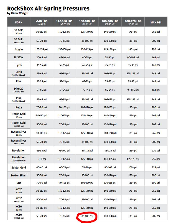

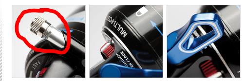

Neo Jumper 650B has Rockshox Xc30 Solo air with 120 mm travel and it is more than enough for trail riding. The right side has a remote lockout lever and left side has a preload adjustment. Open the left side fork cap (has AIR written on it) and use a pump like this to set the preload to 100 or 110 psi (refer the chart attached). You don’t want to make it too stiff or too soft. Start from 100 psi and see what suits you best. Your local shop/REI will have one of these pumps.

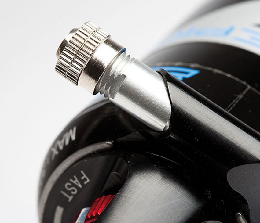

Open the metallic cap shown in red and pump the preload pressure upto 150 psi. The rear shock should have minimal sag (~10%) when you are completely seated and not moving. This specific model can take upto 300 PSI but if you do then you’ll blow the O-ring so better not to cross 180 or 200 psi. The protrusion on the metallic cap can be used to release air if you think it is too stiff. First when I received the bike, I didn't check the pressure and it was too soft and after pumping it to 150 psi, I find it provides optimal dampening and stiffness.

The multi-position valve is used to adjust response for different terrains. I normally keep the valve fast response.
