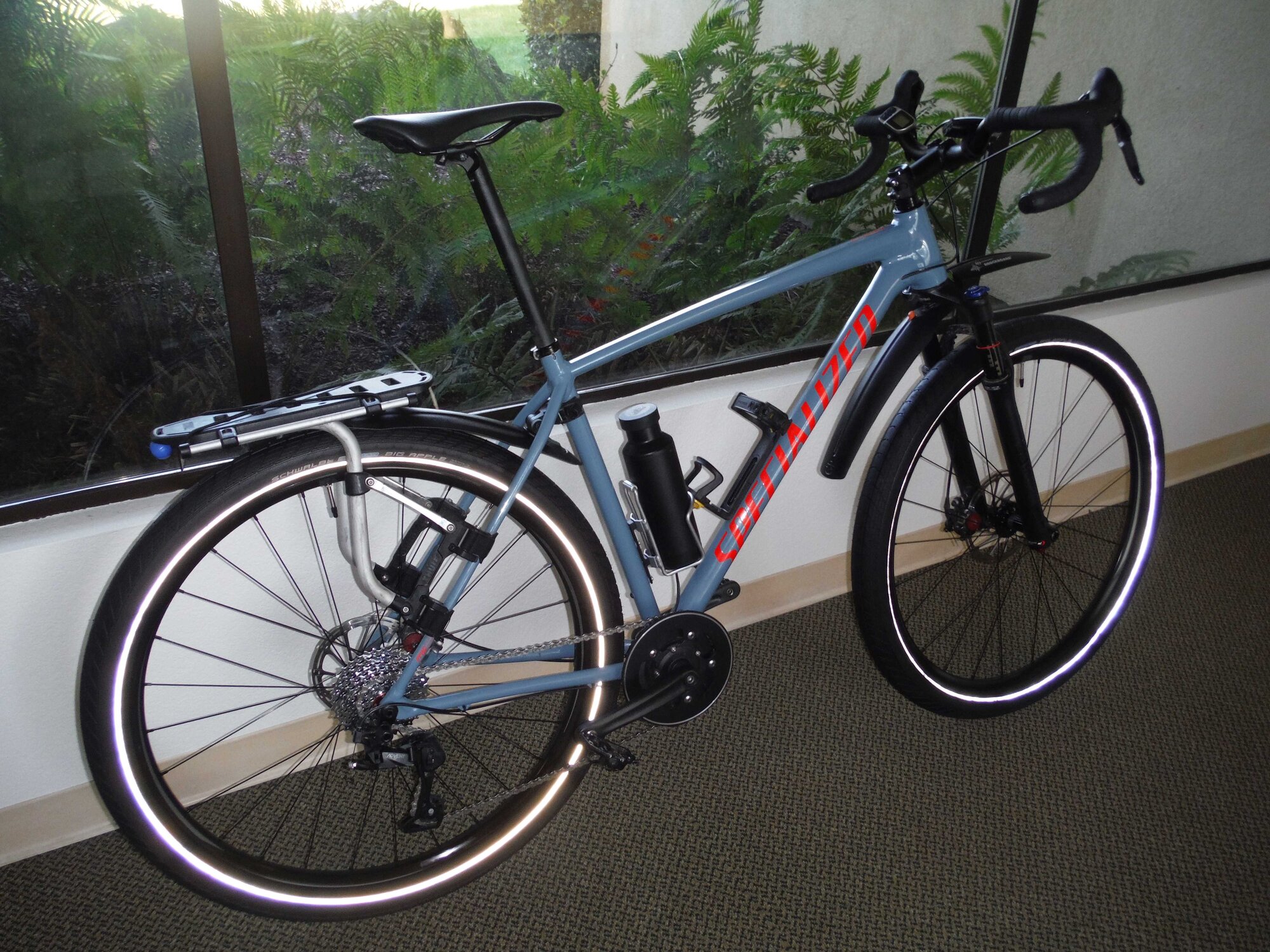

Sell it fast and take the hit like a man, calling it the high price of tuition. In my opinion @duggie, a small, lightweight mid-drive with a moderately low bleed out rate and moderately high torque with a throttle on a light gravel bike is what you need. The bleed out rate is Watts. Beginners think that a high number is better. With a lower rate of bleed out you can use a smaller, lighter battery and go farther. A mid-drive will power through the gears so it will be far more efficient. And be a better climber. I do very large hills and mountains in the region of California where the mountain bike was invented and perfected. Heavy bikes don't cut it on those trails. Here is one of my bikes. It is 350Watts with 85Nm. I have found that more than 90Nm leads to drivetrain problems. This bike normally uses a three pound, 1.3Kg battery. It also uses adult sized wheels.
