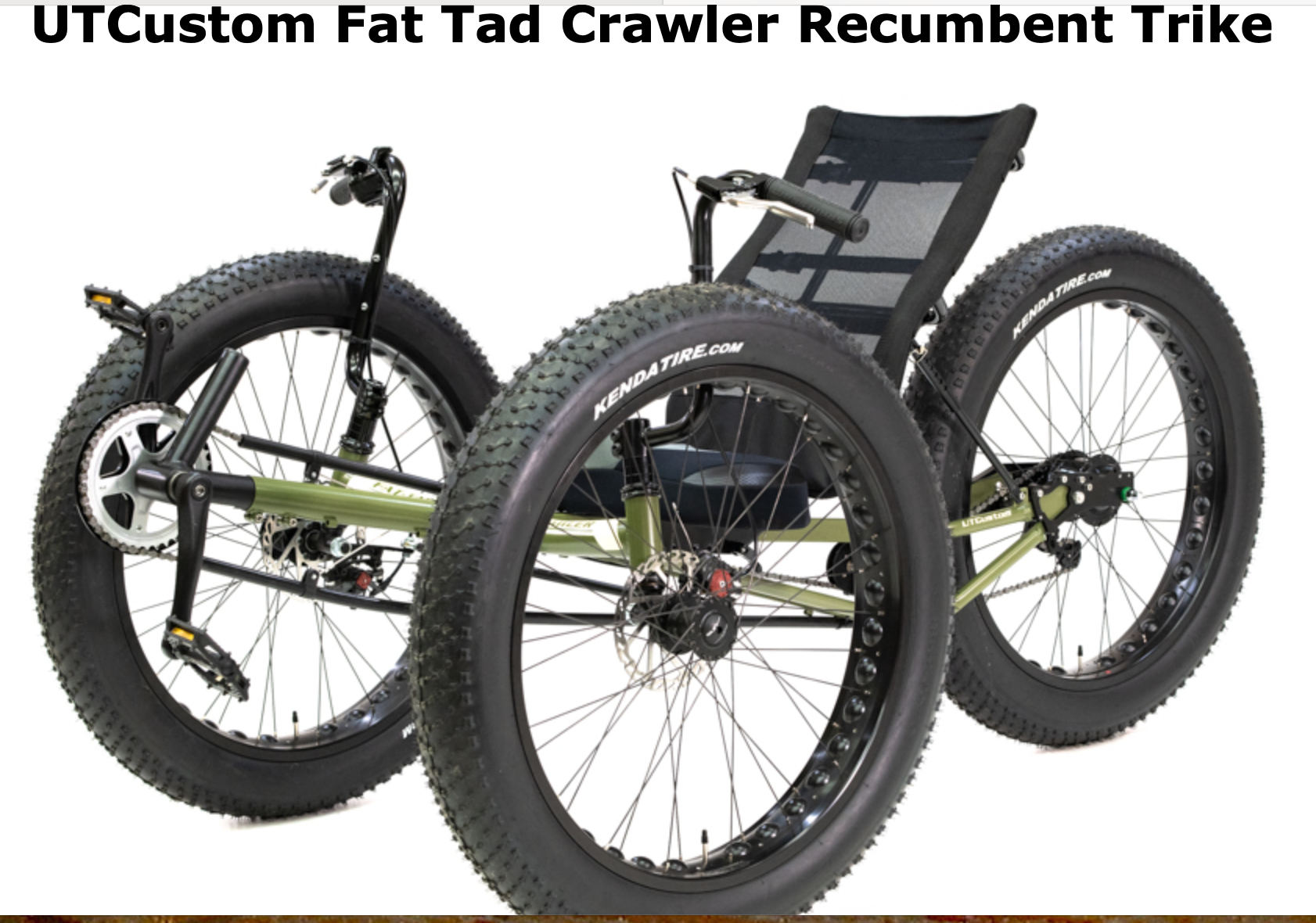

Nah.
After 12 years and more than a dozen personal builds, I probably have enough parts and motors to achieve that.
But, as the Cruzian says, "Nuttin tall be so."
