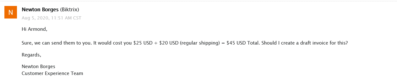

I took your advice and contacted support about the inserts and olives. This is the reply I got back from Biktrix. Do those costs sound right to you for 10 inserts and 10 olives ??
On one of the questions pages someone asked what size tube and what type insert / olive. Someone answered back saying the XOD brakes used 5mm tubing and Hayes insert/olive. I agree with the 5mm hose but not so much on the Hayes insert/olive. After checking their website I could not find a similar brake as the XOD. Also none of the brake pads for Hayes would work on the XOD brakes. If anything I would imagine the insert/ olive would be the same as Shimano. Can anyone here confirm which insert/ olive the XOD Hydraulic brakes would use ? Thanks to all who have answered so far, doing their best to help me out.
No good deed goes unpunished.
Shipping from Canada is always high. Typically my minimum is $20. Is $25 too much if no one else can point to, or supply the correct parts?
