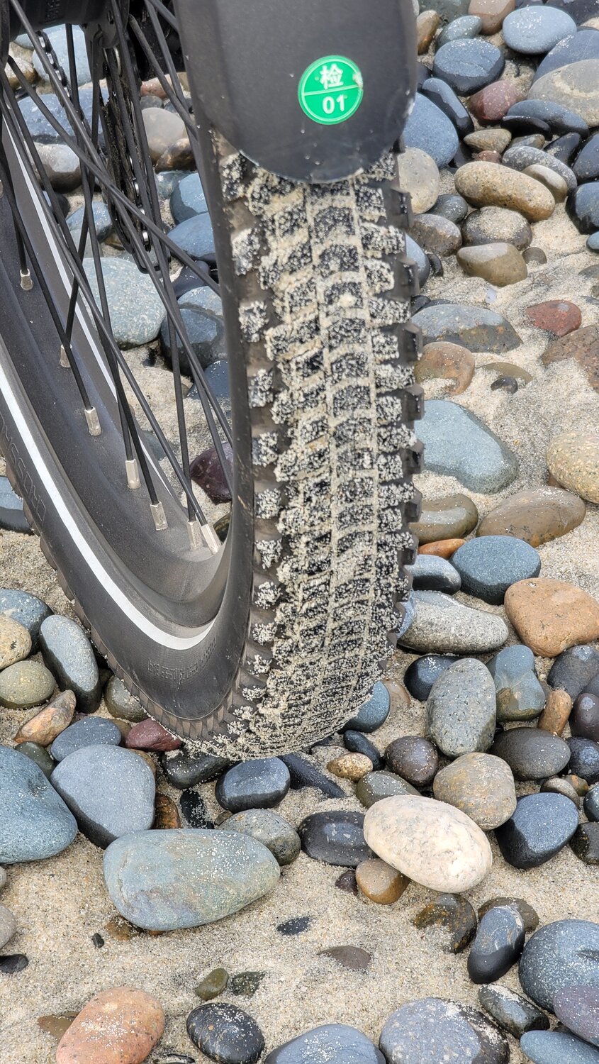

I just got a XP Lite that came with knobby 36PSI 2.6" tires. They provide great shock absorption but are too slow for using around town. I'd like to get something with a bit lower rolling resistance and a bit higher pressure for better speed and range.

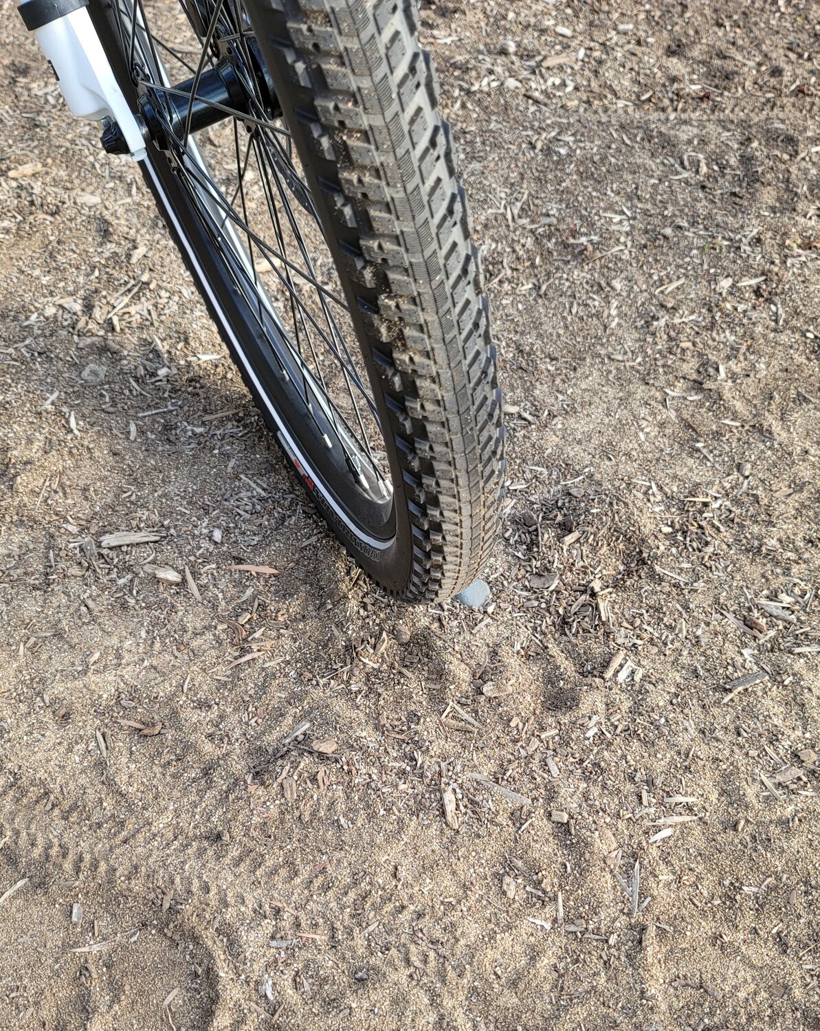

I'm no expert, but I like my 2.3" Specialized Crossroads Armadillo hybrids. The "Armadillo" part signifies Specialized's highest level of puncture resistance. They have smooth center treads for pavement and side lugs for softer surfaces. The tire track at lower left shows how the side lugs engage with a little sinkage.
At 2.3", they're wide enough for damp beach sand but not dry. Rated for 20-50 psi, so I run them at 35. Rolling resistance on pavement is low enough to ride the flats without assist.

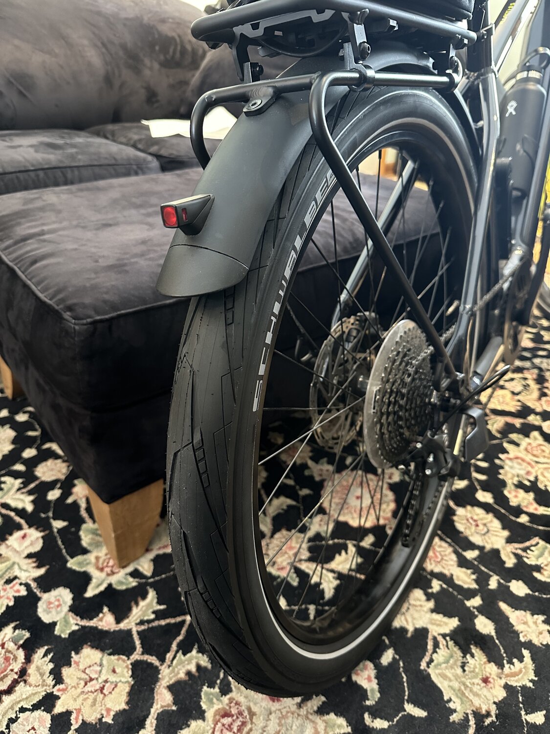

I’m on my third set of tires in 10 months for my Allant+ 8S. The original stock tires, while very smooth on the road were a nightmare on anything slightly slippery (grass, gravel, etc). At about 700 miles, I replaced them with Super Moto X’s. While infinitely better on the slippery stuff, they had noticeably increased rolling resistance on smooth dry pavement. Those were on the bike for only about a week. I then went to Super Moto’s. Ah, heaven… I’ve put about 200 miles on the Super Moto’s so far and they are even smoother on pavement than the stock tires and as good as or slightly better than the X’s on the loose stuff. Highly recommended!

For the past 20 years I have only ridden Schwalbe tires. Always very happy with their performance and value.

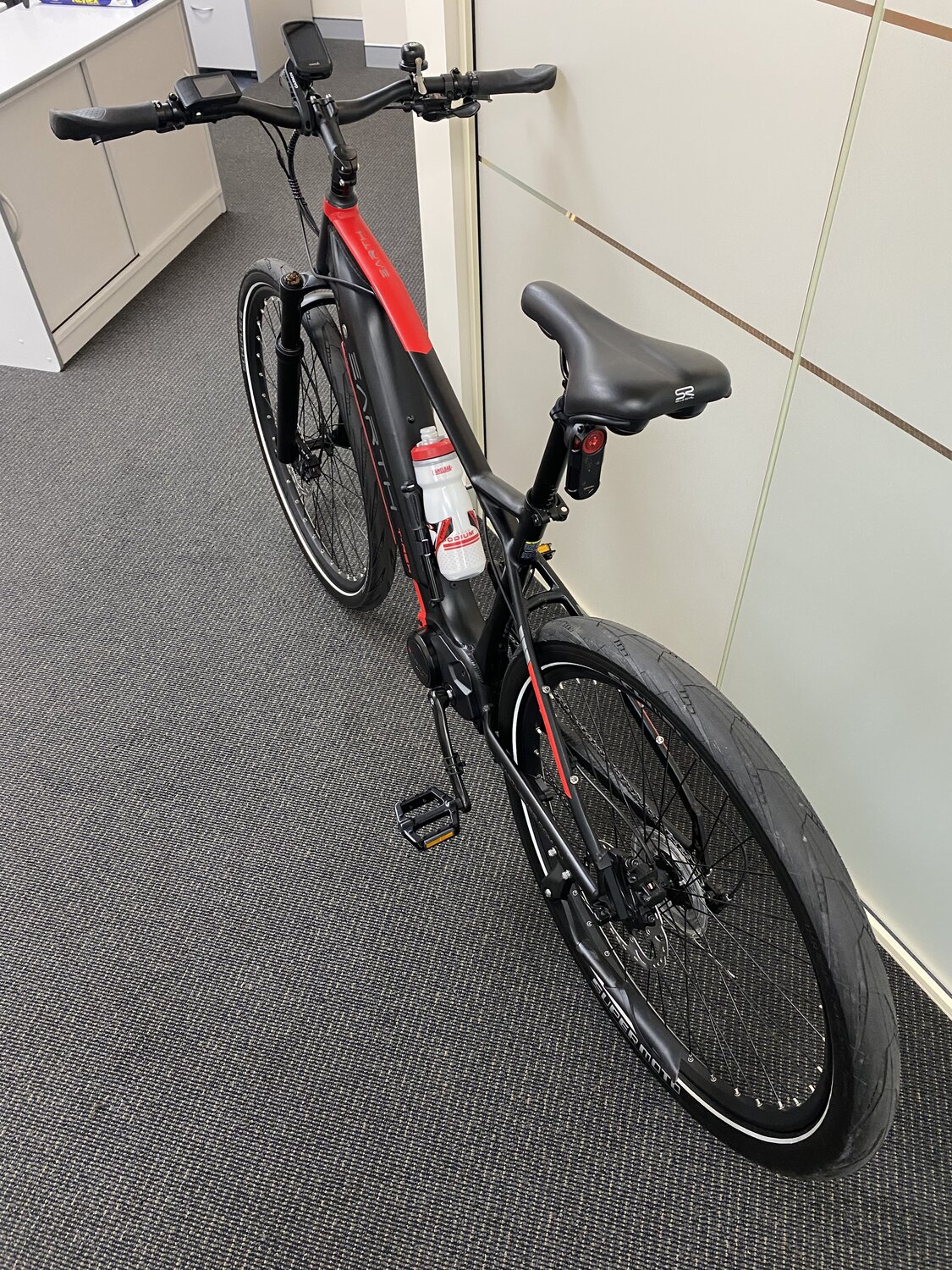

I feel the Super Moto's (NON X) are the best tires for a commuter e-bike. Fantastic on pavement, good on loose gravel, sand and grass - everything I run into and over on my rides.
I have to agree and I’ve had mine for about one year now commuting to and from work each day.
In fact the bike shop I bought my ebike from has retro fitted them to all the same model e-bikes they have sold after trialling mine. They owners love them for their smoothness and comfort, and report greater battery range as expected.
