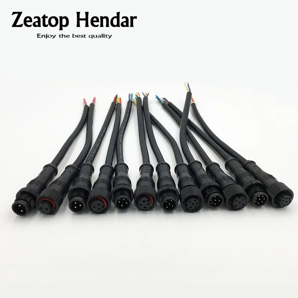

That looks like a Higo or Julet connector. I have them on my bike as well.
I haven't had much luck finding exact replacements so I buy these for making wiring changes:
I cut the cable to length and splice the male and female ends into the wiring harness. I use solder and shrink wrap to make the connections.
Yes, those are Higo/Julet, 6zfshdb, but the OP has the bigger ones. Nice find. What makes the OP's connectors bigger is the hex nut that goes around the connector for a mechanical lock,
