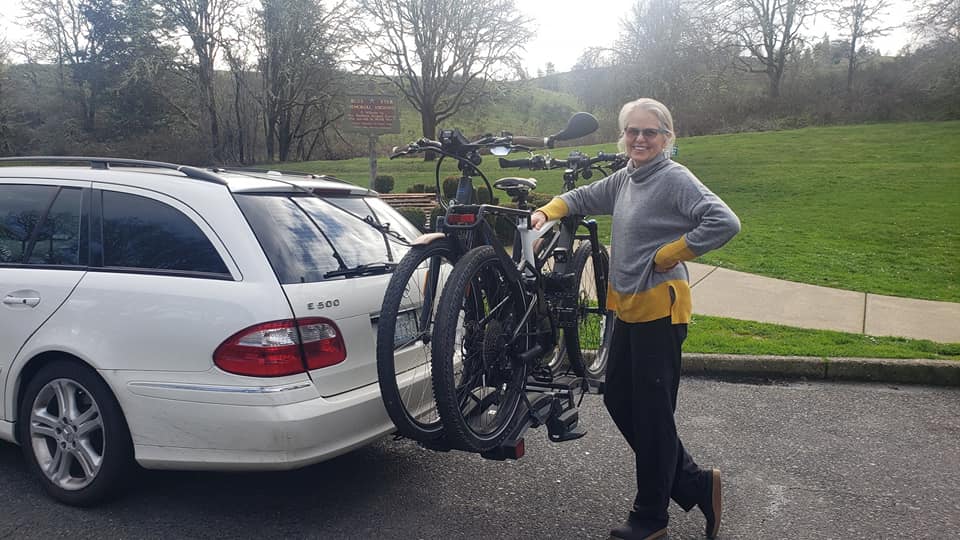

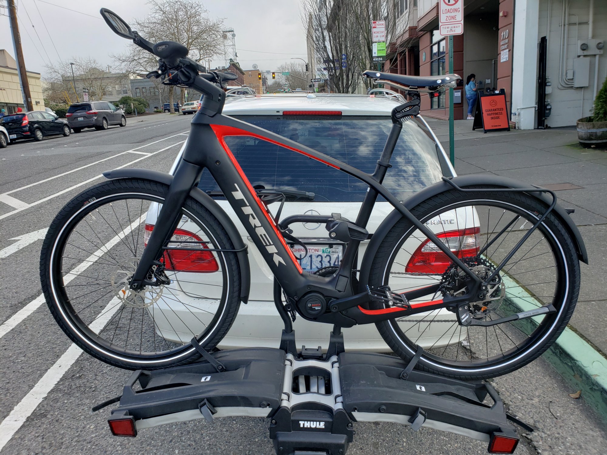

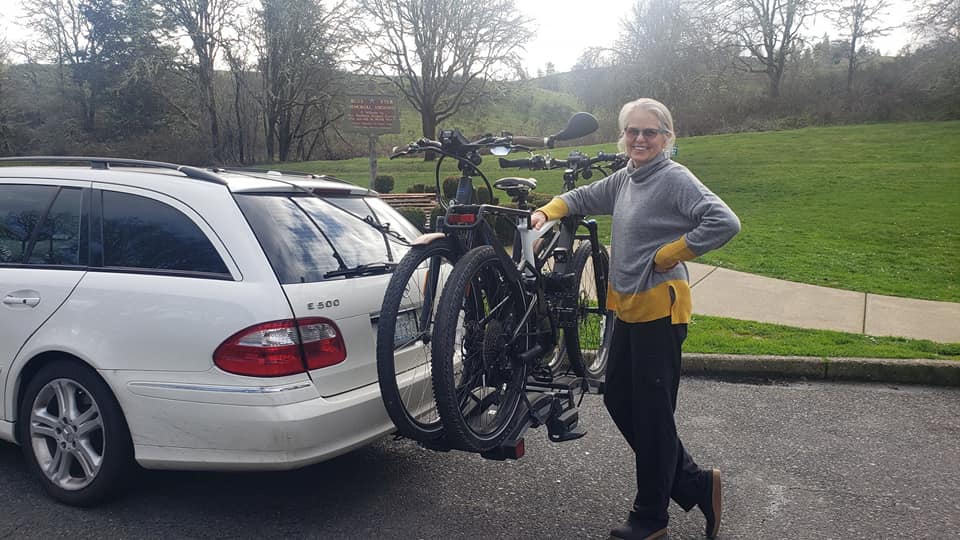

I use the Thule easyfold but it holds two bikes with a weight limit of 60kg. The nice thing about it is that it clamps on to the frame and they make a nice frame brace/protector to safely clamp onto carbon fiber. It folds up into a size that fits in a small trunk easily. Here is a picture of mine with my new Allant 9.9s The frame clamp is on the lower seat tube. You can see the lock on the tightening knob. You tighten it till it clicks and slips and locks by disengaging the knob so it spins without loosening. The Easy Fold xt 2 is expensive but very well built and quite secure.
It comes with a folding ramp that clicks into the platform and is visible sitting in the middle section.

We have had two SuperCommuters (55 lbs) on our Thule Pro XT2 It held the bikes from NJ to Arizona, and several times from NJ to FL. No issues on holding the bikes. Only issue is that you have to lift them to put them on the rack. Some of the racks where you can roll on might be easier as Alaskan has pointed out. We are still on the younger side, and are fine lifting them. We now have a SuperCommuter and an Allant 9.9S
